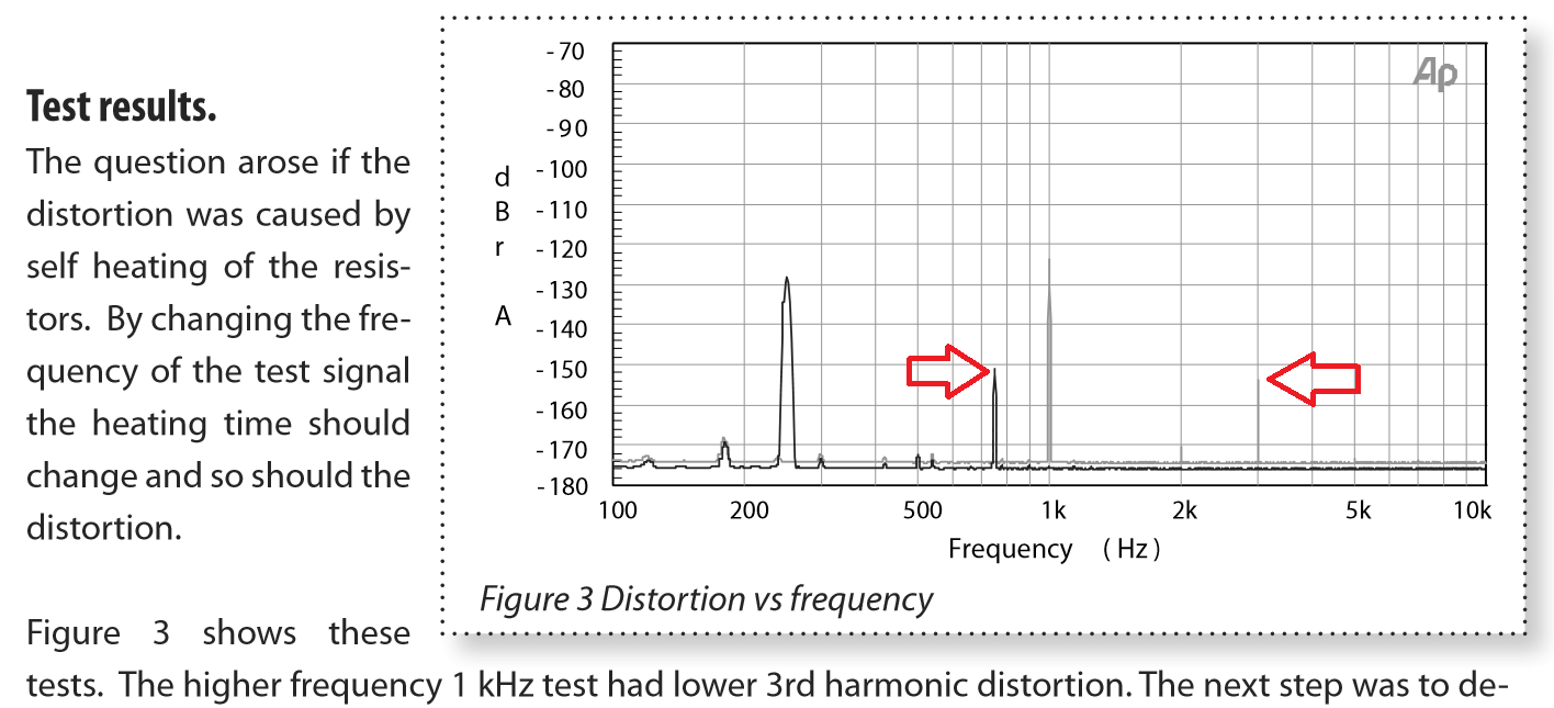

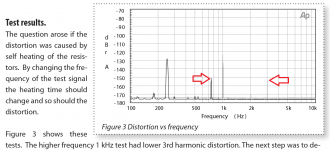

Not that complex. I referred to Ed Simon's measurements (see also his article, attached) that compare distortions of various resistors.
I assume you are referring to the attach graph where there appears to be a 2 or 3 dB difference in HM3 for a 4x change in frequency? (I wonder if a 4x change in frequency should correspond to a larger difference?)
It says:
Any idea of the brand and series used for the test?Ten inexpensive ¼
watt metal film 1% resistors were used.
Were any other multiple frequency tests done? (On the other resistor types?)
It says:

The Dale MF 25PPM RN65E in post #194 appear to show a much greater difference (perhaps 10 dB)?
The "Naked" Vishay perhaps 4 dB.
So the unnamed "inexpensive" resistors seem to have the least temperature modulation (2-3 dB, but higher distortion).
Do you recall what series/brand the "inexpensive" resistors were?
I wonder if the apparent difference between these measurements and the theoretically expected thermal modulation is due to the time constants. (Or more specifically the wrong/inappropriate time constants.)Ten inexpensive ¼ watt metal film 1% resistors were used.
Perhaps the time constants that are provided are related to heating the entire resistor body (ceramic core) and perhaps they are geared towards reliability.
For thermal modulation induced distortion perhaps it is necessary to look at how quickly the thin metal film on the surface of the ceramic heats up, not the whole body. Perhaps analogous to how long it takes the active transistor site in the die to heat as opposed the heatsink reaching a steady state. (And perhaps related to the reason for the ON ThermalTrak devices and the Sanken SAP15N/SAP15P.)

-150 dBc with about 8 volts applied seems pretty reasonable for Yaego/economical 1/4W 1% metal film. (8 volts across the single R, 16 volts total.)
