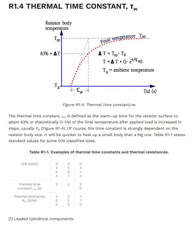

The time constants I found were 2, 5 and 20 seconds and appear to correspond to 0.4W, 0.6W and 1W. However I am not sure which brand or series they refer to. The attached first image has the time constants I found and the DIN size. The second attachment is for high reliability Vishay resistors which are the same DIN size code. If someone has better data please post.

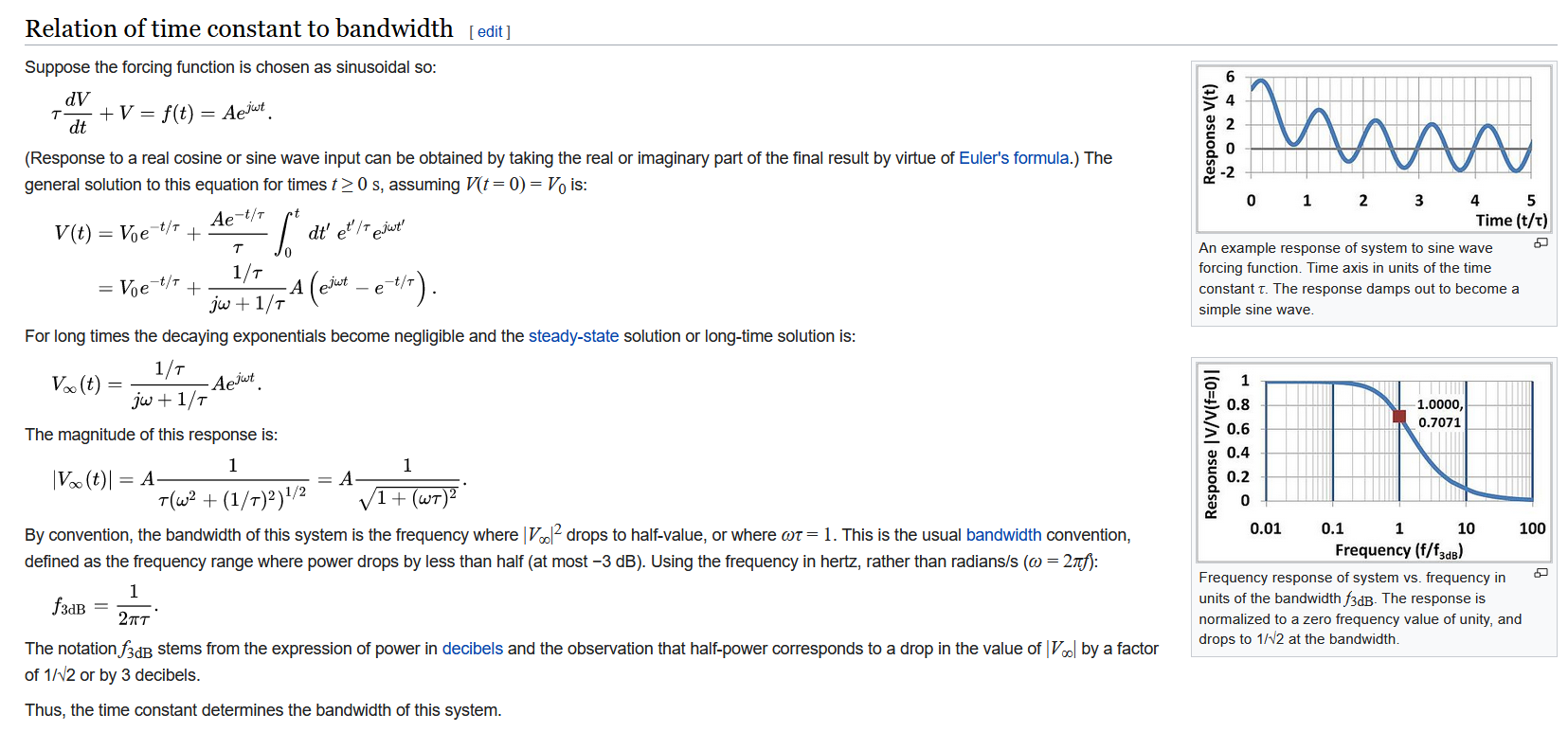

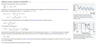

Any chance that 1/Sqrt[1+(wt)^2] would be the correct factor to attenuate the 0.05% for periods (frequencies) much shorter than the 2 to 20 second thermal time constants for leaded resistors? (Assuming that those time constants are correct.)

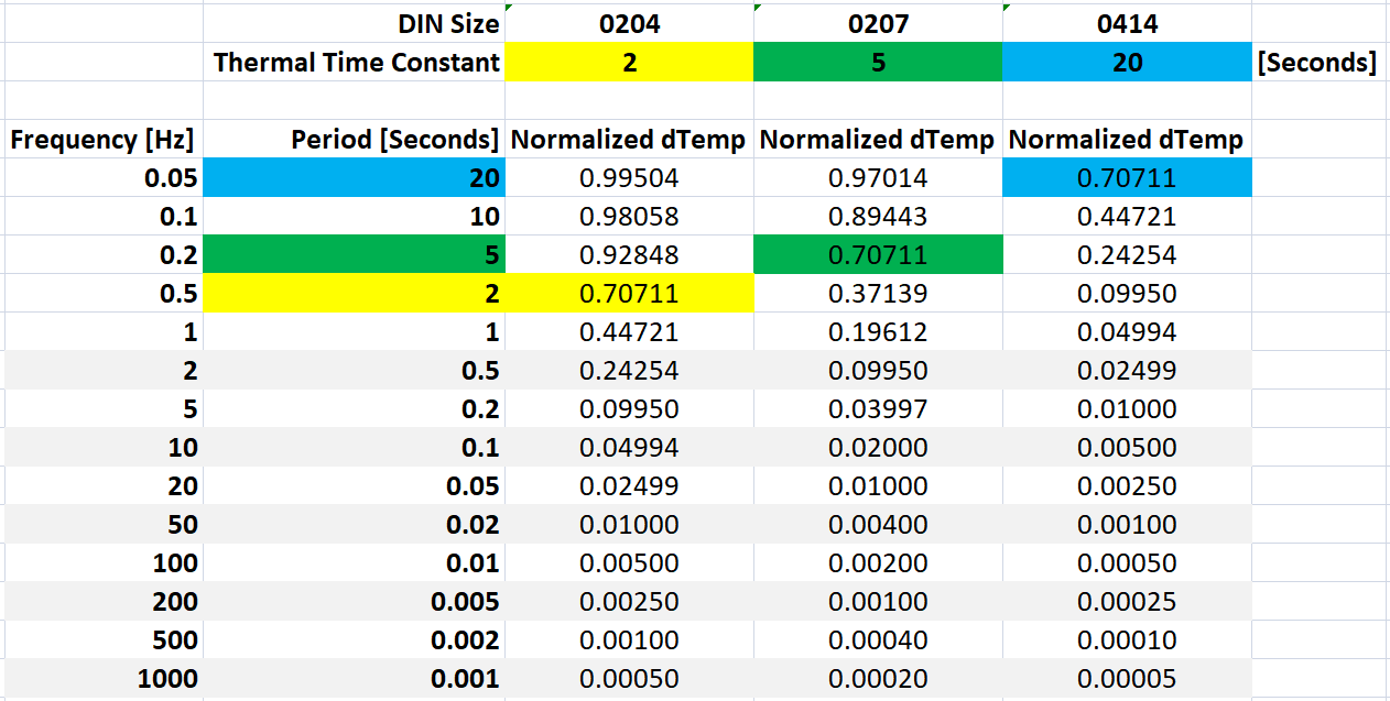

Using the previously posted formula (for a first-order, linear time-invariant system) I made the attached chart for the 2, 5 and 20 second thermal time constants that I found online for leaded resistors in three DIN sizes. I don't know if the time constants correspond to the attached Vishay resistor series or a different brand/series of those three DIN sizes. The Vishay resistors are rated 0.4W, 0.6W and 1W for the three DIN sizes.
If anyone knows of an error in either the application of that formula or the thermal time constants please post a correction and an explanation.
From these calculations would it be correct to say that there should be very large reductions in thermally induced resistance change and distortion ["thermal modulation"] due to the very large difference between the (short) periods of audio frequencies and the (long) periods of the thermal time constants?
