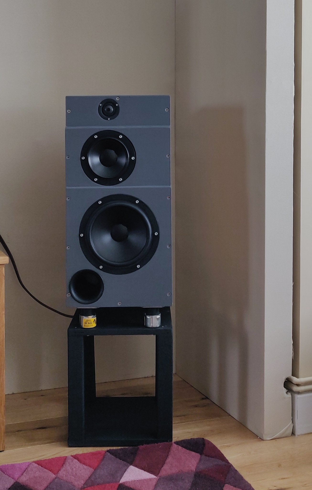

Bit of an update... I've have overlayed the midrange, most the tweeter, and two sides of the bass compartment with 15mm wool fabric.
Only briefly listened, but the sound may be a bit more detailed, but the speaker does sound a bit less edgy on the top end that I found aggravating.
Also made new stands and give the speakers a new paint job. Not great but better than what it was.
I still long for bass I can feel as well as hear, but I've given up on the subwoofers, they just won't work with my room layout. I almost bought a pair of Harbeth 40.2... I've always liked their speakers but I wasn't 100% convinced they would be much better than what I got.

Another thing I did do, was silicon around the speaker port. It was friction fitted, but was a bit loose.
Listening this evening the speakers sound a lot better. I always thought they could be a bit bright / shouty but that has gone away, they sound dry/ neutral with the bass having more punch than before.
I wish i did these adjustment 7 years ago! I final feel I'm getting the best out of the speakers.

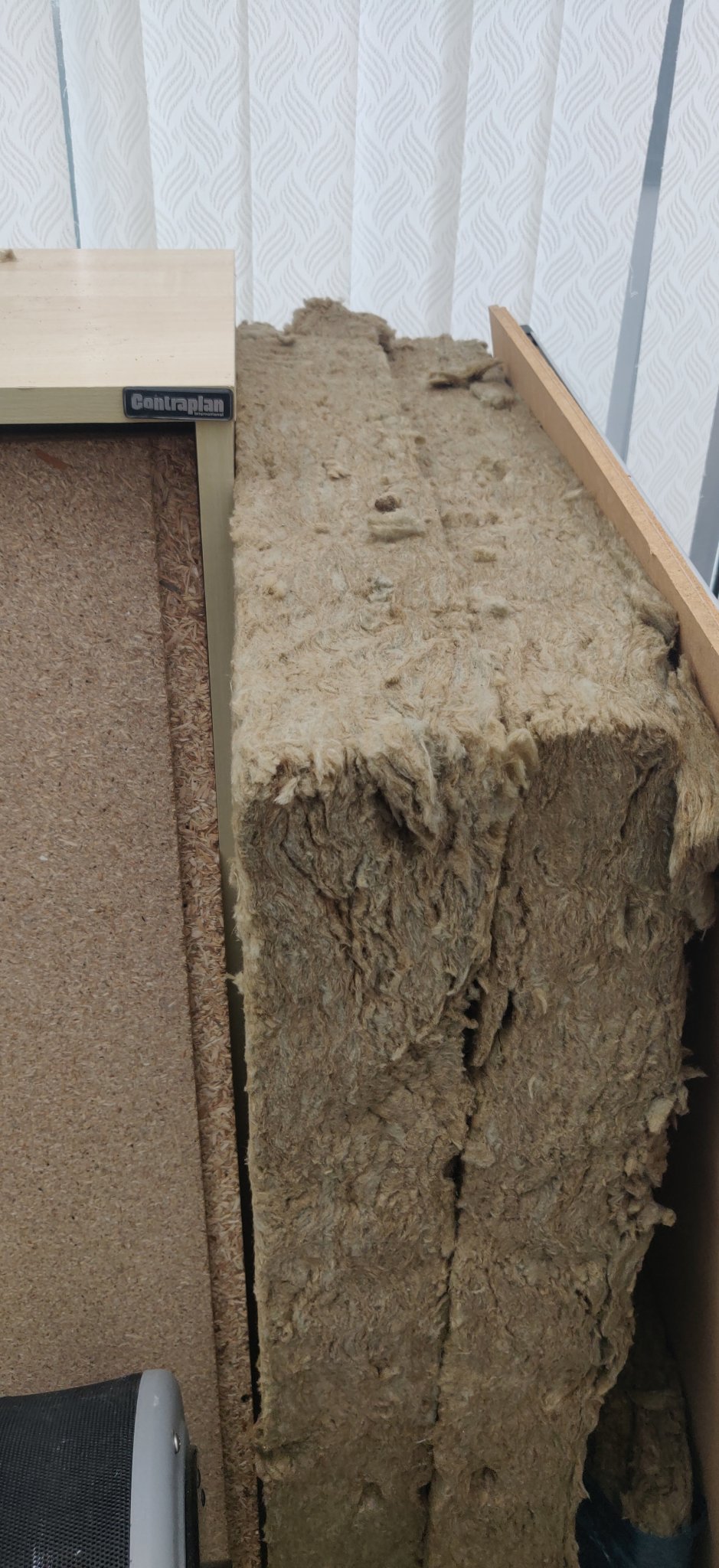

Put rockwool, , Metisse cotton fiber or this foam in the mid enclosure, and fill it up to the back of the magnet.
If you want to check your system and have no intentions to develop loudspeakers, get an USB measuring microphone like the miniDSP Umik-1 plus a stand, get REW on your PC and find some way to connect your sound card to your amp. This gear also enables you to optimize your room setup and you could think of equalizing bass response with a DSP solution.
Could i place that foam in the tweeter compartment too?
I've got some dense rock wool sheets, I could try using them?
I'll looking into the usb microphone suggested, just need to find out how to connect the pc to the amp, as I don't have a sound card, just what was on the motherboard
Well, I've put then rock wool sheet into the mid cabinet and the tweeter.... It has calm the sound a bit, maybe a bit more detailed / controlled.
I tried it, with and without being in the tweeter compartment and preferred it with it in there.... Without it the speakers sounded a bit bright...

What have I done that is so wrong?
I've lined the enclosure with a 5mm rubber/plastic sound block sheet that 100% did make a positive different, and now the midrange cabinet and other parts have been overlaid with
https://www.ebay.co.uk/itm/29571944...ar=593897181148&widget_ver=artemis&media=COPY
I've made sure the ports are now properly sealed... What else can I do?
The speaker requires effective absorption for:
  • the main cabinet resonances (air) with frequencies that lie in the range where the woofer has significant output
  • the midrange cabinet resonances (air) with frequencies that lie in the range where the midrange has significant output
  • between the port and woofer to block higher frequency going out the port
  • the cabinet modes (mdf)
The rubber sound block sheets will do little to damp the structure because the damping forces generated by the small extensional deflections of the cabinet will be too small. It won't damp the air cavity because it will reflect almost all sound. It won't do any harm just not much good. In truth typical cabinet resonances are not particularly intrusive and damping them effectively tends to require some design effort and understanding.
Sticking woolly stuff to the walls won't damp the structure because the walls won't move it. It will provide a tiny bit of damping of sound in the air cavity but not much because it is in the wrong place next to the walls where the particle velocity is zero and may be a bit too dense reflecting sound. What is required is fairly light absorbing placed near the middle of the main enclosure to absorb the cavity resonances and between the port and the woofer. Don't get close to the port because a slug of air needs to be free to enter and exit. Ported cabinets don't require large amounts of stuffing like a sealed cabinet but they do require some to reduce resonances in relatively large cabinets and to block high frequency sound short circuiting out the port.
As others have said the midrange enclosure needs to be filled with light but acoustically effective stuffing making sure to keep away from driver.
Reactions: hifijim
Noted. Everything you said make sense...the soundbock sheet did make a positive difference to them speaker...it just helped it sound quieter, if that makes any sense, as if less sound was leaking through them cabinet.
