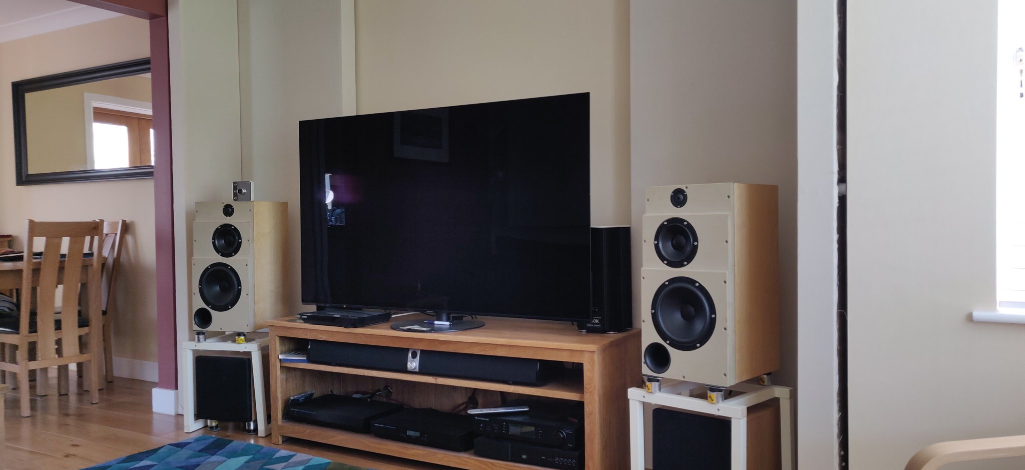

I understand the point about sub positioning, I didn't find they were booming, but I was struggling to set the crossover frequency correctly, too high and they were over lapping with the speaker, lower the output disappeared but any more gain would have been disproportionate.
I was using the sub woofers on industrial springs to isolate them from floor, to avoid room interaction. I'm now using them under some equipment, so might try again.

Picture of setup attached. I don't really have room to place the elsewhere
Your subwoofer is sealed and critically damped (Q0.5).
Main speakers are ported with substantial bass output (tuned ~ 35 Hz).
This is not a good combination to begin with, especially when the room is "difficult"; smaller standmount main speakers with lower bass output would combine better.
Like suggested before: stuff the ports of the 3 ways to cut lower bass and remove any bass peak.
Then your low Q subwoofers should not be difficult to integrate.

Yeah, task for microphone and some software and some work to make it all work nicely together as a system, the room and all the low frequency sources.
It's literally the room that dominates the lows, changing speakers (to another monopole) and putting them at the same location would yield about the same bass "quality". About nothing would change because it's not the speakers but the room, and how the sources and observer relate to it.
I didn't find they were booming, but I was struggling to set the crossover frequency..
Thats exactly how the problem with room modes shows up: can't turn sub volume up as it goes overwhelming, tune it down and now it doesn't hear at all and so on, there is no good balance exactly as you describe.
Room mode nulls make it sound you don't hear it, and peaks prevent you boosting it. Getting modal peaks and dips smoothed out allows you to hear bass withoit being boomy 🙂 There could be 30-40db difference between highest peak and lowest dip, that is huge. If you can get that within 10db or even smaller it'll work much much better. Add a sub or two and a DSP, and take your time to make it work. Better option soundwise would be to go outside, get rid of the room, but thats not very practical. You just have to manage with the room you have.
