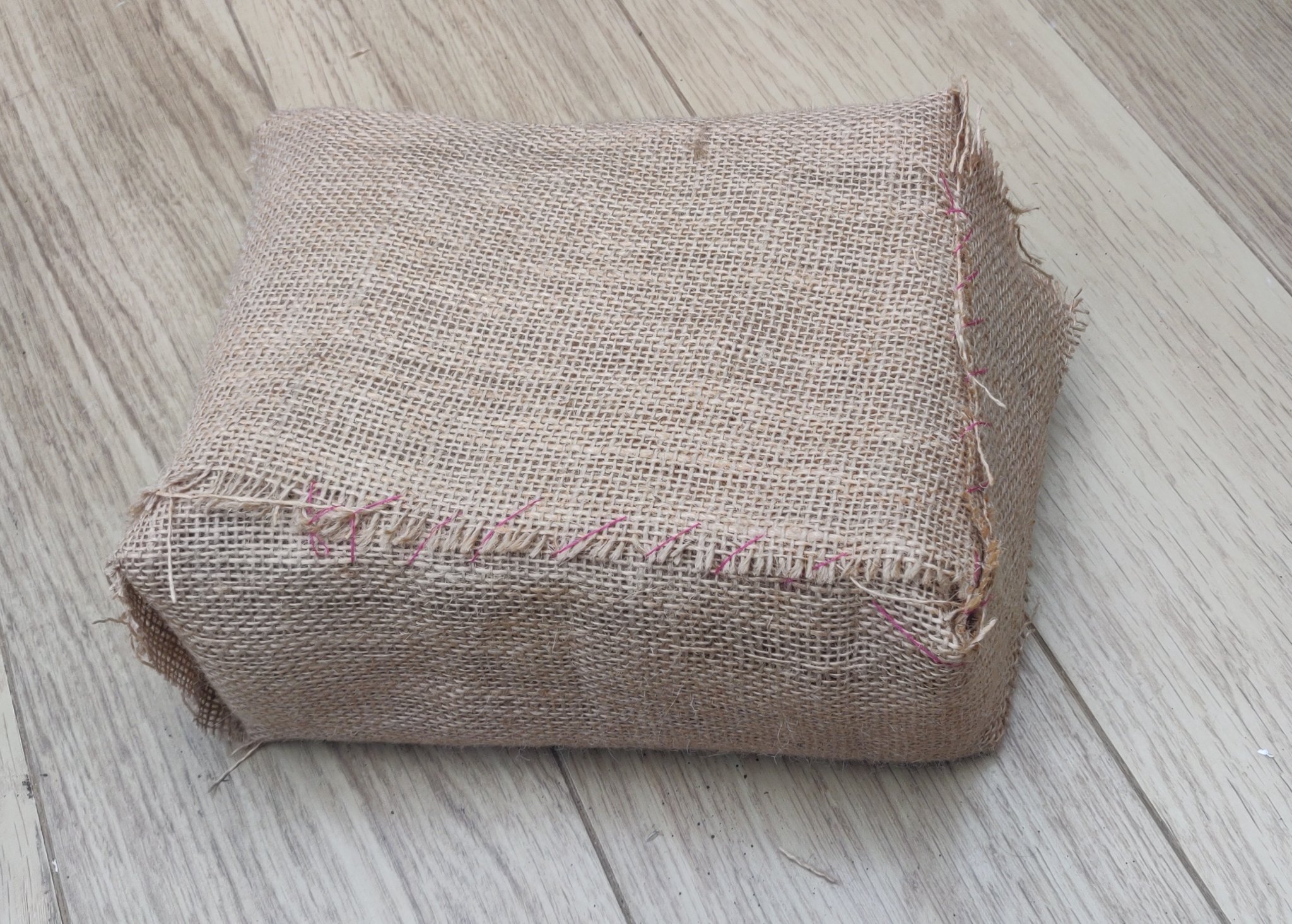

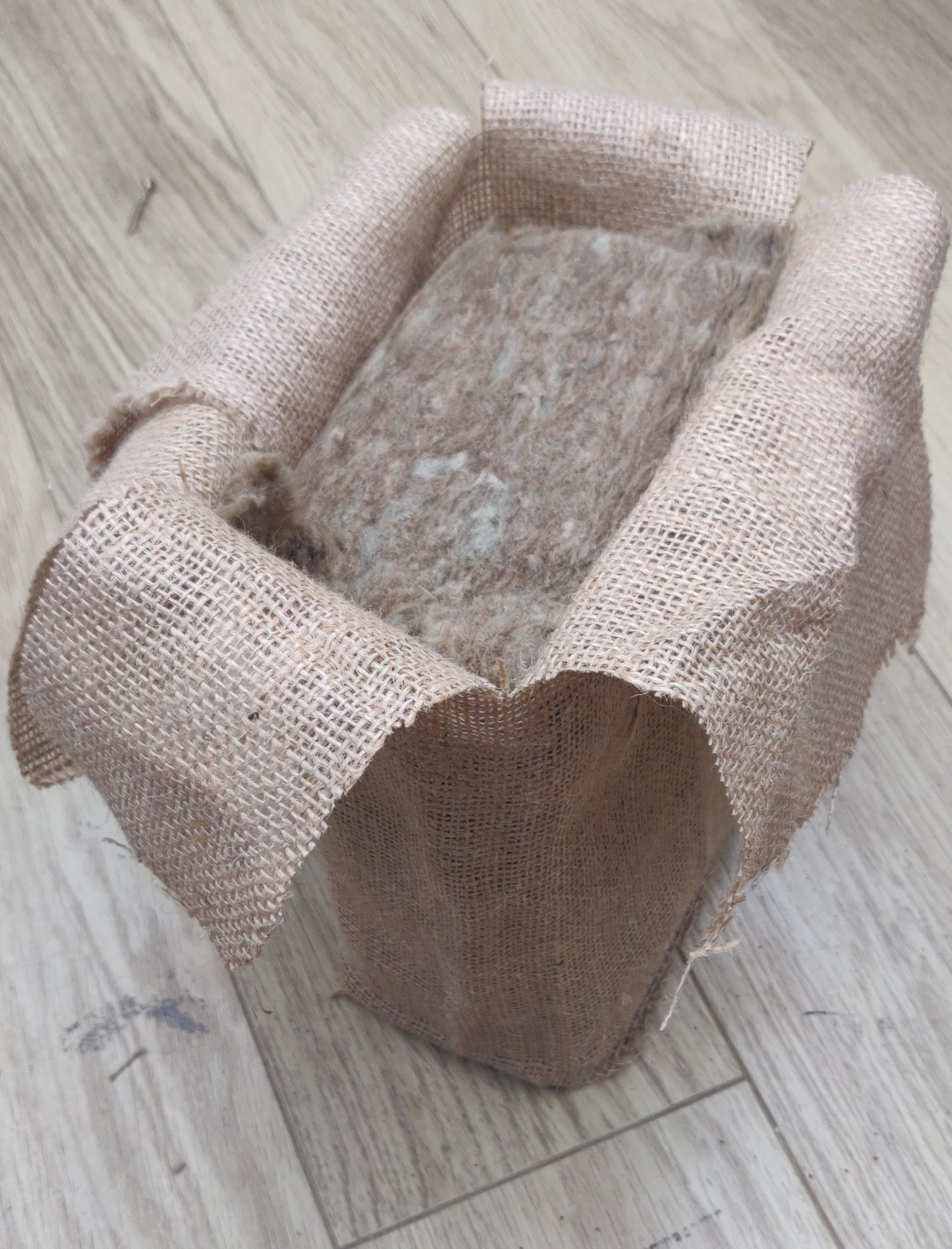

For the bass cabinet, I plan to expirement tomorrow. The three sheets of acoustilux I'll shove in the void behind the midrange enclosure. I have some Hessian sheet and acoustic fabric, and some rockwool RWA45 from making some DIY acoustic panels, I plan to wrap the insulation up first before placing it behind the woofer.
Hopefully it wont suck out the bass. If it does, I'll buy some wool stuffing and try that as an alternative to the acoustilux.
The speakers are sounding better than they ever have. Thank you everyone for helping me out.
The bass cab needs attention. I would check the port output, since that port is positioned in the worst place thinkable. It probably leaks quite some internal resonances. To counter that, you'd have to stuff the whole bass section (fill, not compress) and Acoustilux might be the right choice for that.
I'm not sure how I would check the port output, but other than having it on the wrong side on one the speakers..I just followed troels design.
After reading a lot of comments last night, it seems like Rockwool performs well but people don't like the ideas if fibers going air born, which i can understand. So I've made these rockwool pillows from some leftover hessian. I've placed them in the main compartment, with the acousticlux now behind the midrange compartment and the acousticlux over the bass crossover untouched.
First impression is the upper base might have softened a bit, but guitar rifts are more defined / easier to follow. I don't think the ultimate extension has been adversly effected. I'll live with it a while and decide then.

Well, I've spend some time listening to music with the rockwool in the bass cabinet and the bass has definitely softened in terms of punch. The speaker sounding more relaxed, with texture more defined and easier to listen to. It's a nice quality, but I might try buying some sheep's wool instead on the basis its less dense and perhaps it would allow air flow more freely helping the ultimate extension but at the same absorbing any undesirable frequencies.
