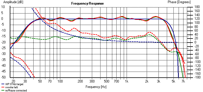

Been working with rePhase and my woofers. On the chart below you will see 3 plots.
  • RED= Altec 416A woofer in a BR box measured at 5 feet (no crossover).
  • BLUE= Ideal 37Hz, 4th order, Butterworth high pass filter. Basically what the box is doing.
  • GREEN= Woofer and box response rePhased.
What will that sound like? Will I even hear it? Time will tell.

I am listening ONLY to the woofers. No crossover. As you can see, it's more or less flat up to 3.7Khz. I want to hear if I can detect any differences just in this very simple way.
So far, yes, I can hear it. It's subtle and not what I expected.
Adding in the mids and highs will be a completely different experience. As we know, our perception of one regiister (low, mid, high) is affected by the others.

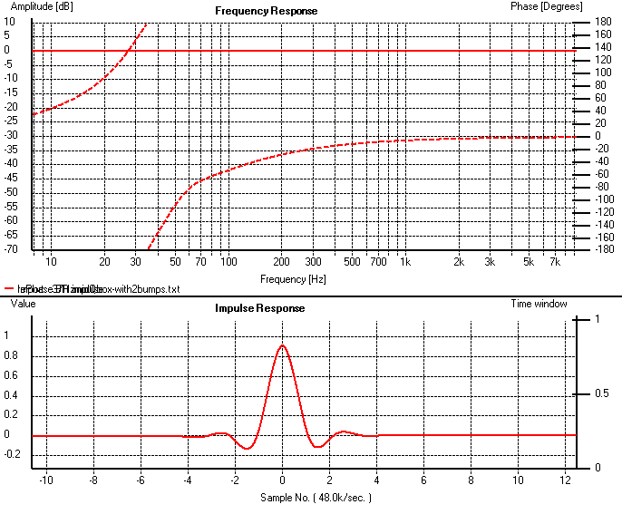

I don't know John. I just exported the impulse wave from rePhase and plugged it into my player software - JRiver Media Center. I could be that it's upside down, I don't know. Will try to figure it out. I either have convolution turned on or turned off, if that's what you mean.
by default rephase linearization is an inverse all-pass.
the IR exported is corrected time
Pano,the HOLM graph you've shown is with a reverse time IR applied to correction,only to match and to check by visual.i think you've used a reverse option (in rePhase or in HOLM).
check your IR with REW,import IR as WAV,and choose "group delay" tab.
time in the lows should be negative.
So you do think this impulse when convolved will correct phase only of my woofer response?
That seems to be what I'm seeing, but could be wrong.
you're right,only in the lows and for the bass reflex delay.(picture below )
a simple way is to do a 4 feets mic measurement of loudspeaker,extract excess delay,and applied theoritical phase linearizationn for full range.
here's your correction (bass reflex 37 Hz)
