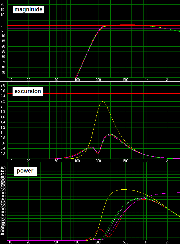

I am planning to use a ported enclosure for my midbass driver, with a 200Hz tuning and additional filters and EQ to get a LR 48dB/oct HP filter and subsequently linearize it as such.
Here is a WinISD simulation with a JBL 2123H in a sealed box in yellow (+ heavy Linkwitz transform and LR 48dB/oct HP filter) and various ported boxes of different size and 200 tunning (+ filtering and various EQ to get the same LR 48dB/oct magnitude and phase), and the resulting excursion at 300W, as well as the power seen by the driver.

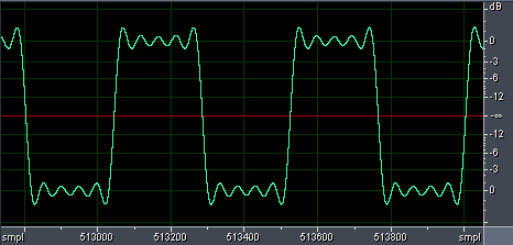

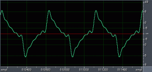

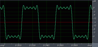

Square waves <500Hz band passed to remove content above 3.5kHz, still look remarkably like square wave. 100Hz square wave with only harmonics to 1kHz has six components and also looks like square wave with smoothed corners and ripple:
When 37Hz 4th order Butterworth high pass filter is applied to above:
Group delay of each harmonic changes waveform, changes sound.

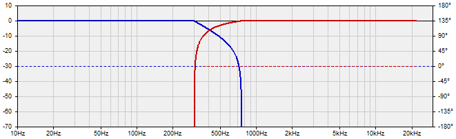

This is my system http://www.diyaudio.com/forums/multi-way/100392-beyond-ariel-776.html#post3064192 - crossover is but 48 LP to but 12 HP at 450 hz
i can even think about what it doing with phase. It measure flat at xo in every angle - no lobing. I can measure gated to ca 200hz. So it can be possible to measure and correct phase deviation. But so far measurement is very dependent on sweep length. Very long sweep produce completely nonsense IR.
My plan is use DCX only to XO and make all notches and phase correction in rephase /as proposed/. Theoreticaly is possible to measure phase in electric domain on dcx out but im sure that acoustical side is quite different.
Thank you one more time for great program

Unfortunately i need this asymmetrical XO /i mean acoustic/ layout to get good powerresponse without lobing. The Lambdas twin must be crossed very steep, otherwise they response go too high and start to produce lobes /CTC will be too high/ On other side horn had slightly different radiating pattern than Lambda twins and shallow slope on horn make this transition softer /the acoustical slope is of course steeper than 12db/oct/. I dont know exactly on which HP slope i end with horn /ca 3-4 order/ but it sum with lambdas quite nice. I know there are filters that are asymmetrical and sum correctly /+- some delay my math behind this is lousy/.
My plan was measure system as is /amplitude wise is correct/ and correct only the final acoustic phase sum. Drivers are mounted quasi coaxial so i think it can be possible. 🙂 /im thinking at this as single driver with phase defect/
Your system
Having asymetrical slopes is okay, but you absolutely need complementarity of the magnitude (flat summation) and full coherency of the phase through the crossover.
But of course what happen off axis can be quite different...
If you were doing the filtering in FIR you could try the Horbach-Keele slopes that are specially intented for MTM arrangements like yours.
