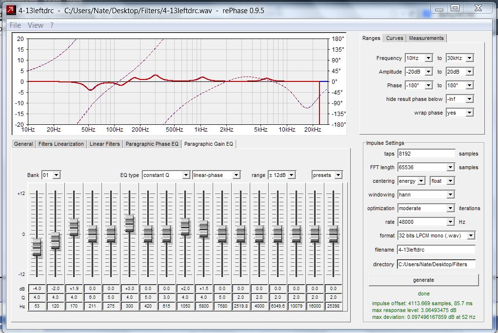

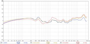

So I'm really liking the import feature for working with phase.......it's a breeze. And I'm learning the limits of linear phase room correction 😱. I noticed you changed how the gain bank is handled. I was going to suggest the capability of doing mixed-phase correction, but this seems to be doable with the different gain bank tabs. Quick measurements confirmed this, but I'm getting some strange results (or maybe normal but beyond my super limited knowledge of this stuff).

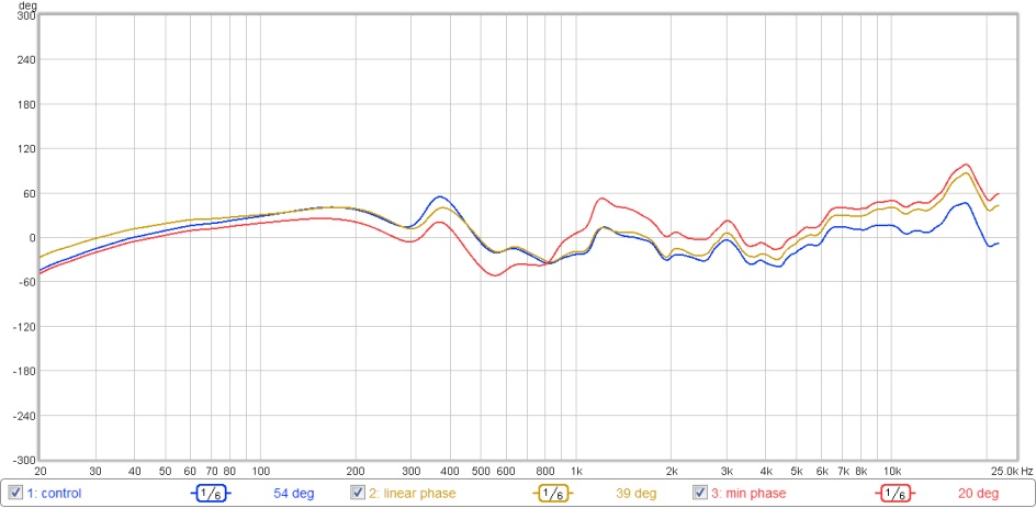

To check if rePhase can do linear and min phase correction at the same time I set up a -12dB Q3 notch at 800hz in gain bank 2. I'm using gain bank 1 for linear phase freq correction. The blue curve (we are looking at phase here) is the control: no notch at 800. The tan curve is with the notch. You can see that phase at the notch area is unaffected.......but it begins to advance around 4khz. Is this normal behavior when the correction is supposed to be linear phase? The red curve shows the notch made with min phase selected for gain bank 2. You can see the phase changed at the notch point, as well as the advance above the notch. Is the advancing phase above the notch normal behavior for a min phase filter?
I'm hoping to do mixed-phase work, because when I first set my room correction filters (linear phase) in rePhase I found the limits I alluded to at the beginning this post. I went from a solid central image with no convolution to a very diffuse, wider, soundstage with no discernable image at all with convolution using my rePhase generated filter set. It seems the filters that are common to both channels can be done linear phase, and channel specific filters must be done min phase. There's more to it than that but that is basically what I found.
When I tried to do the channel specific filters in gain bank 2 set to min phase I get the same strange, diffuse soundstage. When I do the channel specific filters in MC's PEQ and the filters that were common to both channels in rePhase set to linear phase my stable central image is back. Is the convolution process itself causing this strange result or is it something else?
I'm also getting some strange results when I change the sample rate in my player (J River). During my measurements and building the filters I had rePhase set for 48khz, and MC was resampling to 48khz. MC convolution page confirms that the filter is working at 48khz, and the sound is fine. However, when I turn off resampling in MC (files on my hard drive are all 44.1khz sample rate), and rebuild the filters in rePhase for 44.1khz I'm getting weird results. MC confirms that the filter is running at 44.1khz but the sound is way off. I went from a solid center image at 48khz to that same strange diffuse soundstage. I took measurements for each sample rate and those results are fine. What's going on with the different sample rates here?
I included a pic of my rePhase window, the other channel is setup the same.
Mixing minimum-phase and linear-phase EQs in different banks should work just fine. When measuring phase you should always check for the offset of the impulse within your measurement software: it will usually try to find the ideal offset automatically, but any tiny difference will greatly affect the phase up high. For example a single sample offset of the impulse will cause a 180° phase shift at the Nyquist frequency.
If you can manually set the offset then you should always force it to the offset given by rePhase just under the "generate" button.
That "diffuse soundstage" problem, it is likely to be due to a different delay for the left and right channel when using energy centering.
Different settings will lead to different offset based on energy distribution within the impulse, especially when minimum-phase corrections are involved.
Again, you have to check the impulse offset after generating the impulse, and make sure you can compensate for any difference between channels within your convolution engine or media player.
If you cannot, then you would better stick to 'middle' centering to be sure you got the exact same offset/delay (for the same number of taps at least) on all your channels.

Middle centering did the trick! I moved all my room eq out from MC's PEQ and into rePhase with linear filtering. No more goofy diffuse soundstage. Both 44.1 and 48khz filter sets are working, so I don't have to resample my Redbook files and MC's auto sample rate switcher (for convolution files) switches the filter sets when I change to a 48k source.
I'll see about doing some more measurements this weekend and try to get the impulse offset deal worked out.
Thanks pos!
