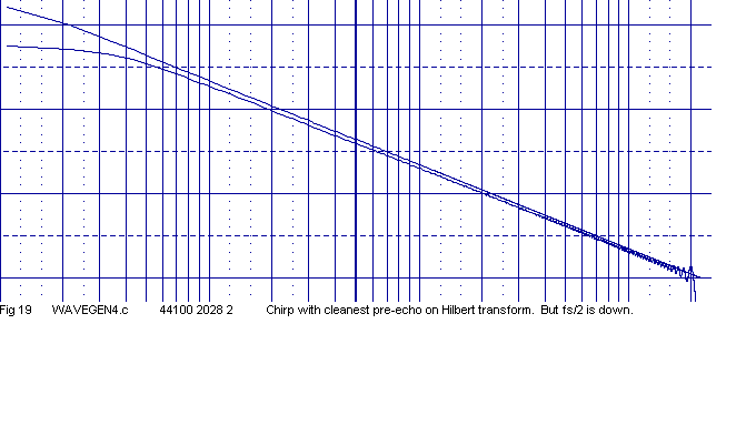

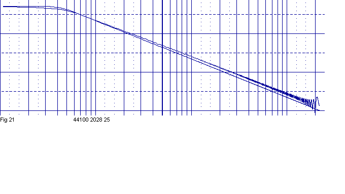

Adjusting the start & end freqs of the sweep will affect the "final impulse".
Here are some spectrums of log sweeps I use that illustrate the end effects. I use my own software. These affect the accuracy of the "final impulse". The final artifacts appear at half Nyquist as would be expected. Short chirps to accentuate the effect. For the 2" driver, starting the sweep at 100Hz is probably OK. I would use a sweep speed to give the dulcet tones of a 14s B&K 2307 chart recorder sweep cos that's what God intended. 😀
But you may like to actually measure the "final impulse" separately rather than look at processed results. It's easy to make processed results "perfect".

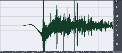

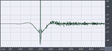

Above is demonstration of design process and choice, previously you review my IR data, and comment about pre-ringing. Above shows that I could easily follow path that produces speaker stamping out causal impulse type response. Measured result follows design choice for linear phase, and is easy to see when high frequency clutter is filtered from result:
Unfiltered IR of corrected system:
With application of FIR 4kHz low pass the above becomes:
Very much the predicted result.
Microphone at 23cm may be thought of as virtual source. All energy passing through this point from drivers continues radiating outwards in cone with identical wavefront as direct sound.
Yes, small regularization parameters request Kirkeby to seek more convergent solution. As Fourier system, the longer in time, the higher the frequency resolution. Properly used, inverses produced are highly exacting.
Sync function from time domain construction of Farina's sweep remains. The raw sweep and inverse generated by time reversal and amplitude envelope to get flat FR when convolved produce 2x long sync function with rectangular window. Farina's fading/windowing functions constrain/compact result, but always leave sync residue.
