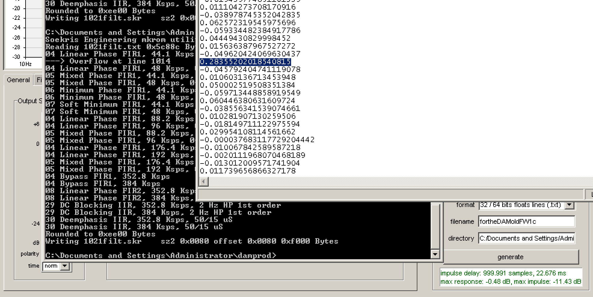

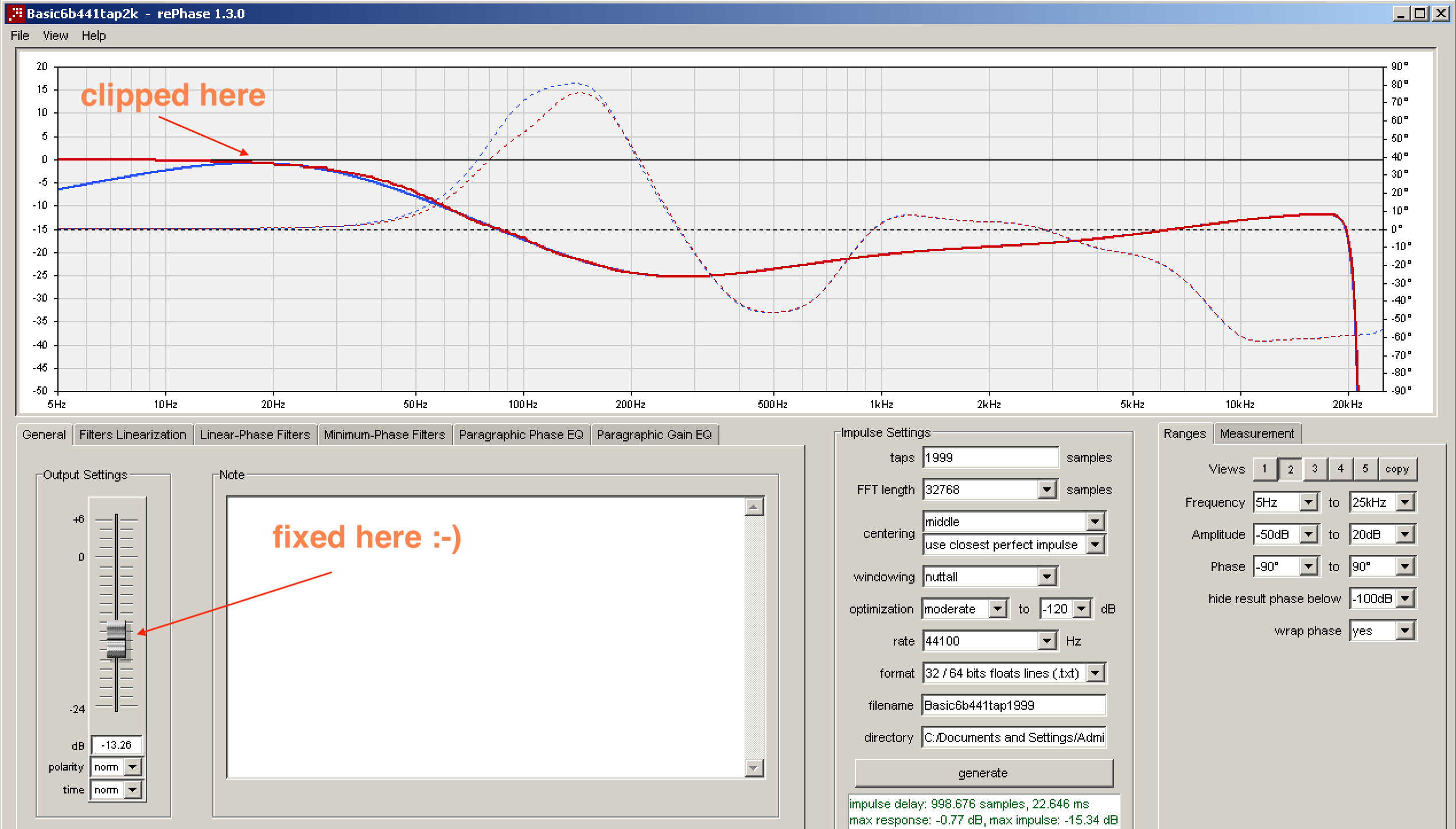

I have indeed managed after som struggle to use rePhase and mkrom.exe to load my DAM with a filter that makes output that resambles what I play 🙂
But it sounds awful. There could be a few resons for this but I have one issue that I need help understanding.
The mkrom utility checks for overload by I assume multiply all coefficients with a "multiplier" defined as a user input in the filter file. This is usually set to 8 as it seems like coefficients comes "usally" out at max 0,125.
Now, I get overflow and needed to reduce the level in rePhase with 28 dB to make it pass mkrom utility without overflow.
My filter contains not only the D/A brickwall filter but also some quite hefty EQ for a pair of line sources I just built. I hope to let the soekris DAM DAC do the EQ 🙂
I attached the .rephase file zipped and a screenshot of the overflow event. 0,28x8>1!! 8-o
Glad for any help. At least now I know the process so we can write a guide :-D

I am afraid the sampling frequency you have to use for this FIR is quite a bit higher than the 44.1kHz you are using here. It might be something like 384kHz, which of course means you have much less correction power with the same number of taps.
With your current settings the DAM will simply apply that FIR with a 384kHz rate (or whatever frequency it is using) and every correction will be transposed higher up in frequency. And of course same goes for the antialiasing filter...
