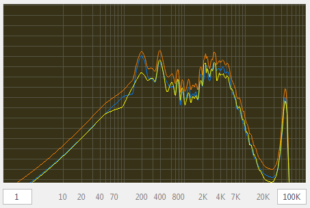

attachment.php

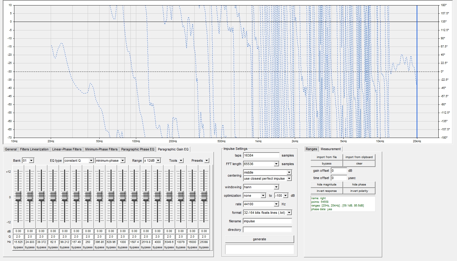

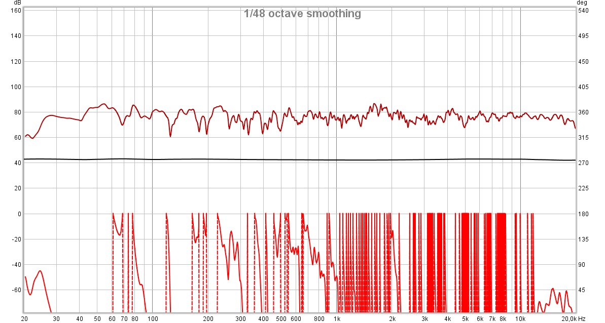

Hello everyone,
I can't understand how to make rePhase understand REW measurement files. Attached are the screenshots from REW measurement, I export it as txt, then open in rePhase and what I get is on the 2nd screenshot. What is wrong? I'm using UMIK microphone, Windows 10... Could someone please help me?
