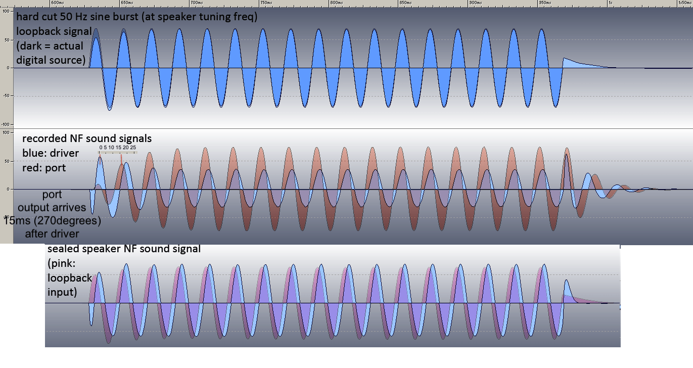

The vent output lagging behind the direct radiator output by 270 degrees at Fb can be seen in the close-field measurements posted by stv:What you describe is (part of) the physical model and while it may sound intuitive, it is not what is really happening.
As long as dimensions and distances involved are small compared to the wavelengths we can safely use lumped model which tells us that both cone and port radiate simultaneously, albeit with different frequency responses, the cone being a highpass response with a dip at Fb, and the port being a bandpass with the peak at Fb. Just as seen from close-field measurements.
https://www.diyaudio.com/community/...ers-out-of-fashion.412687/page-5#post-7684005
The 50 Hz Fb used in the test makes for even numbers, 1000ms/50Hz=20ms being one cycle (360 degrees) duration time, each 90 degrees of phase 5ms.
At Fb (bass reflex tuning frequency) his "hard burst" test clearly shows the first arrival of the port output delayed by 15ms, (270 degrees) from the driver output:
As stv wrote:"during the first cycle of bass reflex speakers the driver has an increased excursion, because the resonator does not yet provide the counteracting air pressure."
Above Fb, it is true the "cone and port radiate simultaneously", they oscillate "in phase" after the initial ramp up period, but the delay provided by the Helmholtz resonator is the reason the inverted polarity of the driver's back wave combines "in phase", providing a +3dB gain when 90 degree off (270 degree phase lag) and +6dB above when the output lags by 360 degrees.

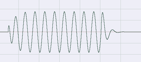

For the second question, yes of course, as given by the transfer function. Take its impulse response and convolve it it with any signal and you get the output signal.Does a fourth order HP filter's impulse response exhibit two arrival times and a 3 cycle initial settling time as the bass reflex response above?
50Hz non-windowed sine burst --> 50Hz Bu4 Highpass:
For the first question, that's sort of ill-posed as the total transfer function only has one output. In the real speaker, this is the sum of port and cone outputs.
If a ported box behaved differently than a simple 4th order analog highpass, that is, if it would not be a minimum-phase system, then Small and Thiele and everyone else after them would be wrong and we would know by now. There is no such evidence. Small's equations in his seminal JAES article still hold (see section 4, "Response Function", equation 20).

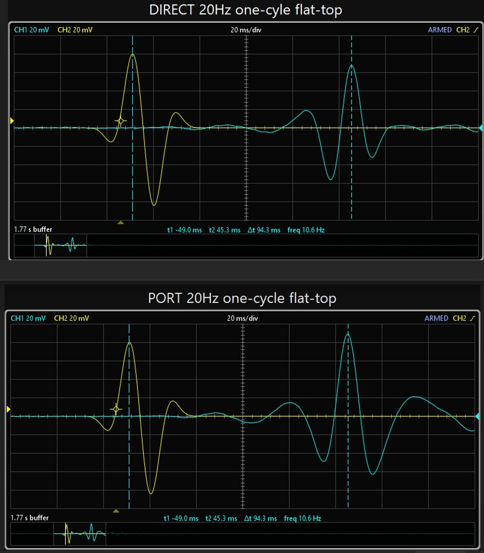

Hi Art, here's a couple of scope grabs , of one-cycle wavelets taken at 20Hz, about 5-6Hz the below port tuning of my latest double 18" subAs stv wrote:"during the first cycle of bass reflex speakers the driver has an increased excursion, because the resonator does not yet provide the counteracting air pressure."
The blue traces are the microphone grabs. The yellow is the reference channel loopback to establish a timing reference.
As you can see, for 20Hz which is below Fb, both the top graph with direct output and bottom graph with port output , had virtually reference-peak to measurement-peak timing.
93 ms equals the FIR processing time and ToF. Mic was about 2 inches inside the direct radiator vee-cavity, and 2 inches inside the port.
(93ms held the same for 25Hz and 30 Hz, both direct and port as well.)
So it seems to me there is no delay at all between port output and direct output......no ramp up / or port charging time, iow..
