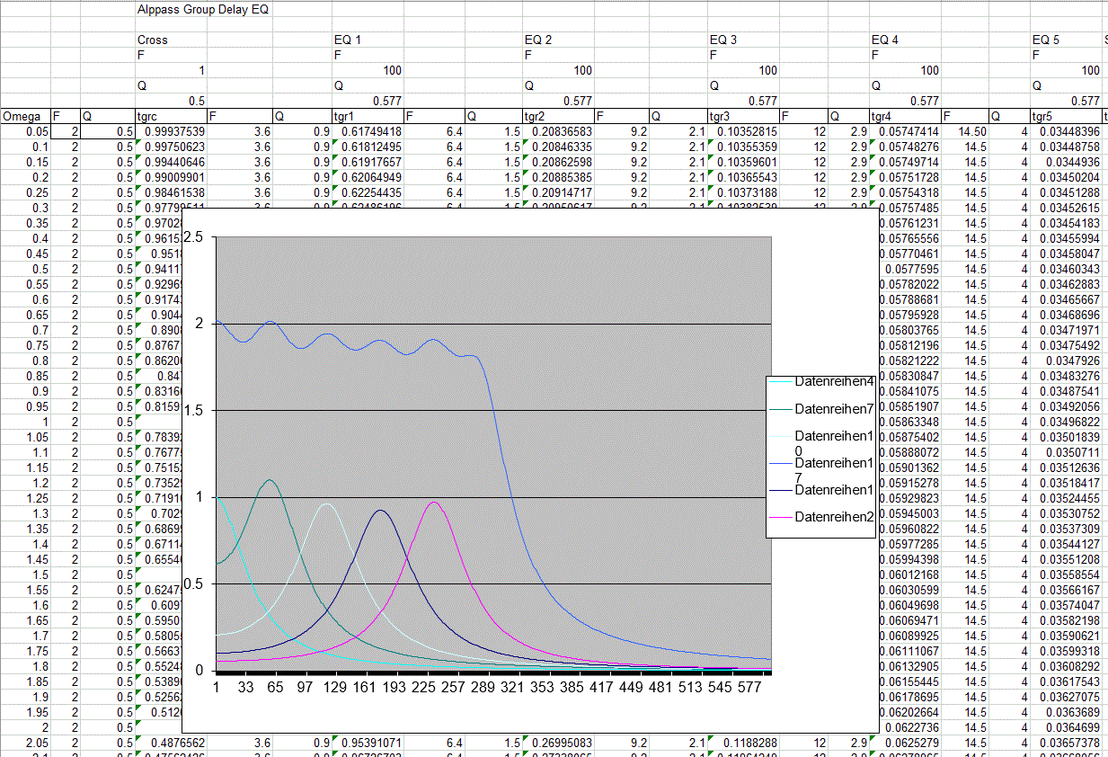

I once made a spreadsheet for designing analog group-delay equalisers using allpass filters. I did the approximation of the pole frequencies and Q values manually by trial and error. With a little practice it works quite well. An automatic approximation algorithm is of course sexier than that ......

1. enter some sane but not necessarily correct values for all Q and F values
As a general rule I found that it is convenient to start with equidistant (on a linear scale !) pole frequencies and Q values rising with frequency.
The cyan trace is the GD of the crossover itself. The blue one is the sum of the crossover and the EQ, and yes the 5th allpass' own trace went missing somehow on the diagram.
And I also once found a formula in a book on filter theory giving a coarse estimation of the total order of allpass that is needed for the EQ. If you want to have a very exact end result you need a higher order if it doesn't have to be as accurate you can go for a lower total order.
Minorder=1 + 2 * GDmax * BW
With GDmax equal the maximum amount of group delay that has to be equalised and BW the bandwidth over which the GD linearisation has to be achieved.
For a LR2 @ 2 kHz for example EQed up to 20 kHz you need 1 + 2 * 106 us * 20 kHz = 4.24 i.e. 4th order for a less accurate result and 6th order if the curve fitting has to be more accurate.

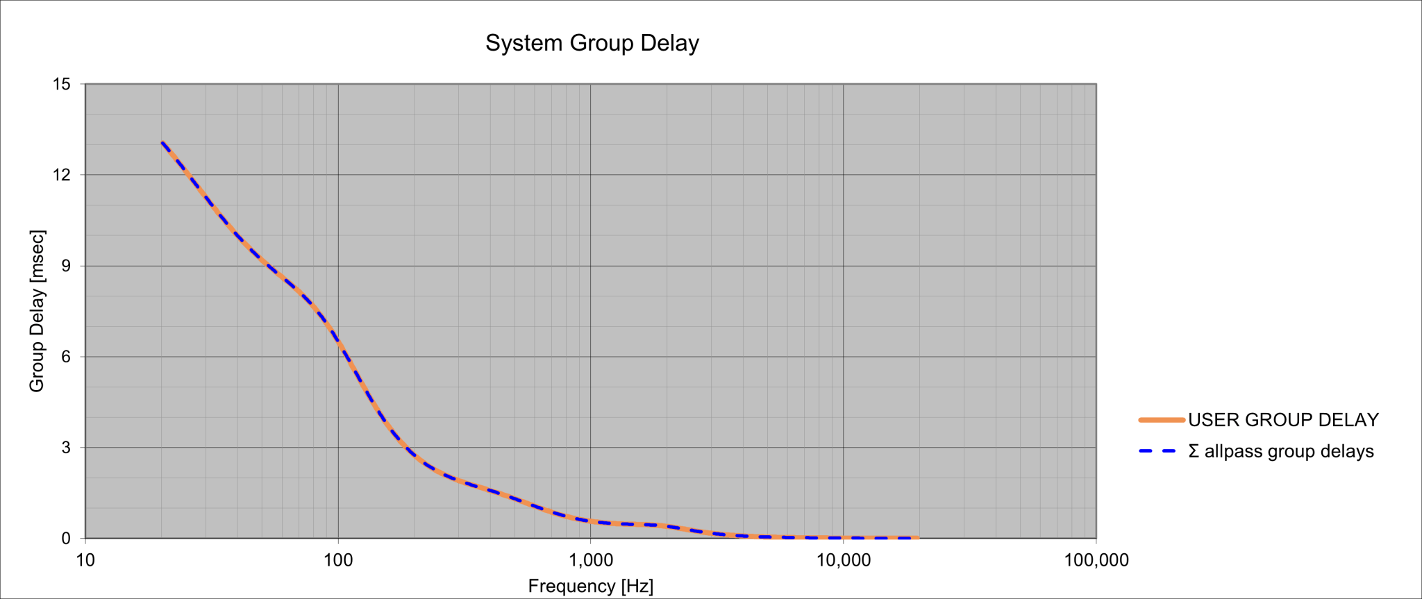

So far I have been working with a GD curve that is generated by the following:
AP2​
AP2​
AP2​
AP1​
F​
100​
500​
2000​
30​
Q​
0.707​
0.707​
1​
I guesstimate you would get this from the following:
The AP1 is like the group delay of the woofer itself
The AP2@100 mimics the GD from an LR4 crossover at 100Hz
The AP2@500 mimics the GD from an LR4 crossover at 500Hz
The AP2@200 mimics the GD from a steep crossover at 2k Hz
Looks like the following. I can get a good fit when I use the 2-step method.

@phase_accurate Can you send me the data for "GD of the crossover" shown in the plot, above. I would like to try and fit it.
The sheet spits out the frequencies in relative values. The assumed LR2 crossover behaves as a first order oder allpass with a pole frequency of 2 kHz. The provisional 2nd order EQ poles and frequencies are:
1st fpole=3.6 kHz, Q=0.9
2nd fpole=6.4 kHz, Q=1.5
3rd fpole=9.2 kHz, Q=2.1
4th fpole=12 kHz, Q=2.9
5th fpole=14.5 kHz, Q=4.0
Keep in mind that these are just quick and dirty values from an example. A little further trial and error would be necessary to get more accurate.

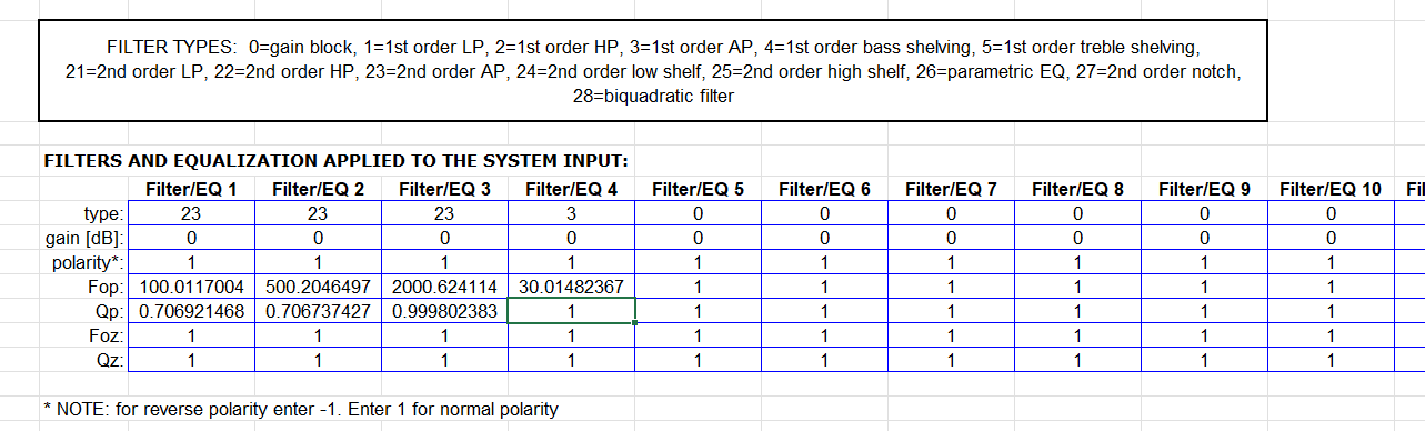

It looks like you are fitting N second order allpass filters to the GD curve. Why would you not fit just a first order allpass with Fp=2k Hz?
Below is a pic of the interface for my Excel fitting workbook. This is an adaptation of a general filter tool. Each column is a different filter. There is a "type" field for which first order allpass is type 3 and second order allpass is type 23. Then you just fill in the Fp and Qp values below. You can add as few or as many filters as you wish (up to I think 20). Then you point Excel's GRG solver to optimize the Fp and Q values, and to use a cell on the sheet that holds the fitting error.
You can see that the values I get by fitting the GD curve with the 2 step method are very close to the exact values I listed earlier. This seems to be repeatable using some relatively random but sane starting values for the frequencies and initially setting all the Q values to 0.6, which is close to maximally flat for each AP2 section.
