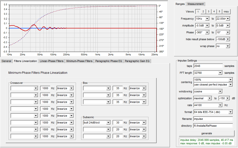

I have a question for the FIR users out there who are reading this thread:
If you wanted to make a 4th order linear phase highpass filter, or group delay correction filter for the same, with a pole frequency of 30Hz what sort of latency would you expect from the kernel? Can you estimate how many taps are required? I am guessing you would need around 8000-1000 taps for sufficient resolution even if you are only running at 44.1kHz.
The reason I ask is that, to a first approximation, a vented box is like a 4th order Butterworth response (of course it would depend on the exact alignment used, etc.). I could completely flatten such a group delay using two second order reverse-IIR allpass filters but because of the low pole frequency (e.g. 30 Hz) the latency produced is around 170msec.

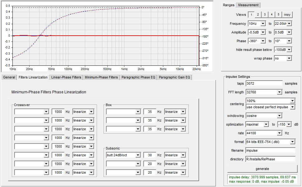

Using rePhase with optimization I could quickly arrive at fair solution using 2048 samples @ 44.1kHz (46ms intrinsic delay) to compensate a 4th order system highpass function:I have a question for the FIR users out there who are reading this thread:
And with 3072 taps the result is completely free of error:

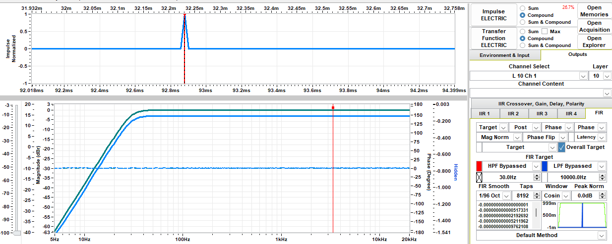

Hi Charlie, it of course defends on how much error/slippage can be tolerated.
For essentially no error, @ 44.1/48kHz, I'd say it takes about 8k taps used linear phase, so 4k taps of latency for about 93ms.

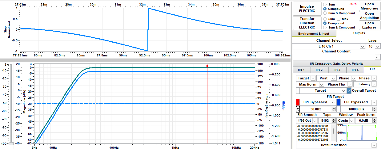

Below is a green target trace of a lin-phase BW30 4th order high pass.
With the blue trace being the FIR output of same filter dropped by 3dB for easy comparison.

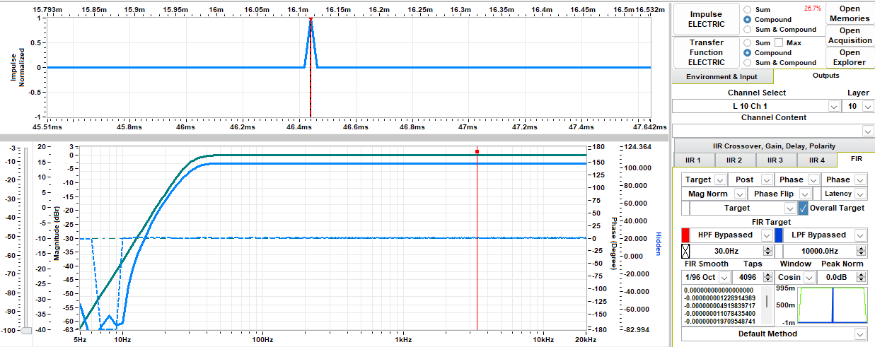

Here's the same thing with tap count and latency half the above, so about 46ms....with its slippage.
FWIW, Looking at the big picture regarding low end magnitude roll-off phase linearization.... it may not be advisable.
Here's the step response of the first 8k tap example above, that held up well.
To the extent the dip below zero prior to t=0 (at 93ms) equates to pre-ring potential, we have a problem that can't be offset from acoustic summations like lin-phase crossovers do.
The same step dip and pre-ring potential will no doubt appear with a RIIR strategy too.

Whether 170ms latency with using two second order reverse-IIR allpass filters, or 69.6ms with 3072 taps, and regardless of whether phase unwrapping of the system highpass tends to sound bad (or doesn't..), neither can change the fact that the vent output lags the direct radiator output by 270 degrees at Fb (Frequency of Box tuning, 25ms at 30Hz Fb) shifting to 360 degrees above Fb, one complete cycle of latency.
