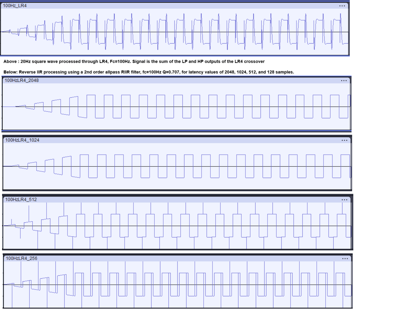

Below are some runs for a 100Hz LR4 crossover, using a variety of different latencies (impulse lengths) in the reverse-IIR processing on a 96kHz audio signal. You can observe the effect of the latency, producing zero output for the first N samples. Latencies of 2048 and 1024 correctly EQ the delay, however, shorter impulse lengths give rise to a glitch for a single sample but overall still manage to correct the group delay pretty well overall.

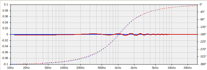

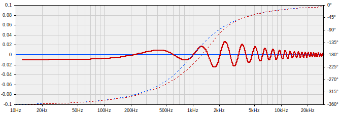

This is where we can arrive at with rePhase, for a LR4/1kHz @96kHz correction kernel, 192 samples long:
With 128 samples, the errors -- notably the phase error -- get larger and choice of window shows higher impact:

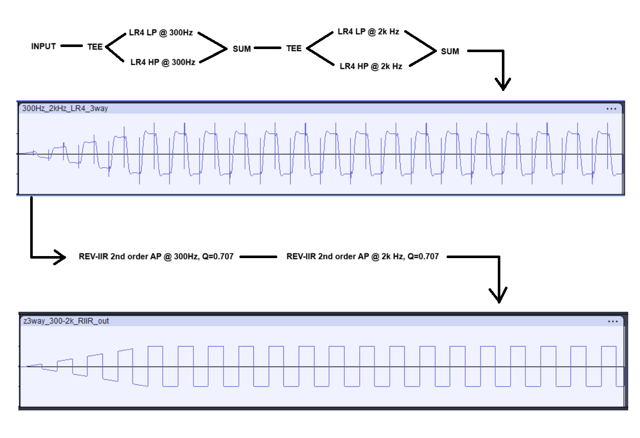

Here is an example of a 3-way system, using LR4 crossovers at 300Hz and 2kHz. It's something that might be found on a 3-way speaker project.
As shown in the pic, I processed that 20Hz square wave through both crossovers to produce the signal with group delay shown a the top of the image. Next I used two 2nd-order reverse-IIR allpass filters to "reverse" the group delay, producing the lower signal. On a real system you would place the reverse-IIR stages before the crossover, but the order doesn't matter for this simulation.
Remember that the group delay produced by the sum of an Nth order crossover's LP and HP outputs is the same as the group delay of an allpass filter of order N/2 having the same Q value. That is why I keep running the LR4 - it's an easy example to show complete cancellation of group delay because its GD response is just a 2nd order allpass with Q=0.707.
The latencies produced by the REV-IIR filters was 512 and 64 samples @ 96kHz.
Thanks for that!
I compared a standard FIR linear-phase 100Hz LR4, using a 96kHz sample rate and same set of samples/latencies..
Latencies of 2048 and 1024 looked similarly fine. With slippage vs ideal creeping in at 512, and 256 showing relatively strong slippage.
Both FIR and RIIR seem in line with each other.

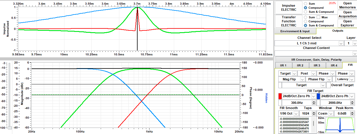

Here's the same electrical 3-way, with LR4 crossovers at 300Hz and 2kHz, using FIR linear-phase xovers. Same 512 sample latency @ 96kHz.Here is an example of a 3-way system, using LR4 crossovers at 300Hz and 2kHz. It's something that might be found on a 3-way speaker project.
Each sections impulse; and mag and phase below.
Flat phase of course equaling excellent square waves.
