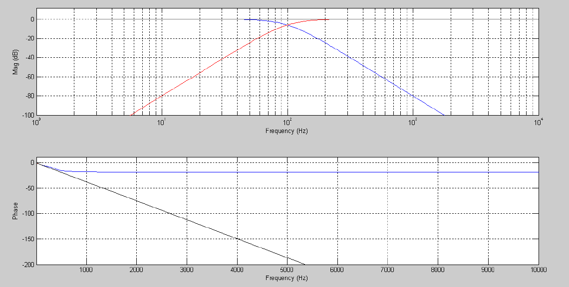

@mark100 here's a 100Hz version (16384 pts) of the same idea. The GD for the summed output is 6ms (vs 4.5ms for the LPF). It maybe possible to reduce this to ~5ms but I haven't tried to do so because the difference is small.
LPF (blue): LR4 100Hz (IIR) followed by 2 x APF (IIR) at 380Hz Q = 1.9.
HPF (red) : LR4 100Hz linear phase FIR with matched delay of ~ 6ms to match LPF at 100Hz.
Summed output (black), impulse attached for interested parties, pls rename to *.wav after downloading.
Thanks for showing a lower frequency example, at 100Hz.
That looks very good to me, flat mag and phase, with a respectable low constant delay of about 5.9ms. Nice work.

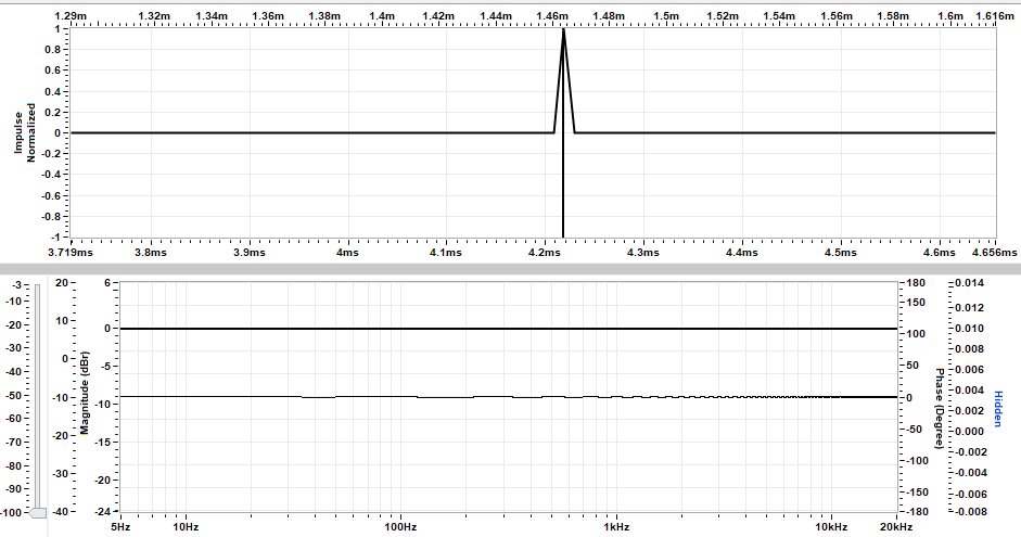

Here's your file loaded as a measurement, into my measurement & sim software.

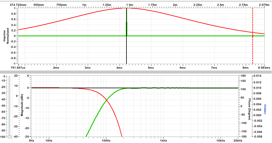

Here's my FIR linear-phase version of the same 100Hz LR24
Sides summed together, with a constant delay / latency of about 4.25ms
Here's both sides:
FWIW, It takes only 3-4 minutes to generate the FIR complementary lin-phase low-pass and high-pass set, at any frequency at any order.

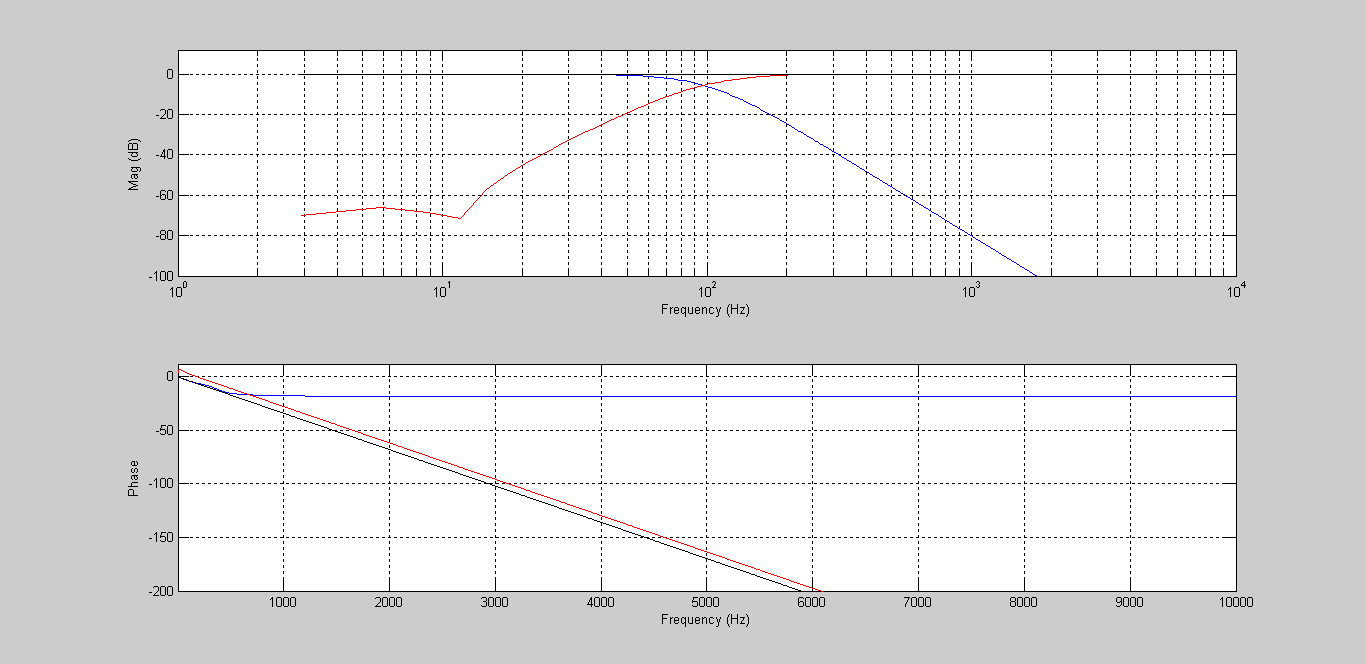

For those who don't have DSPs with FIR capability, here's a simple matched delay subtractive (MDS) filter based on the same IIR+APF low pass, as mentioned earlier by phase_accurate. The exact MDS delay value used here is 5.4ms. This value gives a somewhat 4th order transition upto 20Hz, also giving better LF suppression.
Note that this is an IIR only crossover though it is capable of linear phase and the computational delays are negligible.

@gberchin Yes, just that, nothing special. the allpass occurs only within the lowpass section to linearise the phase to about 5x the cutoff freq of 100Hz. The HPF is then obtained by MDS operation from a delay of 5.4ms. The following gives an idea....
Code:
[G1,F] = grpdelay(u,1,N,Fs); % LPF DC group delay
G1 = G1/Fs;
GD = G1(1);
target_phase = -1.2*2*pi*GD*F; % 1.2x gives the pseudo 4th order slope
HPF = exp(i*target_phase) - LPF; % MDS HPF

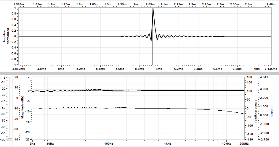

A latency of 4,25 is not an issue, but if it gets more than 15-20ms it probably will, at least for live performances. If I'd like to compensate the GD of a horn (etc) subwoofer, a steep low cut at 35-40Hz (ie your LR24) would result in which latency?
@newvirus2008 , very interesting. You started with a LR4 IIR filter, linearized its phase in and somewhat above its passband, and got nearly a 4th-order derived highpass slope. Thank you; that is good information. I may have to expand section 2.2.1.6 of my MDS paper.
