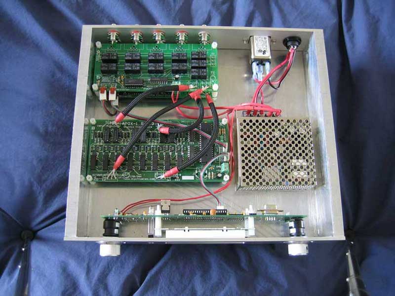

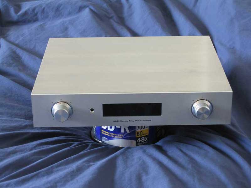

Hey everyone,
While I thought I'd post a few pics of my implemetation of the APOX kit. 😎
The chassis dimensions are approximately 10.5 x 12 x 2.5, with front and back panels custom made by Frontpanelexpress. I found some polished aluminum plate on ebay which was the proper size. Though the pics don't show it, the sides have a mirror finish. 🙂 The knobs are Kilo brand and available at Digikey.
Instead of using screws for a majority of the construction, I decided to try epoxy instead. The sides are half and inch thick, and provided ample surface area for bonding the bottom and front panels.

Tony, your box looks great!

Inside, I've made attempts to keep the wiring neat. I think I may rework the power connections to make them look neater as they go from the power supply to the boards. The power supply is a 5V 3A panasonic switching power supply that I got off ebay for $10. The wiring for the signal wires was the most labor intensive. It is 21g vampire magnet wire with individual teflon sleeves. The entire bundle is then heat-shrunk with 1/4" copper braid and techflex.
I still need to figure out a way to attach the top panel to the chassis. Given how clean it looks without screws, I think I would prefer to find a way to do it seamlessly. Does anyone have any suggestions?
Why not drill some holes into the top (not all the way though) just enough to securely plug in some small 3mm diameter rod of say 5mm in length. You should have about 4mm extruding from beneath the top cover. You then drill holes into the 4 corners of your chassis to locate these pins into.
That'll keep it quite secure and no screws visible. You could taper the pins to hold in tight if you wanted. You would need to epoxy the pins to the cover to stop them coming out.
Amazing work by the way...Extremely inspirational!

I think the nicest part of this project is that it was done without the need for a lot of tools. I live in a small apartment in Manhattan, so don't have a lot of space for large tools like a drill press. All of the assembly was done with a 12" bar clamp, a power drill and bits, epoxy resin, and a set of 4-40 thread taps from mcmaster carr. Heatshinking was accomplished quite ecomomically by simply holding the cable assembly over an electric stove. All of the panels were bought cut to size, and the only panel which required finishing was the top, which was done by hand with a sanding block. I'm very pleased with how well this project came out. By far, it is the best looking thing I've ever built.
Thanks for the idea about using the rods. It sounds like a great solution. I think the hardest part about that approach would be to make the pins and holes line up properly. I have some extra bar stock that isn't quite square. I'll try drilling some holes into it to see if I can do it with enough precision.
