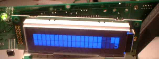

Display Problem
DipChip Gentlemen, there is something wrong with your E-mail I'm sending this message for the third time I hope to recive an answer,

It is very personal issue of course. For instance, I'm using my control in the last quater of the turn only and I can easily detect 1dB changes from max volume and I'm using that small increments quite a lot. Rearly the music is in a background. Probably the best way to figure out the best setup is to use detented pot and play with it for a while, noting the critical settings and then measure it in dBs to see what is really needed.
Re: Display Problem
To be fair Antonio, Dale did respond to your last email several pages back. Conversation has been brisk on this forum, you may have missed it.
Antonio said:Thank you Dale for your kindness and professionality,
Best regards
Antonio

Display Problem
Dale, Graig,
Yesterday I have received the display, I have connected it to the main board but I still have the same problem. On the new display it is possible to see the same characters that it was possible to see on the old one. At this point I do really think that the display is not the problem, and the previous one I think is OK. The new display was connected without soldering so it is possible to use like new, and it will be send back to you.
I think that the bug is in the PIC.
What you Think?
Best regards,
Antonio Ruggiero
Dale, Graig,
What you Think?
Best regards,
Antonio Ruggiero
