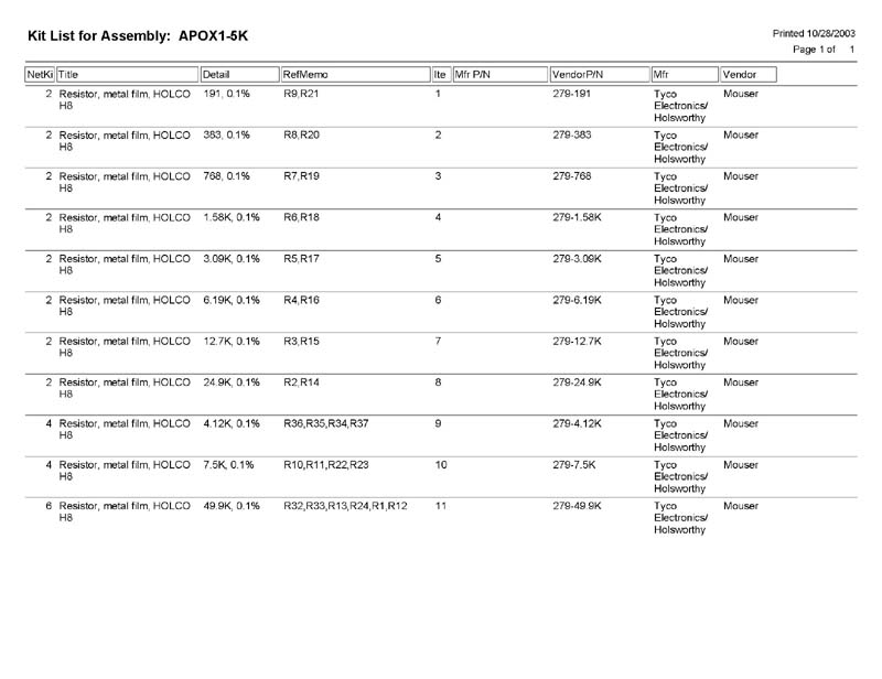

Dale, there are several errors in the 5K impednace kit you sent out in respect to duplicate component labels. I do not have the sheet in front of me but they are easily spotted. I assumed all the relay resistors were to be symmetrical 12 resistors in all 3 per input relay. I referred to the schematic on the two relays that had proper resistor placement documentation and electrically duplicated the other two.
Could you look at the supplied sheet again and just verify the component placement of the 4 effected resistors?

I see it now. The impedances are given for a balanced circuit and not single ended
Thanks Dale, I will verify I have the correct placements.

It seems like choosing proper bypass resistors is quite important.
In my test circuit the max shunt res. is 25k. The bypass resistors are as follows: 50k, 25k, 7.5k. The volume doesn't change smoothly. I have let's say values -11dB, -10db, -12dB, -11dB, -13dB (in that order).
However, when bypass resistors are equal 50k, 7k5, 4k, the volume changes correctly.
This brings the issue what is the mechanism behind choosing those resistors as obviously they can't be picked randomly.
I'm using real time simulation, with generator and dB meter.
Hi Peter,
You are correct. Craig wrote some C++ software to optimize the volume settings based on our resistors. The software made choices based on maintaining a log curve and making sure that the lowest impedence values for a given setting were used.
Craig would have to use your specific values and generate a new lookup table. We would have to supply you with new microcontrollers for the SHM board with custom firmware.

Hi Dale,
Here's my impressions. The circuit and software works great if you want to use it at the output and concentrate on lowest impedance. In this case resistance fluctuations between 2K and 4K are not really important. But even in my correctly working circuit I noticed that although the values were usually around 500ohm and 1k5 (output resistance) at approx 10 maximum positions the output resistance was 50k (which seems to be high for the output).
Also, I noticed that circuit is changing resistance substantially with some subsequent steps. It means that output resistance goes up and down (let's say 5k and 10K interchanging for -11 and -11.5dB and again -12dB for instance). It may be fine for keeping nicely defined steps, but in reality and from Audiphile POV, accurate 0.1 or 0.3 steps are not that important rather than keeping steady resistance and similar values in certain range of volume settings. I also believe that 2 resistors in parallel and 3 resistors in parallel sound different and if system goes constantly from 2 to 3 resitors in parallel with every click of the knob it will be noticed subjectively.
Now, it seems that the circuit is optimised for preamp's output location. But what if somebody wants to use it in front of the amp, without using preamp? Playing with GC, it seems like a best solution and some people simply refuse to use preamps. From GC threads, one might also speculate that those amps reached similar popularity as the Alephs (at least in diy circles). So the dipchip module might be a good candidate for passive pre stage, mounted directly at the amp and in such way that the problems with passive preamps are gone (input impedance on the higher side when directly at the amp). And this is possible since long control cables allow the control unit to be at the source and the apox volume modules in the amp.
Talking about the proper resistor values for such setup, I would see it somewhat like that: The minimum input impedance should be aprox 20k and it shouldn't go higher than 50k.
The combined bypass (series resistor values) should have 3 values, corresponding to log pot operation. It could be for instance 10k, 25k and 40k. Now this values could be achieved with 3 series resistors, but never more than 2 resistors in parallel. Also those values stay put in operating range and thay don't change when you go from -12dB to -13dB. I mean 10K stays permanent in 1/3rd of operating range (let's say from 0dB to -6dB), after that 25K value is engadged (from -6dB to -12dB) and eventually 40k (from -12dB to -50dB). In all those 3 ranges the shunt resistors perform their logic to keep appropriate steps possible. It is only a rough speculation and it may work better with different values applied.
Another thing I would rather see is not steps marked 0-255 as this doesn't say really nothing and is only convenient when people want different resistor values and play with them. But keeping the display in real dB steps would be much nicer and more useful. In this case you would have to choose a fix resistance choices, as I already found out that playing with values doesn't bring expected (by me) results. So it should be either something to use at the output (like 5k max, for instance) and something to use at the input of SS amp (20-50k max) and maybe something to use in tube equipment if there is enough interest.
I understand that you also offer fixed resistance board, but it's limited to 24 positions only and not everybody wants to have 20 reistors in series at the input.
I still believe that good series-shunt control is possible, but with current software option I don't think it can be used at the amp's input. I also understand that it wasn't designed with this in mind and I didn't buy it for that reason. But it would be nice to have something more flexible available as well. This is a great, expandable system and I'm not trying to complain, but rather present more useful input.
