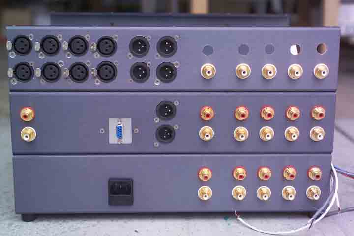

Rear Panel of monster preamp. Inputs are: bottom chassis for surround; middle chassis for center and sub/height and balanced center output; top chassis for 4 balanced inputs and 4 s.e. inputs for front left and right channels. Also in middle chassis are RS232 access from rear and left of that are 2 s.e. for tape out from front channels.

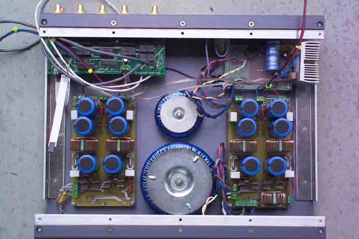

Power supply in bottom chassis. One for 5VDC for APOX boards, one for surround and center gain stage, and one for front left and right channels. The audio power supplies are R-C-L-C-R-C design with a common mode inductor on the AC input along with ferrite bead filtering on AC inputs. Rectifiers are MSR1560 in a dual bridge configuration with ferrite beads on one leg of each diode, giving +/- 22VDC. Transformers are 30VA (6VAC @ 5A) and 260VA.

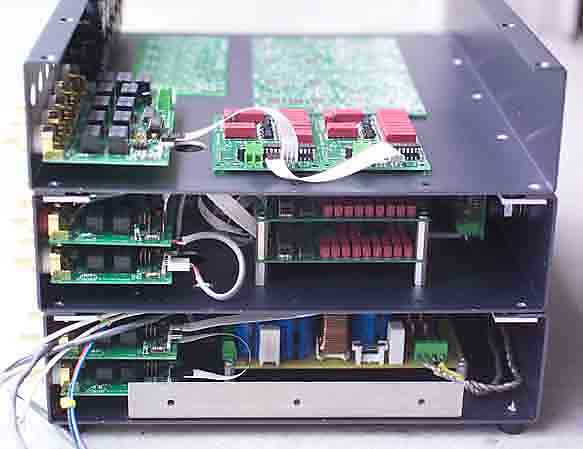

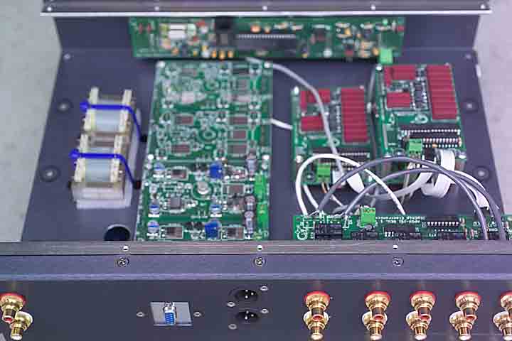

Inside middle chassis with IR1 on front panel; IS1s on the rear at bottom of image; SHMs on the right (there will be 4 on this layer; two for bottom inputs and two for the inputs on this layer); and gain stage boards on the left. To the far left are 2 Jensen output transformers that I may use for generating a balanced output for the center channel from the s.e. inputs. These are normally used in PCB, and are left over from another project; I've got them here in a 'dead bug' configuration.

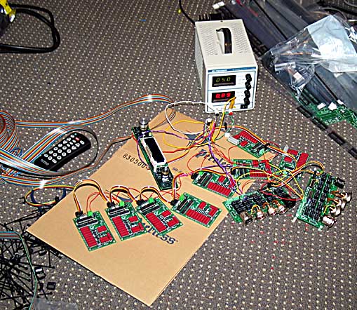

APOX-SHM testing
Due to some issues with Robert's very large system, Craig and I decided to do a big test to make sure a large system would work.
1) We discovered that three of Robert's six boards had a microcontroller that had a good program, but bad configuration registers. We are not sure how this happened, but are glad that this was the cause of the "self resetting".
2) We connected 8 SHM, 2 IS1, and one IR1 together to make sure that the I2C would work correctly. As pictured below, the system works fine. We tried to break it, to no avail.
