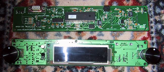

Question :
I have these Alps encoders, can they be used?
(do not know type or model-nr).
-and I would need help about connection...
Where can I find info about encoders, (FAQ), I have never used them before.
It would also been great if the "dipchip-web" had been formatted for printing...
As a last Q: Where do I find a FAQ about all Volume-types, wich to use where, etc..
Arne K
Arne K

Hi Arne,
Have you fired up the boards yet?
The alps encoders should work fine. The encoder interface is fairly simple. I assume that the alps is a mechanical encoder, so the RC filter would be required (all parts are supplied). I don't know how many transistions per rotation.
There is no set advice on which volume control to use. A tube preamp may require a constant impedence (apox-2), but you can put the volume control before the preamp gain stage. If you want the volume before the gain, just make sure that your sources can handle a varying load (most can within reason).
or, juts try them. If you notice loss of dynamics, it may be a bad choice...
Dale
Dale

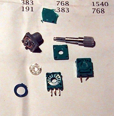

I've done some research on an alternative encoder, and found one that works.
The Digikey number is 102-1019-ND and are $48 apiece. The manufacturer is Tosoku-CUI Stack; part number is RE21NC25C20RA. This one comes with flying leads (5 of them; there are 6 pins on the Greenhill encoder, but 2 of things are shorted together on the IR1 board and both lead to ground).
The shaft is 20mm long and metal, so it is more robust. It is 6 mm in diameter so fits large, heavy knobs like those from DACT (boooo !!!). The clicks are quieter. It too has a switch feature.
I mounted the IR1 using the holes at the corners of the board using 7/8" standoffs. I have the display on 3/8" standoffs.
I soldered the leads on this unit (pins 1 to 5) to those on the IR1 board (reverse order: pins 6 to 2; the two ground pins 1,2 are the same). I use the same unit for the selector and the volume. The only problem I have with it is that the output is at 25 cycles and the selector is at 16, so it changes inputs rather rapidly.
Dale, perhaps through software, we can adjust the rates of read-out from the encoders, and slow things up a bit?
Regards, Robert
Regards, Robert

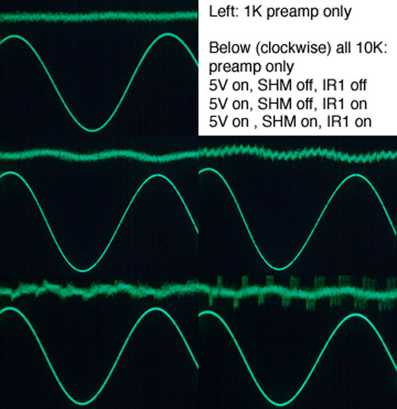

Below is a collage of images I made of oscilloscope shots of my surround preamp's signals. The signal is either 1kHz or 10kHz from an HP 339 distortion analyzer.
The reason I'm posting this is I was getting crazy THD readings from the preamp, yet I knew my gain board and associate power supply were very clean with low THD and wonderful sonics.
I recently got to thinking there was a problem with the digitial power supply corrupting the signal, so I progressively studied the situation and found there appears to be other sources contaminating the signal.
But first some background on the gain stage. The preamp gain stage is discrete and is set for 2x gain. It clips at 17V RMS output. Power supply is well filtered: AC -> ferrite beads -> common mode choke -> soft recover diodes with ferrite beads -> C-L-C-R-C (22V) -> local regulation to +/-18V on each gain stage board. THD of the gain stage at 1kHz is 0.007%, at 20kHz, 0.020%; at 100kHz, 0.090% when used by itself (no APOX circuitry); primarily 2nd order. Noise is about 35 microvolts. This figures are derived with a 600 ohm load of the oscilloscope and 1V output. Input impedance is 1M; output approx 10 ohms.
The 5V digital supply is essentially a wall wart that is rated at 2.8A that I placed in the chassis (bottom layer). The AC is hard wired to its input. I fused it's output so when the fuse is removed, I can check it's affect on the signal but without a load on the digital supply.
My APOX topology is: signal -> IS1 in -> SHM -> gain stage -> IS1 out. Where the images says preamp only, the signal entered the preamp board directly without any potentiometer or IS1 board. In this case, the preamp power supply was on, but the digital 5V supply and all APOX boards were off.
To better describe the images: upper left is gain stage (preamp only) at 1kHz. Below all images are at 10kHz, going clockwise starting at left (left side, middle image):
Gain stage only;
Gain stage + 5V digital power supply on but without load (IR1/SHM both off; IS1 not used, it was off too);
Gain stage + 5V digital power supply on IR1 and IS1 on, SHM off (bypassed);
Gain stage + 5V digital power supply on and all APOX boards all functioning.
Interestingly, the 5V digital supply even without a load does contaminate the signal as seen on the THD plot. Thus, despite my trying to minimize garbage getting into the gain stages power supply, it still gets in. I may either need to re-locate it from the chassis, or go back and change it to a linear style supply. This is not where I need help.
Where I need help comes next. Unfortunately, as shown in the lower righthand image, it would seem that the SHM board also adds to the THD with some very high frequency peaks being added to the THD signal. The only difference between the lower righthand plot and the one immediately to its left, is the signal is being routed through the SHM, whereas the image on the left the signal bypasses the SHM but is still routed through the IS1 board.
So, my question is, how is the SHM contributing this added distortion and how to cure it?
Thanks for any help, Robert
Gain stage only;
