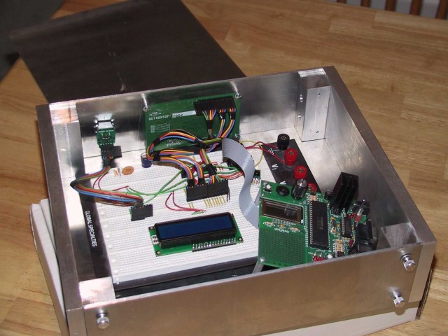

Actually, below is my project was for last semester, and I used my pic dev board, along with a vfd, different optical encoder and a pga2310 board that I made, and it worked great. I was going to get my own pcb made for the front panel, but yours looked so good that I couldn't resist just using it instead, converting my pga2310 board over to i2c, and I would be done.

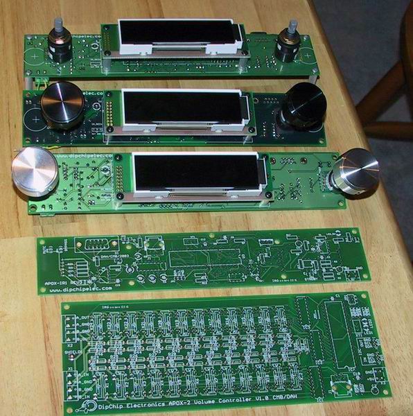

JasonL said:Brian you should take a pic of your bare boards and post them on your pic gallery as im there every day looking and druling over your stuff and creations.
Here is a better picture of all the boards. I have the 3 - IR1 kits done now, which will do it for now. The top one is rev3, which I will mount the encoders with cables to get the spacing that I want, the second one is the older revision pcb, which will be mounted with the encoders close together, and the 3rd one is the rev3 board with the encoders in the proper location, which I am thinking might be too far apart for my tastes, but I am going to make a wider chassis for this one. The two bare boards are an IR1 and an APOX2 board.
I need to start working on my i2c interface chip for my pga2310 setup. I am trying to use one of those 8-pin pic12f675 to do this task, as I picked up the new PICKIT1 FLASH starter kit from Microchip. Highly recommended. $35 from digikey for the kit, which includes a C compiler and a USB programmer.

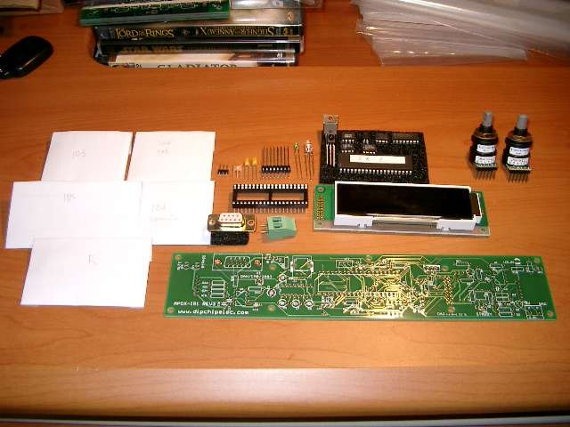

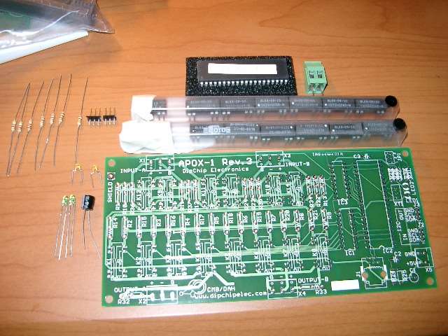

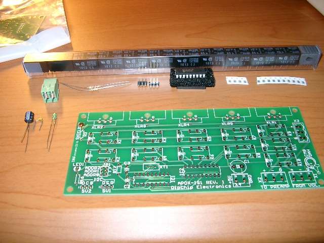

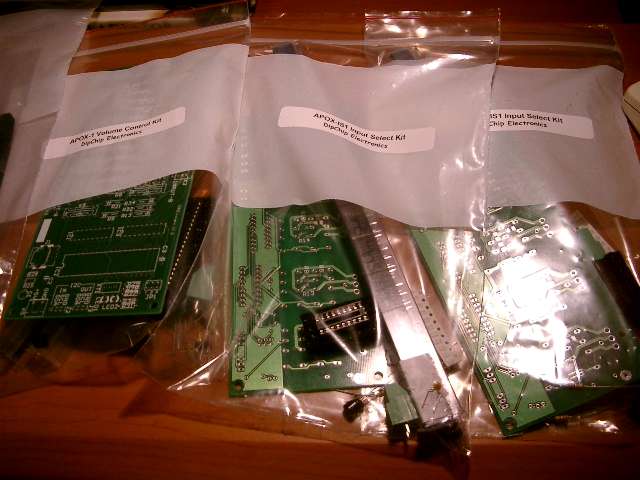

I just received my kits today, less the ULN2803A's. No problem, there is no hurry, as I will work on it this weekend. Here are some pictures:😎
Henry,
Awesome, I was worried about the long distance shipment to Hong Kong. I can't wait to see what your final system looks like.
Good luck in your construction and thanks for the photos!
