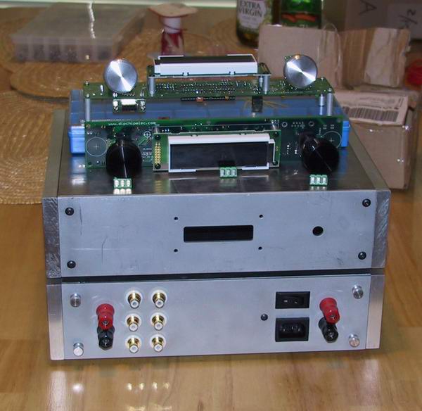

I now have 2 working IR1 boards. Here they are with my chassis, which haven't been brushed and anodized yet. The bottom one is mine, and the top one is my friend's. I am going to have the machine shop at school cut some new front panels for the chassis next week for the larger display and dual encoders.
Brian

That is some nice work man. Hey where do you go to school. How do you afford your projects and do school. ?

I am glad to see that someone else bought the same crappy set of pliers cutters and needle nose at sears. I am down to my third set, the cutters have a tendency to punt when put under too much pressure. Gotta love the lifetime warranty! 😉
A question:
is it me or you mounted the encoders on the wrong side? Did you get an earlier version of the board?
A question:

Awesome work! I can't wait to see the boards stuffed in the box. But make sure you finish your homework. 😀
Or, are you using the Apox kit as a school project?

JasonL said:That is some nice work man. Hey where do you go to school. How do you afford your projects and do school. ?
There is a great thing called Co-oping, where you work you work for a semester, take classes the next semester, then work the next semester, and so forth, where I can get cash to pay for my projects, and get some work experience for my resume when I graduate.
I go to school at Georgia Tech.
Brian
grataku said:Brian,
A question:
As for the pliers, I have a two broken ones here on my table, which I need to take back to get replacements. They are actually decent quality pliers and cutters for the money. I picked up a bunch during the christmas sales. The warrenty is great.
As for the backwards encoders, one of the pcbs is the older revision with the backwards encoders, which will work perfect. As for the other one, I am wiring the encoders to the board, running the wires from the back side of the pcb, around to the front. The two chassis are identical in exterior dimensions, but the top ones has 1" square stock in the corners, making it 9" wide, which is a bit too small for the pcb to mount in there. The bottom chassis uses 3/4" square stock for the corners, so it fits perfectly on the front of the chassis.
