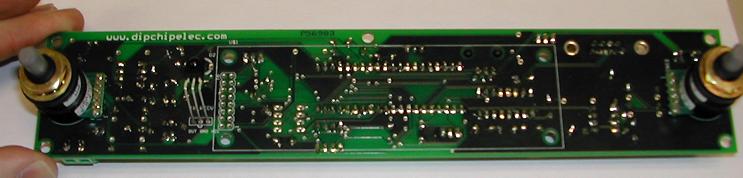

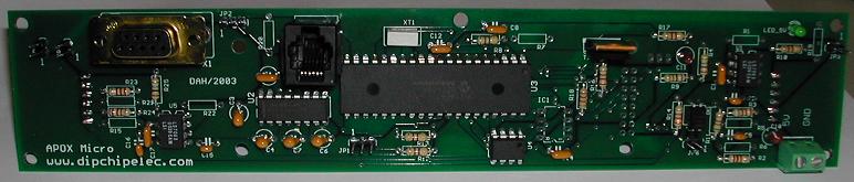

APOX/Firmware Update
Last Friday, Dale gave me his .HEX file for the APOX-IR firmware.
He told me when you can download this .HEX file over RS-232
to the board you will see the LCD display a message.
Well, I love challenges, So I began a quest to write an RS-232 based bootloader.
(I had already written a USB based bootloader, so I figured I'd
have no problems)
Well after struggling for 3 days on my RS-232 bootloader.
It finally worked. Man what a pain that was!
I was using Visual C++, so I thought I could use MSCOMM
(a simple OCX file) to control the COM ports. Well after finally getting the communications working properly. I found out that the MSCOMM does not transmit the hex byte 0x00. So a few bytes of from the blocks of flash memory were not getting transferred. (It think it had something to do with VARIANTS and CStrings conversion.)
Anyway, I got rid of MSCOMM, and used the normal CreateFile, Read,Open,Write, and now it all seems to work fine.
The LCD finally jumped into action. Yee Haw!
I built most of the APOX-IR1 board. But I was missing a few parts that Dale didn't leave me before he left for vacation.
I also received the APOX-2 Board today. It looks pretty nice (if I do say so myself) 😉 I'll try to build that up tonight.
-Craig

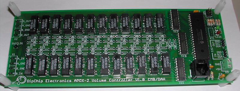

APOX-IS1 boards arrived today
The APOX-IS1 (Input Select Boards) arrived today.
Hopefully I can build them up after work, and possibly post pics by 6:30.
Hee hee. 🙂
Things are really starting to come together!
Hopefully we can get all of these boards talking in the very near future.
P.S. Jam, what does your picture mean?
-Craig
