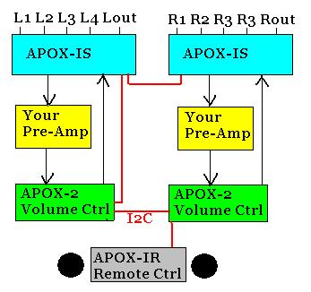

Overall system diagram
Hi guys,
Just so everyone understands the way the boards are laid out.
Here is a small system diagram.
Jam, I know the boards are not symmetrical mirrors, but the Left and the Right are completely seperated, so it is a good first step?
Also note that if you are using only single ended signals:
The APOX-2 has the two volume controls with seperated grounds. So you actually only need 1 volume control board.
I hope this helps,
Craig

Looking Good!
Craig,
It gets my vote. I plan to isolate both the right and left channel as much as possible. Only one small request if possible to leave a small space between the output connector and the inputs (cosmetics). 😉
Jam

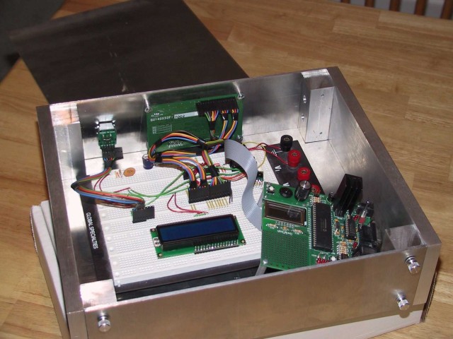

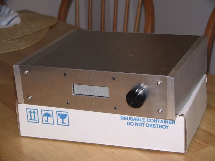

I recently finished my chassis for my project. size is 12" wide and 10" deep, with 1/2" sides, and 1/8" 6061 aluminum for the rest. I cut all the aluminum on my table saw with a 10" non-ferrous 72 teeth Freud blade, and had the machine shop at school cut the opening for the vfd.
Brian
The inside is quite ugly... my friend is working on the volume control circuitry now, using the burr brown pga2310, and I am just taking care of the control logic. I will eventually put connectors on the back, and make the insides prettier.
There are no screws visible on the sides or top. I used tapped blind screw holes in the sides, and the top is held on by the front and back, and easily removed by loosing the back with thumbscrews.
Brian
Brian, that’s one fine looking chassis! Are there dados cut to hold the top plate in place? I was wondering if it might tend to resonate or buzz if its snug fit or held in place by gravity.
