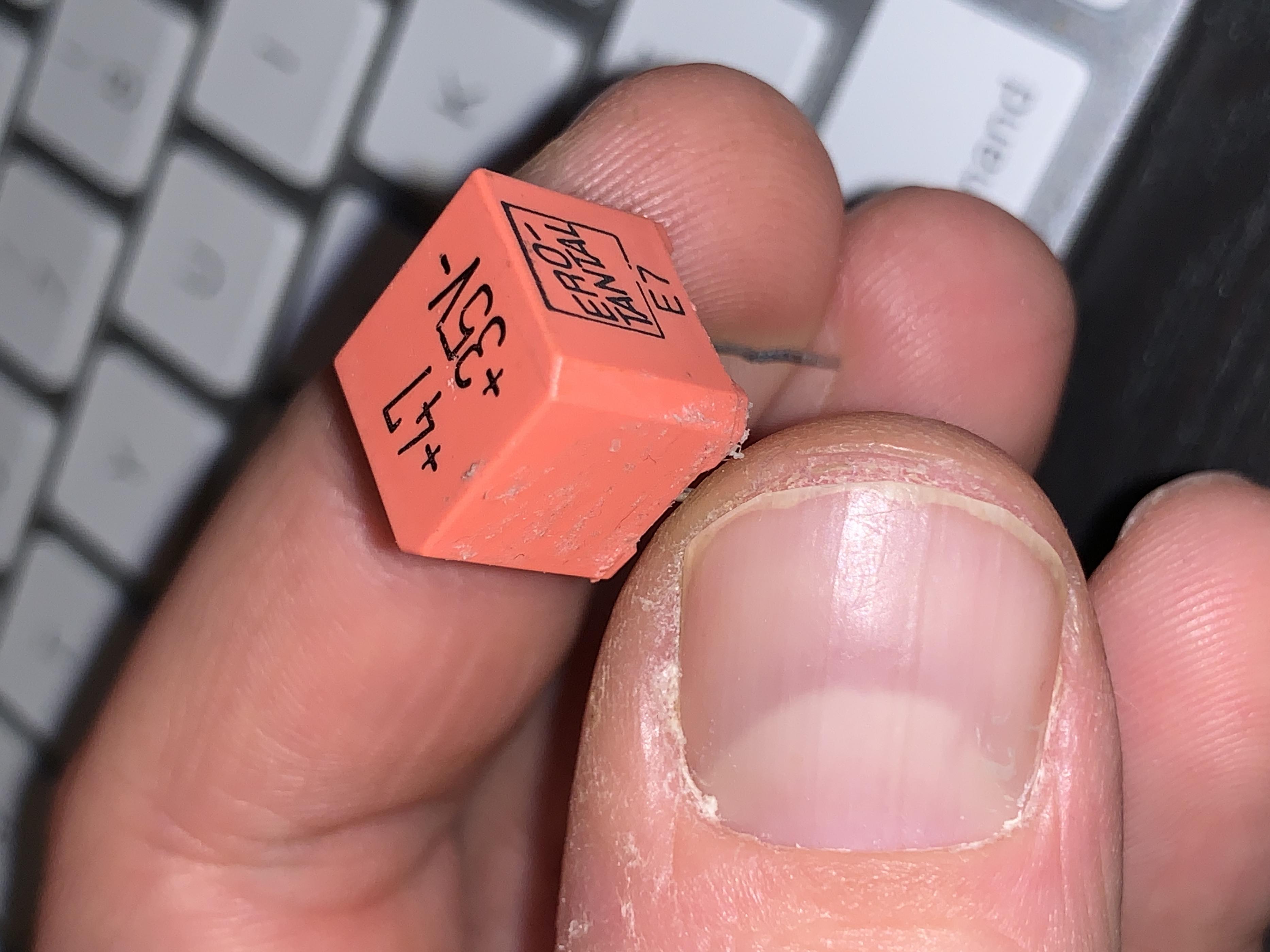

Found this in my cap storage;
Better against leakage than an electrolytic?
A film cap will always have much lower leakage than an electrolytic.

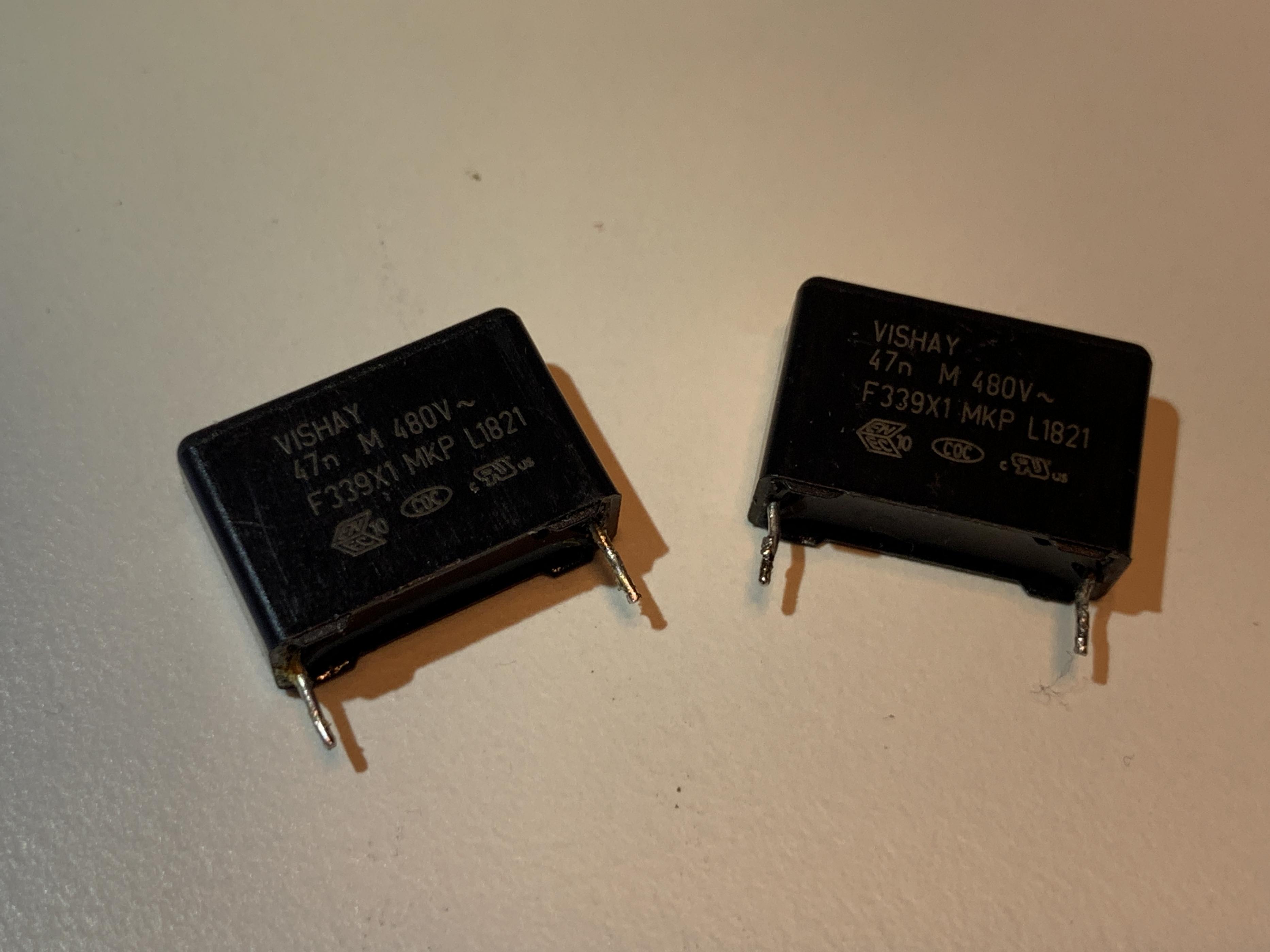

Problem fixed. Finally puhhh...
This 2 caps have failed and created lots of issues as we know.
One for the powerswitch and one for the relay.
Also found that the regulator 7805 somewhat leaked to the heatsink and to the input so threw in a
new one and isolated it from heatsink with siliconepad and plastic isolator around the screw.
They measured good in capacitance but when replaced with some Wima 0.01 X2 caps they amp started to work and delay is 2-3 seconds. More than enough.
Thanks to everyone involved!
