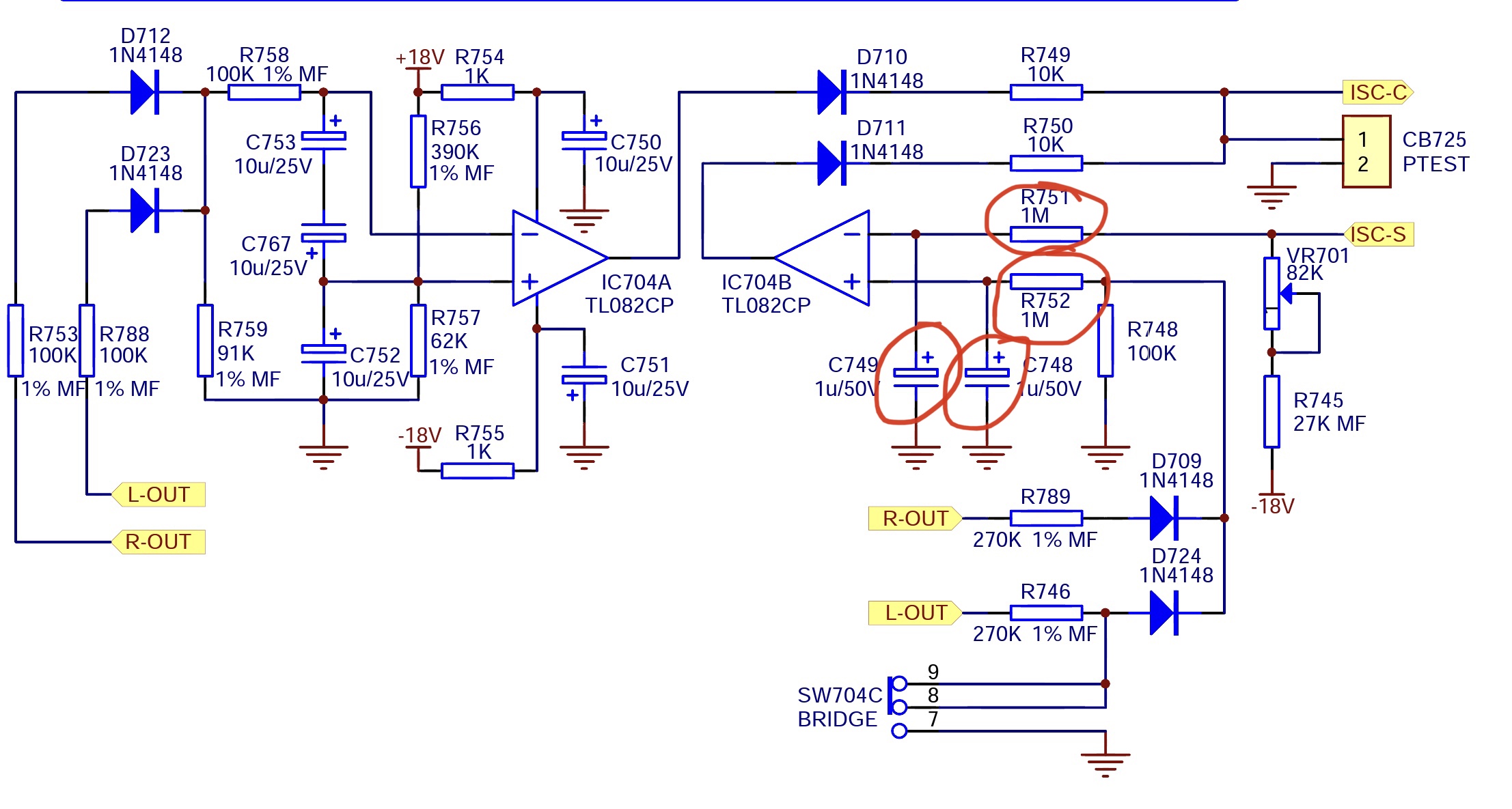

Anybody know how this ISC curcuit really works? In the manual says adjust to load 15w and 160w but whatever i get i get 1.445v (before recap too)
Heard the opamp could be the issue (cp082) but nothing happened when i changed. Also replaced the 1015/1815 around this and checked resistors but same. Could the thyristors be damaged? (Philips BT151-500R)

I've just quickly looked at the ISC and it seems to work by looking at amplifier output voltage at the speaker feed and also the current drawn and sensed across R716.
A low impedance load will draw more current for a given output voltage and so this current can be sensed and compared to a reference value (say for 8 ohms) and if the current is 'low' the ISC will turn on the thyristors and allow the high voltage full wave rectified but unsmoothed supply from the bridge (B702) to increase the rail voltage by allowing the thyristors to conduct and apply this voltage to the reservoir caps.
If the current increases relative to the output voltage (low impedance) then the thyristors are off and the amp operates on the lower rail voltage.
That's how it seems to work from a quick look at the circuit 🙂

One thing i found odd was that those 2 res. And 2 caps in the schematic is 100K v 10uf... colourcode confirms it and caps had it printed too. Wonder why Nad have adjusted that and not mentioned it. Somebody screwed upp in China factory hehe?

The diode cap and resistor combination (1meg/10uf) form a filter and sample/hold function with a short hold time. Values might be tweaked in production to prevent the ISC operating or dropping out when it really shouldn't. The 100k is always trying to discharge the caps (via the 1 meg). Maybe the circuit was cycling to much, perhaps with certain kinds of music.
