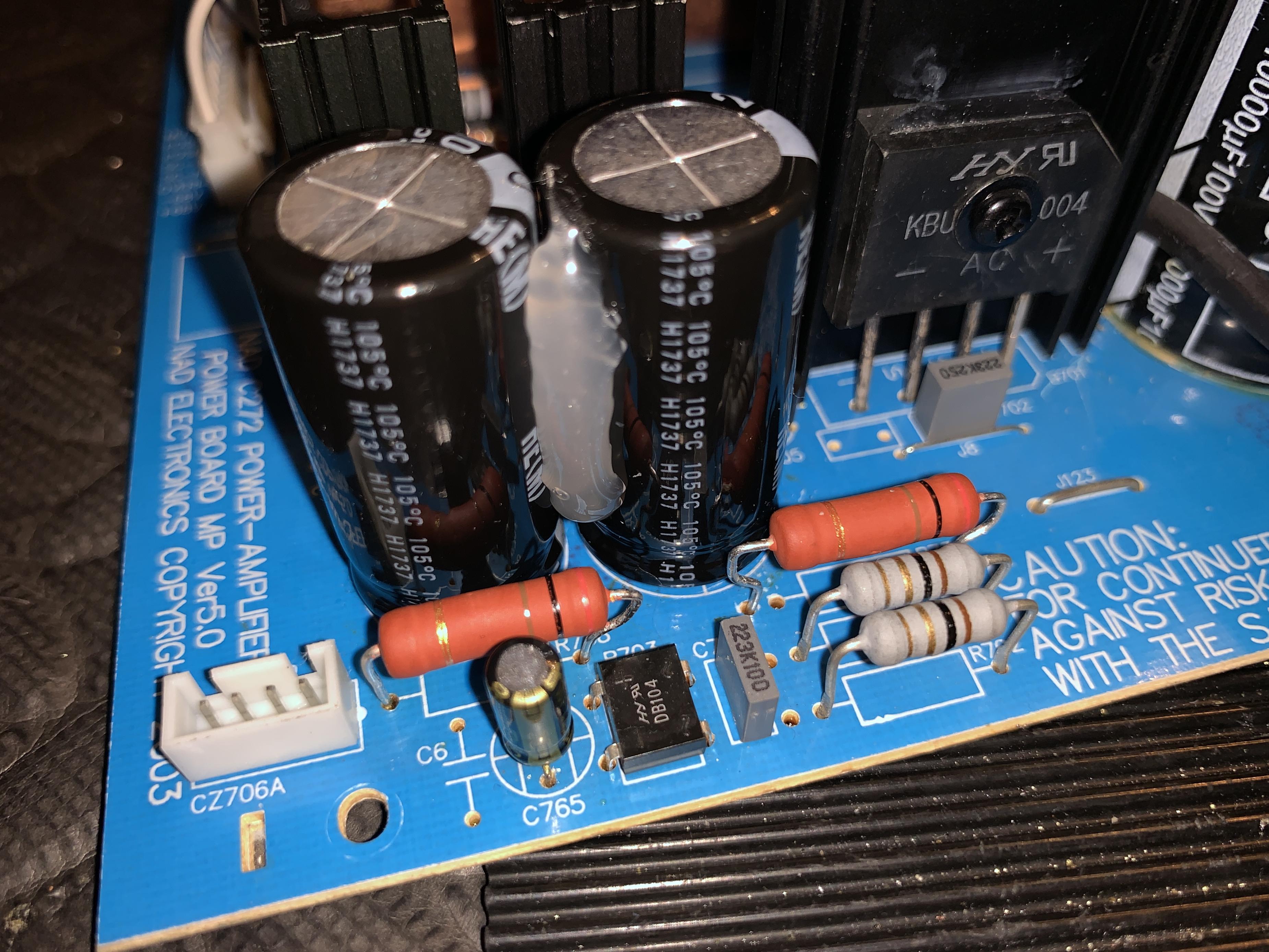

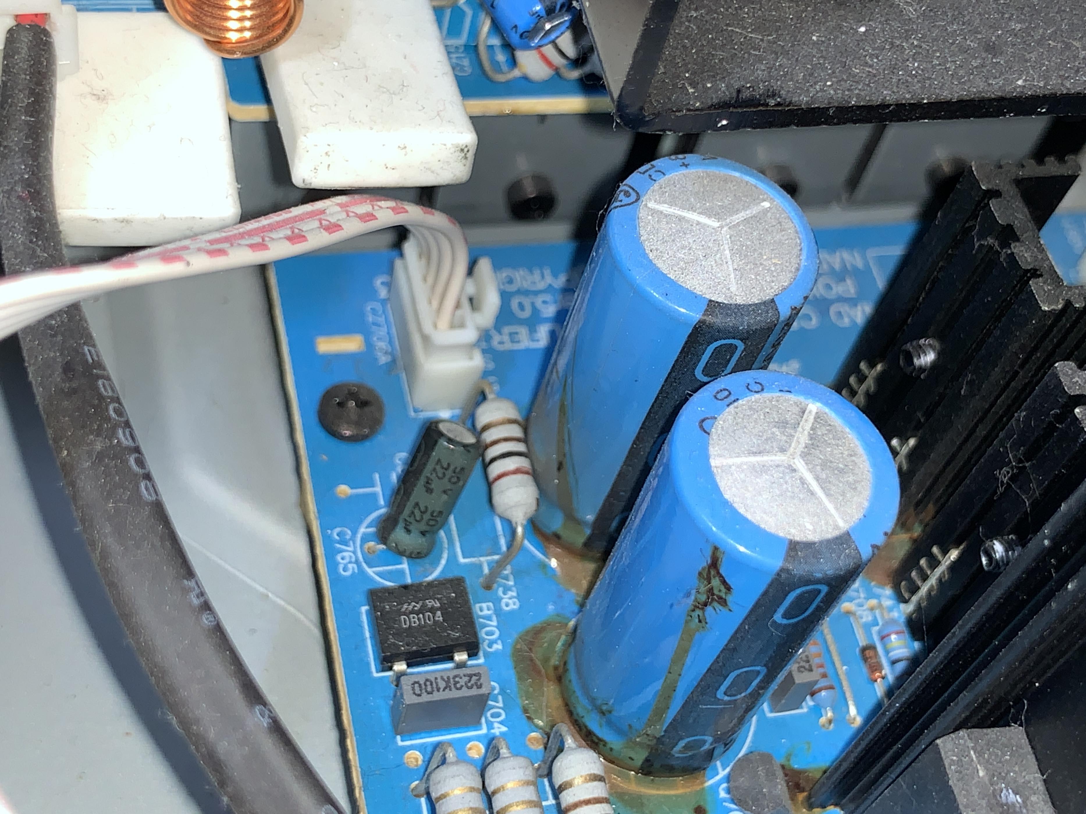

Anyway, yes the C765 is a Panasonic FM cap rated at 22uf/50v. And should be a good part. The orginal was really bad, measured about 2uf if i remember correct.
Before/ after pic
That's interesting if you actually measured the part and it really was down to 2uF because as I mention, that part is highly stressed.
It is stressed simply because the current draw of those rails will cause a large ripple component (voltage) to appear across the cap and so that leads on to the fact that a correspondingly high ripple current flows in the cap... high in relation to its small size... and that causes local heating and deterioration over time.
Why not fit a 2.2uF in its place and see if the unit behaves as it once did. You say the 'fault' occurred after the recap and now go on to say that a vital part that was replaced was effectively non-functional as proved by measurement.
So put it back to that state and retest 🙂

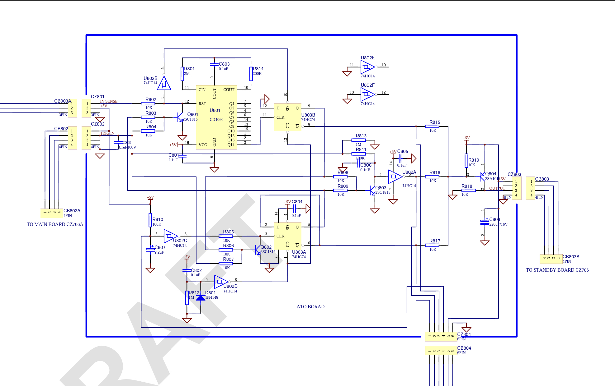

Can it be something with this ”Ato” Board? Seem to control everything and the switch on the front as well. Switch comes in on the 6-pin (bottom) and pin 4. And yes it’s also recapped.

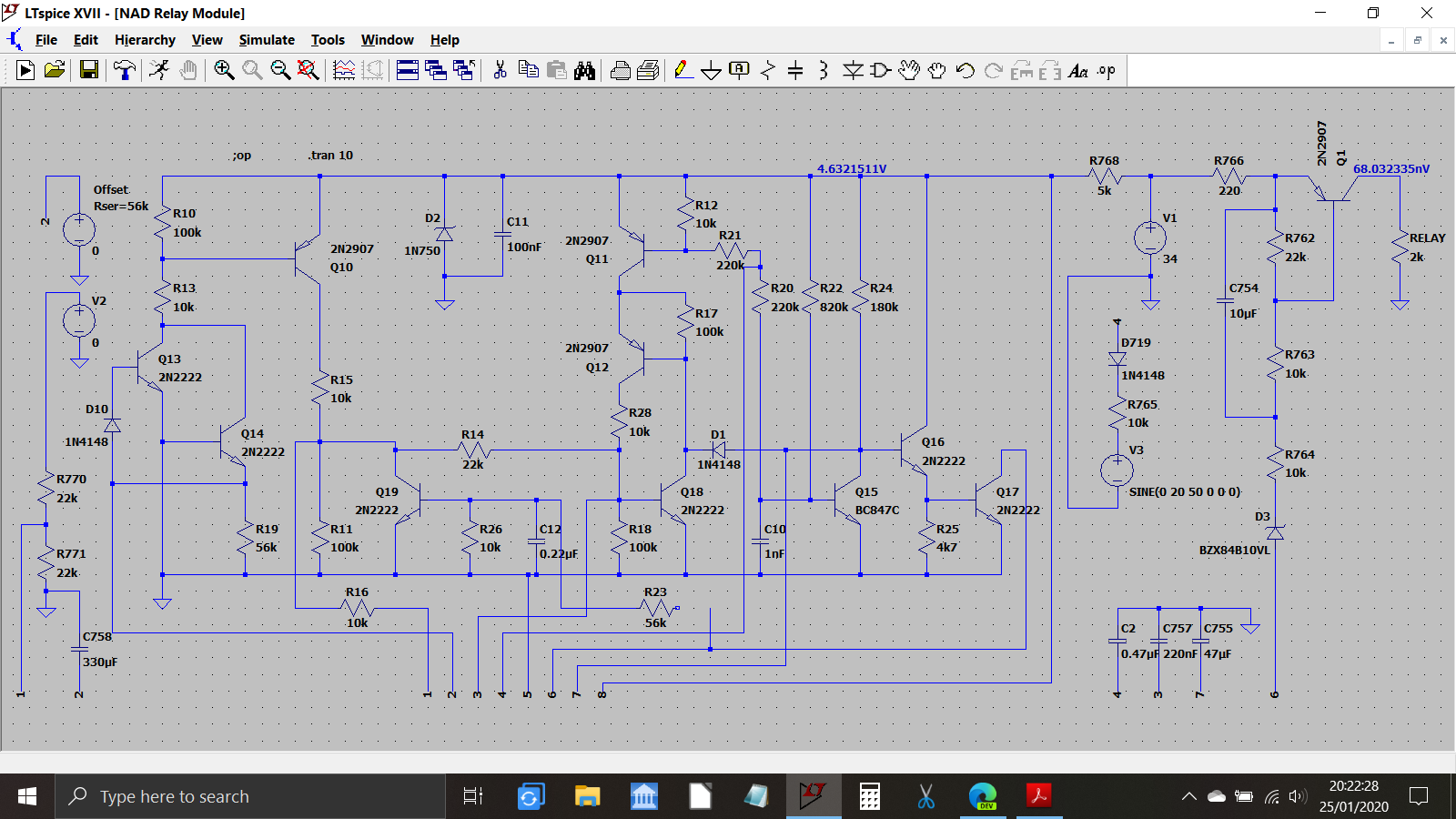

This is a crucial bit of information... and I just can't figure this out... it doesn't seem right.
If we look at the circuit we see that relay driver Q715 is normally OFF. That means no voltage on the relay coil and so no speakers connected.
To turn on Q715 we pull the base toward ground which means that Zener diode D718 anode (bottom end of it) has to be grounded.
If pin 6 is not connected then I can't see any way the transistor can be turned on. The line marked PT-Out is presumably 'protect out' and does indeed go to Q718 which appears to be used to switch other functions such as muting.
So that is a real puzzle. PIN 6 not connected doesn't sound correct. Are you sure you are reading the pins from the correct end. Look at part references, don't rely just on one board marking.
If pin 6 were connected then the circuit would behave as intended. I've even run a simulation of the module and it seems to give a 2.5 second delay but there is a problem... the logic levels are 'wrong' to drive the relay driver transistor and I can see why. It is because of R23 in the module pulling the driver transistor base to ground via Q19 and R26.
That's as far as I have got 🙂

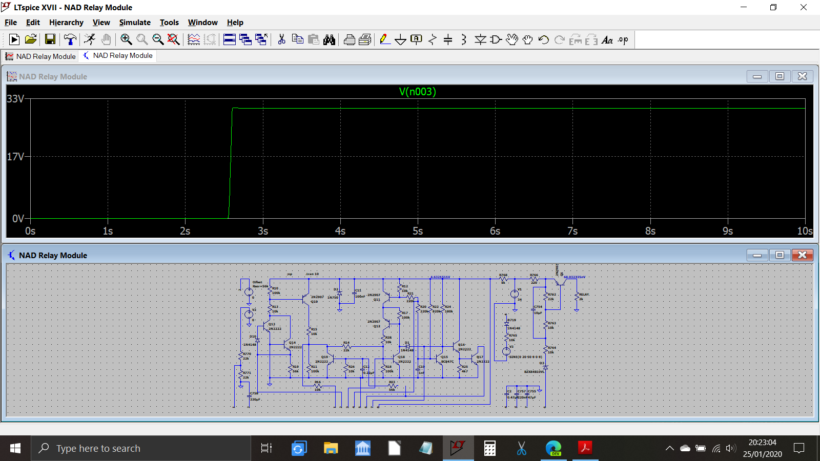

Here is the sim showing the relay closing after 2.5 seconds (with R23 not in circuit). The second image shows the relay voltage coming up to around 33 volts.

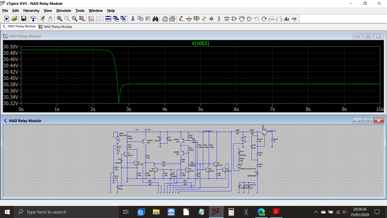

Third image is with R23 connected. It is keeping the driver transistor in conduction all the time. The module still switched correctly, its just the transistor is being held on.
I'll look at the resistor chain and Zener tomorrow. The Zener is a common tactic used to translate between logic levels.
Edit... I've attached the .asc file if anyone want to have a play.

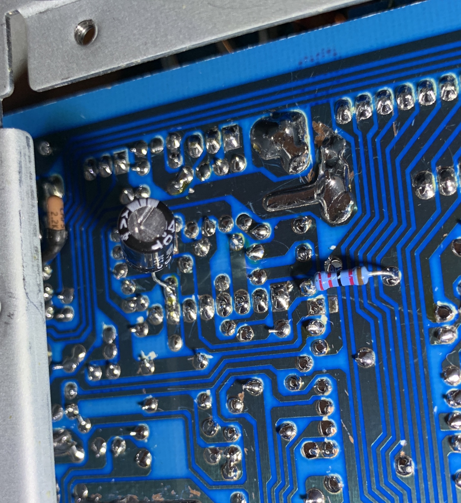

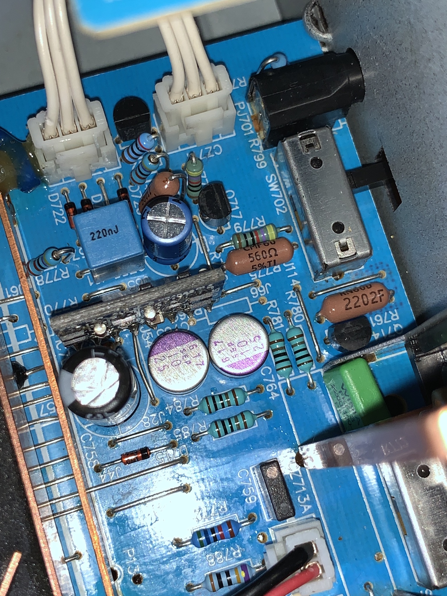

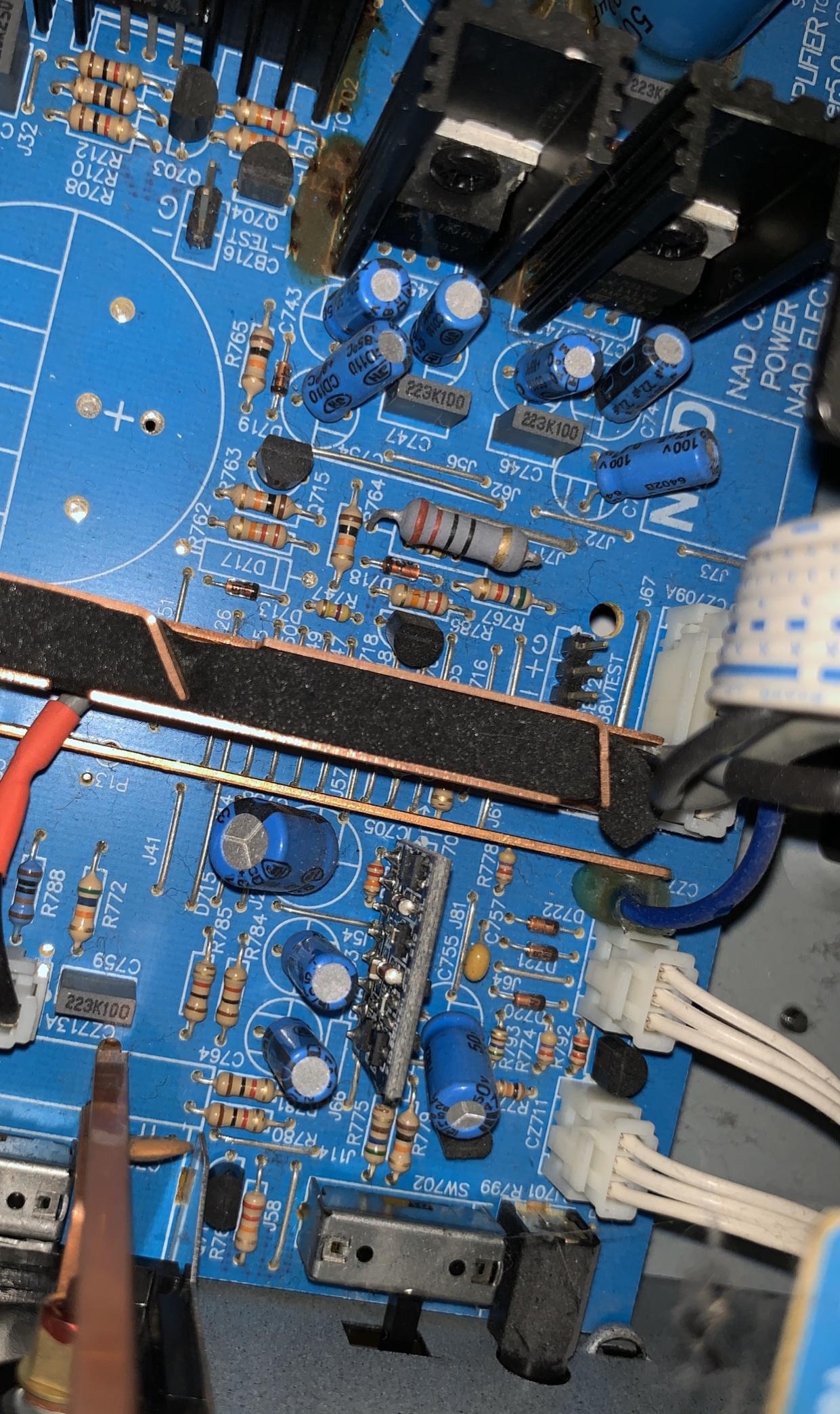

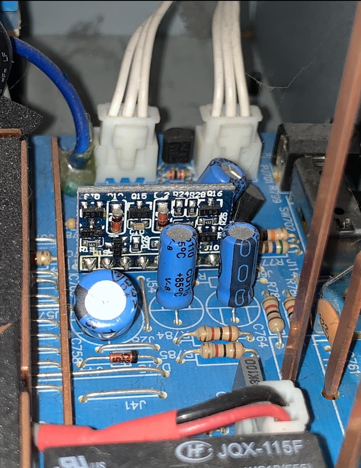

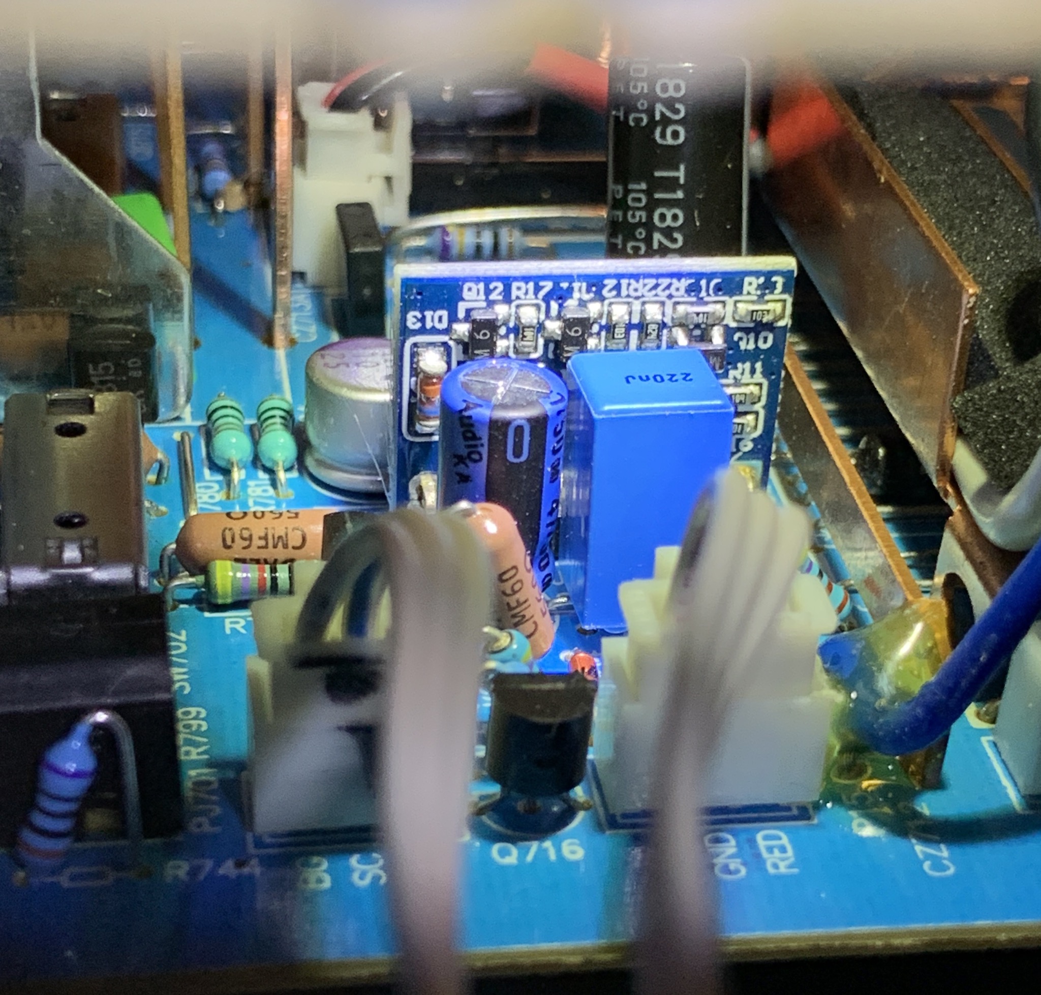

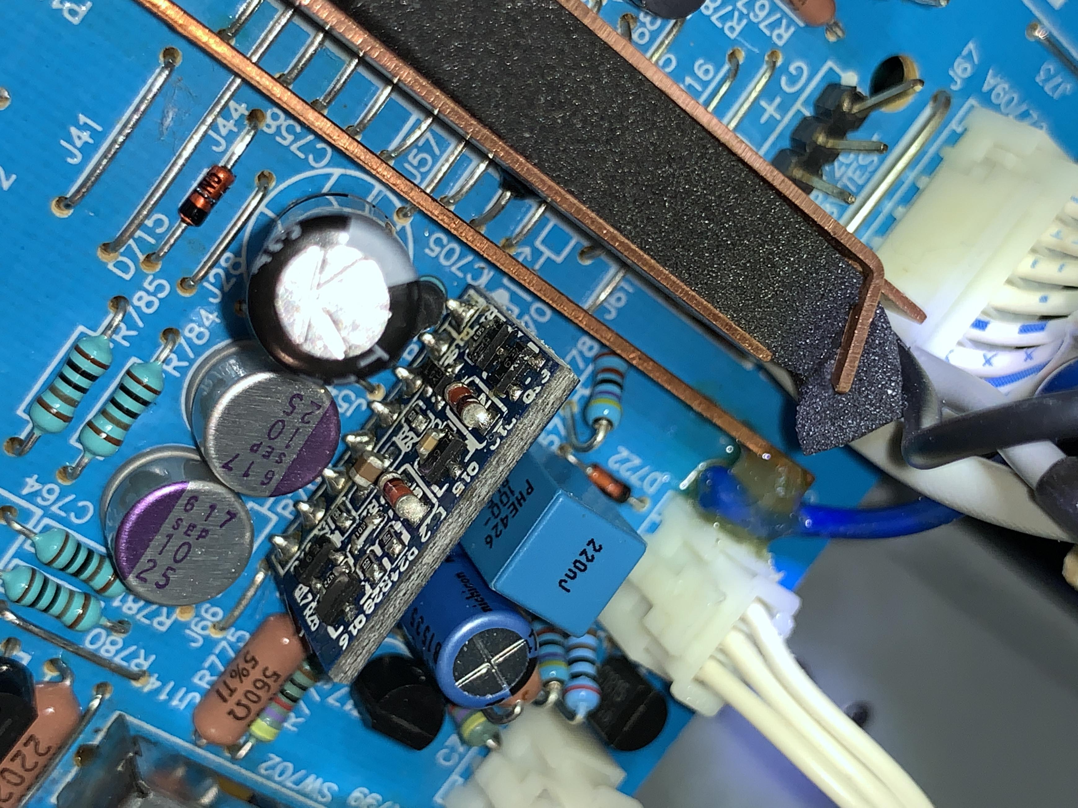

This pics are taken first time i ever opened this amp.
As you can see there is a pad for a smd res or cap but shows that it just got flown in factory so nothing seem to have fallen off.
2 pics from above with the module and the surrounding components including some of the +/-18v supply
This is how it looks now (except that extra 47uf cap on pin7 underneath)
Very hard to take a good photo on shiny tin i noticed 🙂

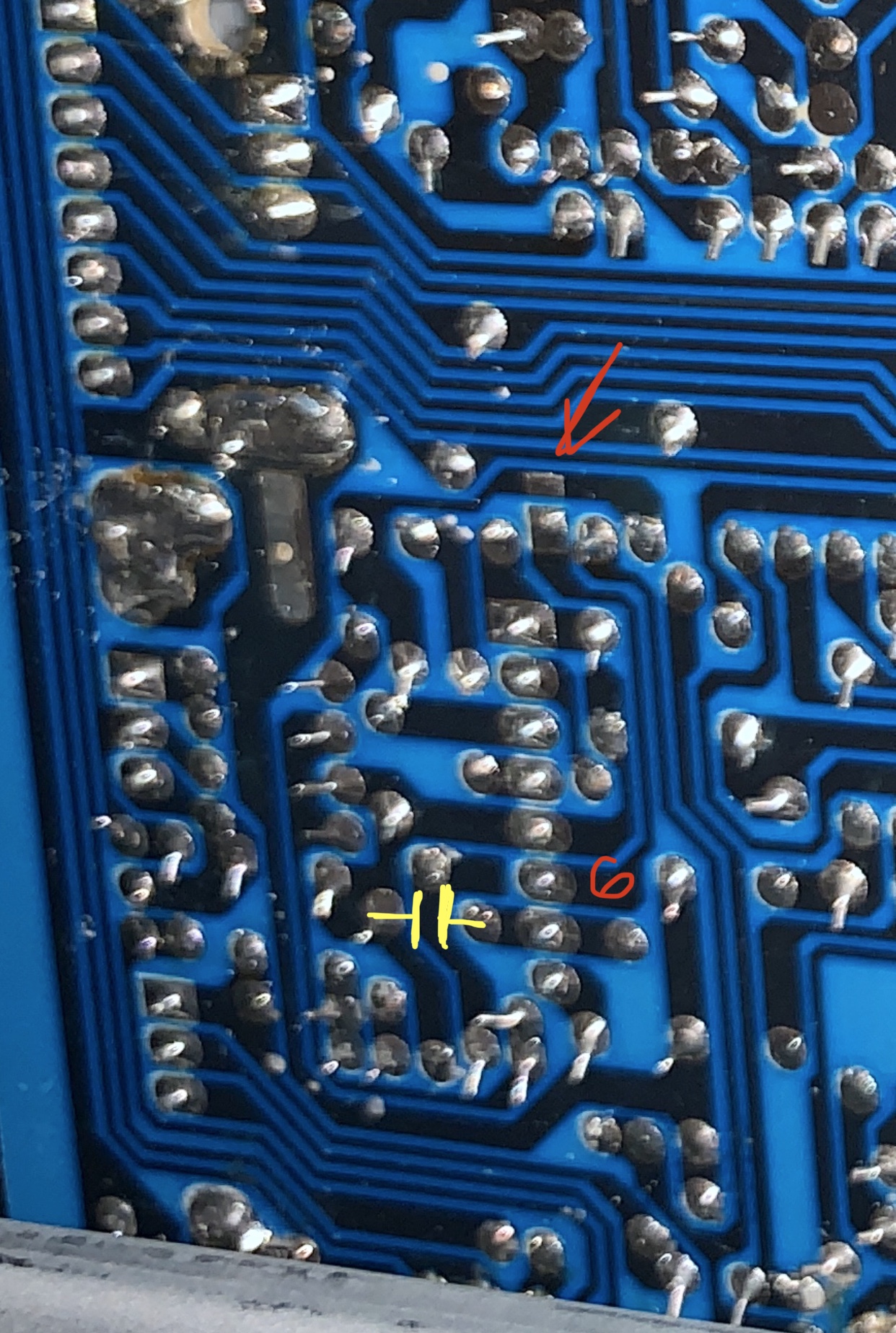

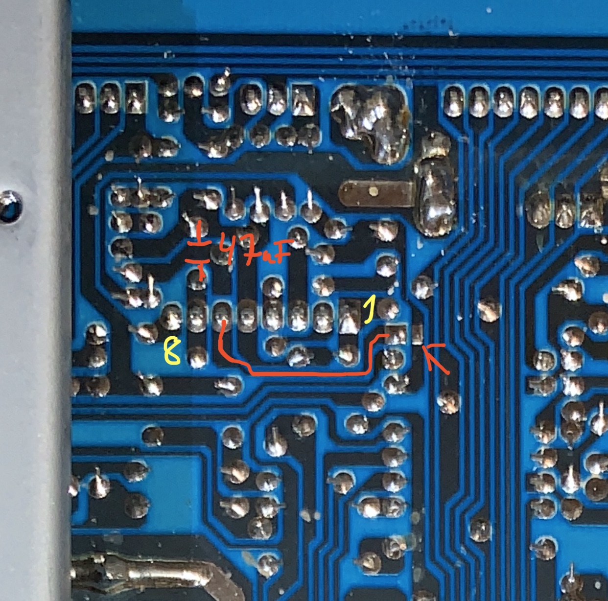

Thanks Mooly for your time consuming calculation
I was thinking i show you myself. Maybe my 41 yr old eyes is bad 🙂

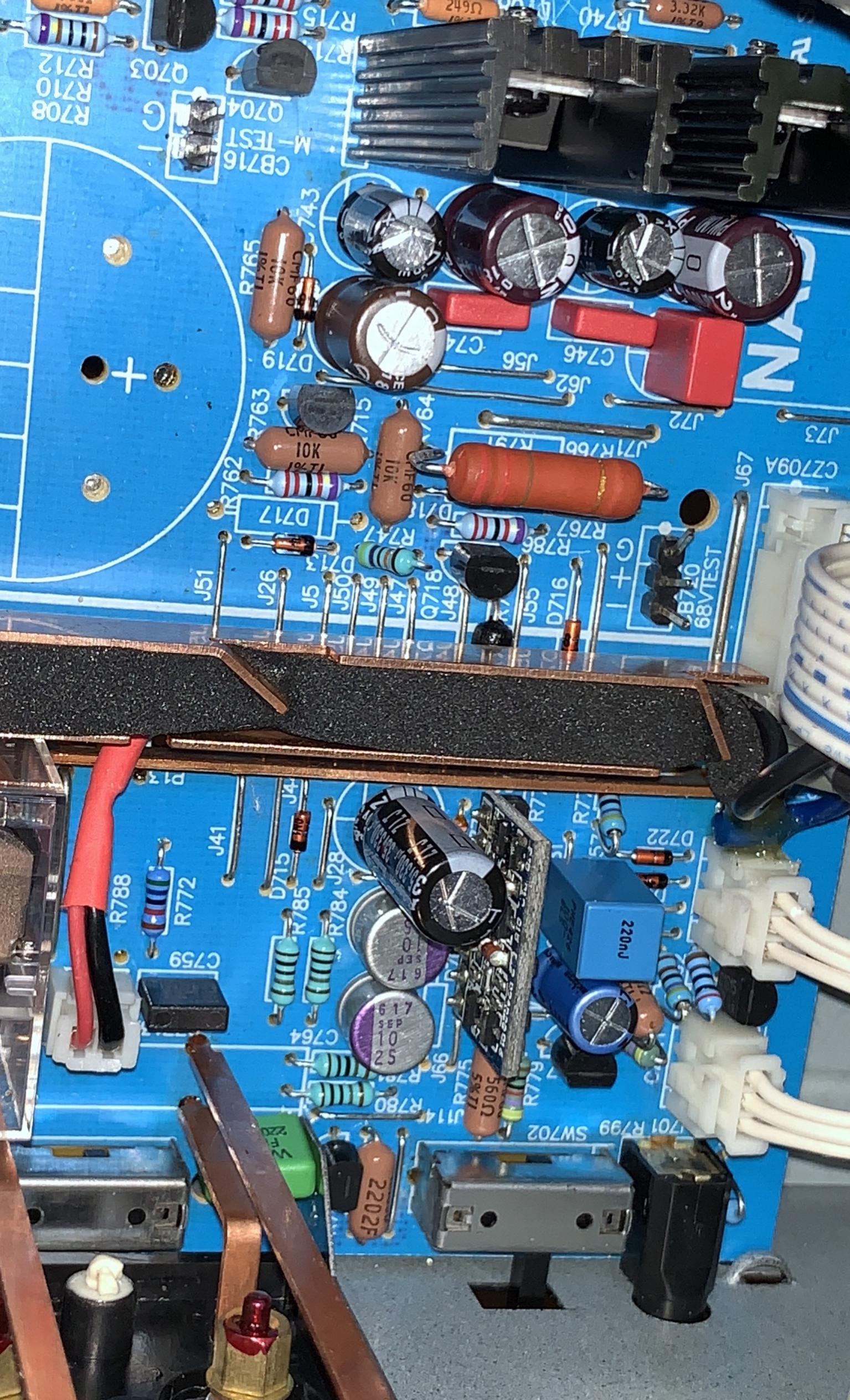

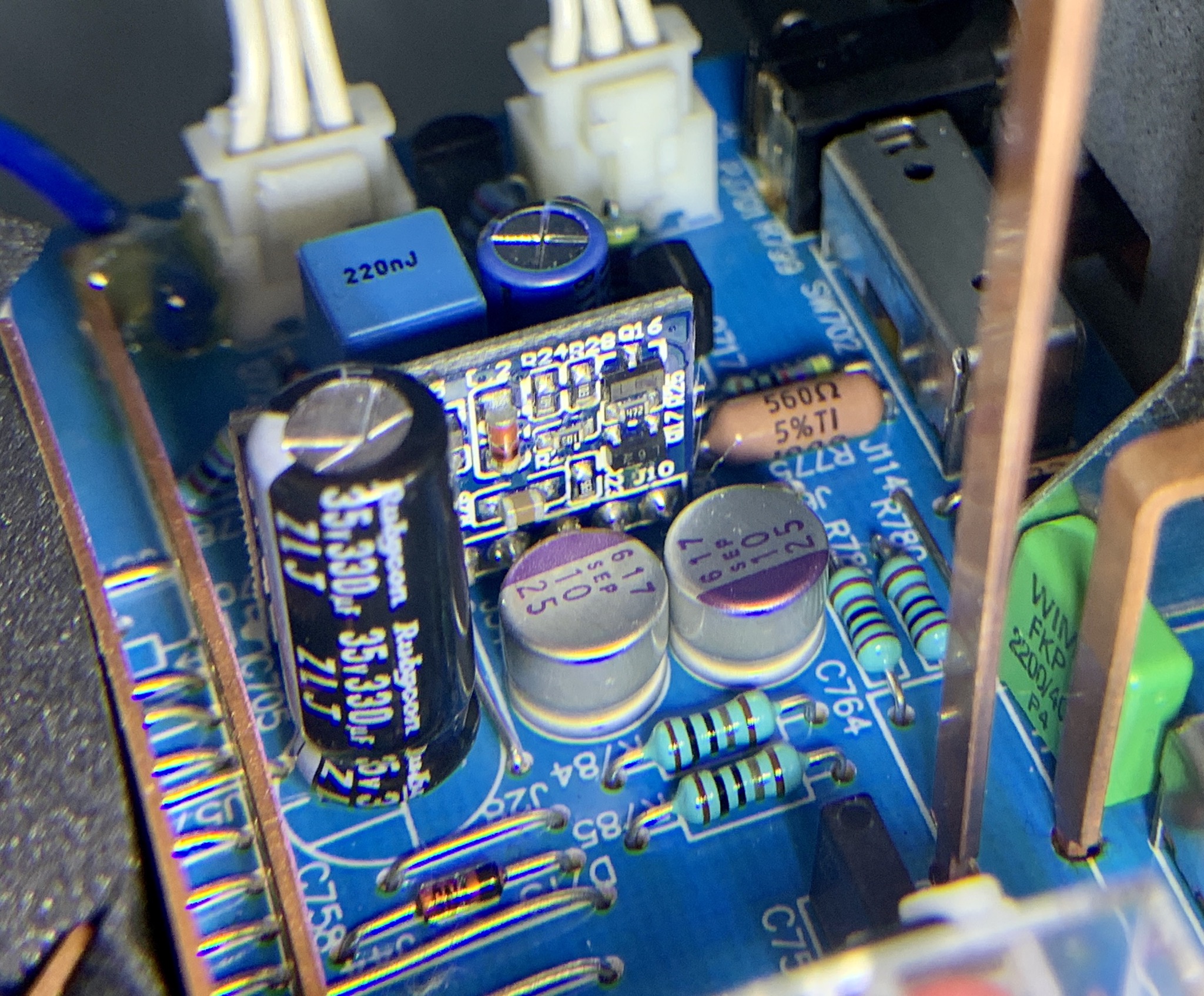

Hmmm. Nope, that definitely looks not connected to me as well... and that just can not be with the circuit as drawn.
As mentioned, the bottom end of the Zener must be able to pull the base of transistor Q715 to zero volts for the transistor to turn on.
Is there another path?
Not that I can see. The PT-Out line goes via a 100k to Q718 base. In other words Q718 also expects that line to switch. And that has to be via the modules 'Open Collector' output on pin 6.
On the right hand pad that is open circuit I can see a small arc (a scratch) on the board as if a soldering iron has swept over there. Is it possible you have inadvertently caught that pad with a hot iron and removed the solder?
Does the right hand end of that pad go to the Zener as expected?
(I figured the logic levels out... I had missed out R767 which is a pill up resistor. So it does all work correctly)
