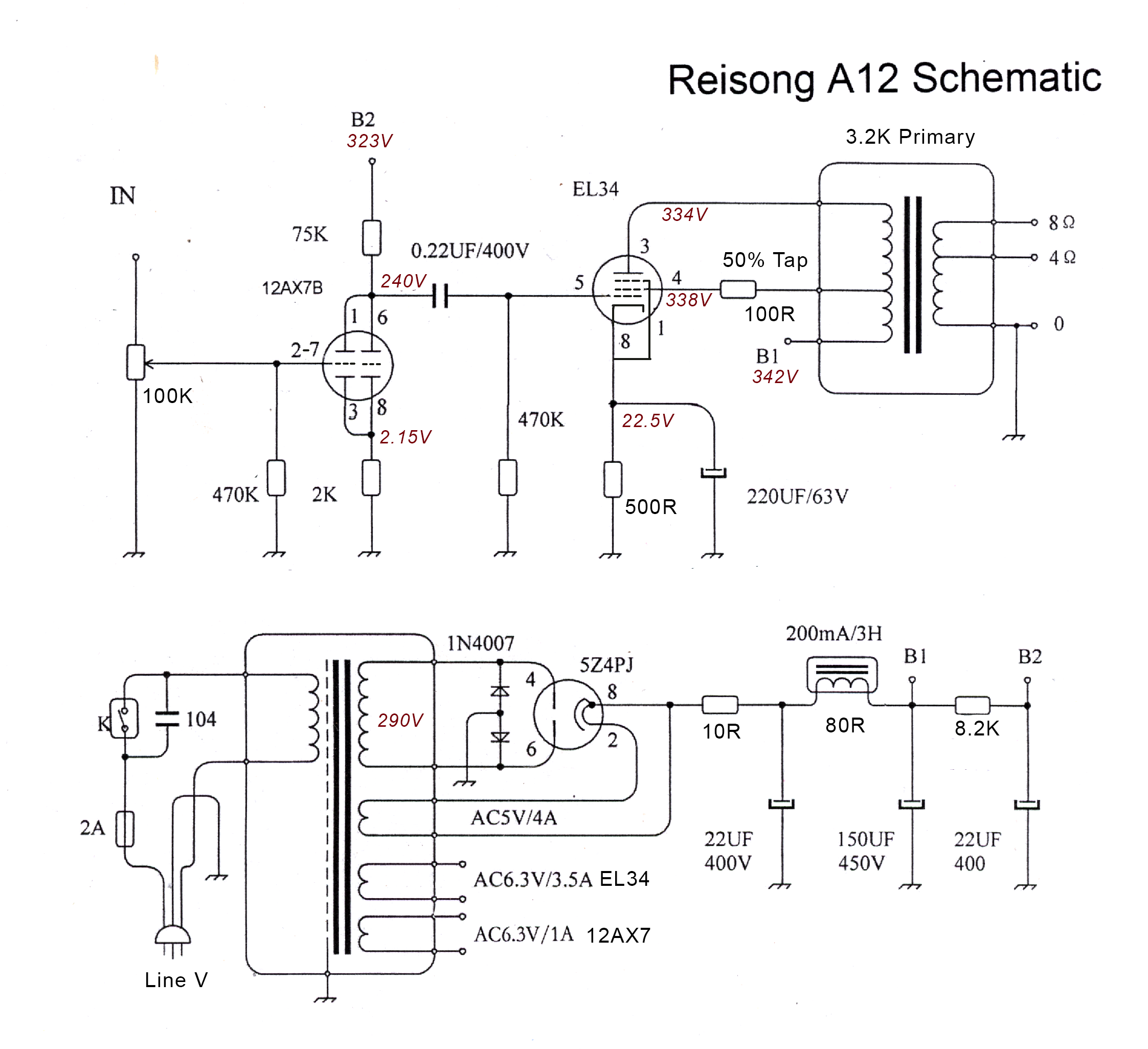

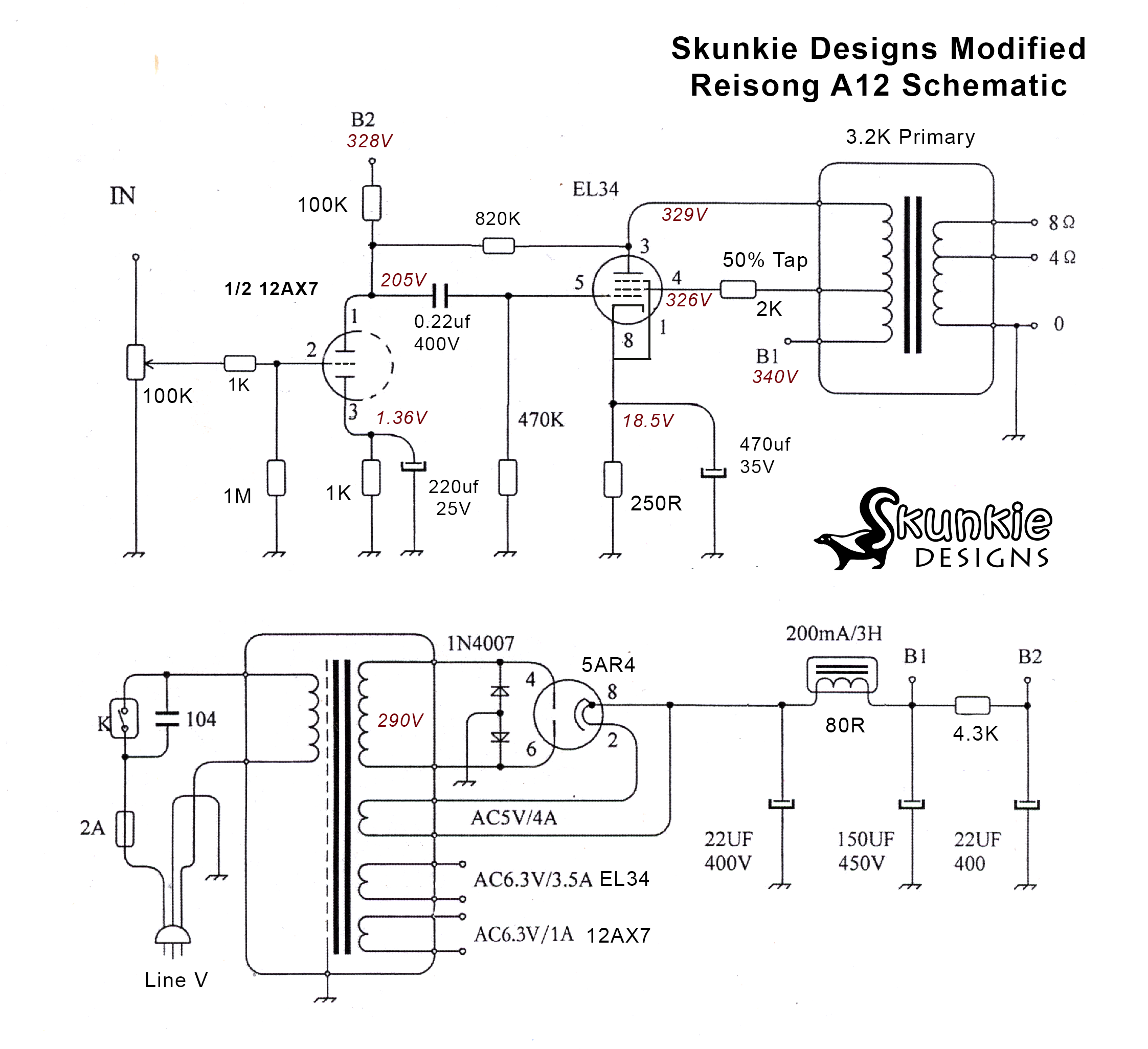

I did finally got this amp to behave with the iron it came with.
I was able to reduce the distortion 10 fold, get an honest 5W of power and measurably extend the frequency response. Listening to it, the bass exists, where is was just totally missing before and it's very pleasant to listen to now without needing a powered sub and $3000+ 100db speakers.
Out of the box I wouldn't recommend this as a purchase, but with these mods applied, it's now a good sounding amp, especially at this price point.
Here are the before and after schematics, and links to the video testing and two others covering the DIY mod process. A handful of passives and a different rectifier tube, that work together to change some key operating dynamics, transform this amplifier!

stephe,
If you test the harmonic distortion at 40Hz, and compare it to the harmonic distortion at 1kHz, it will become quite easy to conclude whether the '50% UL tap' output transformer is push pull, or is single ended with an air gap.
At 1 or 2 watts and 40Hz, a small push pull transformer will look awfully saturated and non-sinusoidal, but not so bad at 1kHz.
I took a Dyna A470 push pull output transformer, and removed all of the interleaved E's and I's (laminations).
Then I lined up all the E's on one end, put a layer of Kapton tape over the open ends of the E's, and then put all the I's on the top of the Kapton tape (The tape is the spacer of the 'Air Gap').
That makes the push pull transformer into a single ended transformer.
The complete end to end primary winding was used, B+ to Plate.
There is less primary inductance than with interleaved E's and I's; but with the 'air gap', the laminations are not saturated from the 50mA DC quiescent plate current.
With negative feedback from the 16 Ohm tap to the cathode of the Triode-wired EL34, the overall amplifier low frequency response was -3dB at 15Hz and 60kHz, relative to 1kHz.
Later, I used the same 'air gapped' A470 with a KT66.
I connected B+ to one primary plate lead, the output tube plate to the other primary plate lead, and a 100 Ohm resistor from the primary center tap (50%) to the output tube screen.
That made it a 50% "Ultra Linear" circuit.
This is very interesting!
The OEM output transformers on my similar A9 produced awful looking sine waves but had attributed this to their smallness and quality issues. I have no idea what the UL tap percentage was and have long ago replaced them with Hammond iron.
OK this is a total win for zero effort. I ordered a pair of cheap JJ 6V6S tubes, replaced the EL34 tubes running at 52% dissipation with these 6V6s tubes that are running at 90-92% dissipation, and then moved the 8 ohm load to the 4 ohm tap to get the reflected impedance close to what a 6V6 wants (I know this is less than ideal...), the usable power doubled and the distortion is less than 20% of what it was. I did try running the EL34 off the 4 ohm tap and saw a very minor, about 1/2% reduction in THD.
We now have 1W at 1% (instead of 6%), 2W at 1.5% (instead of almost 9%) and 4W at 4% (God only knows what % with the other tubes at 4W). Again, not changing anything else other than these 2 output tubes. It still has weak bass (OT issues?) and I believe can be further improved but this confirms the tube bias for the delivered EL34 is so far off, anything else done without addressing that, such as changing to a KT66-77 or different rectifier tubes/other tube rolling, isn't fixing the problem to any measurable degree. Changing these 2 tubes turned this from a really bad sounding amp IMHO to something decent and maybe with a coupling cap change and a few other minor tweaks will be even better. This does confirm my belief that an SE amp wants to have the output tubes run hard to sound good!
I still want to try some internal mods to use 7591a tubes biased correctly, which should work fine with the 3.2K OT using the correct taps, possibly try setting up the EL34 tubes correctly and then tinker around with the driver tube setup/coupling caps etc., but for anyone not interested in going inside the amp, some 6V6 tubes are the ticket! Below are the two THD vs power curves.

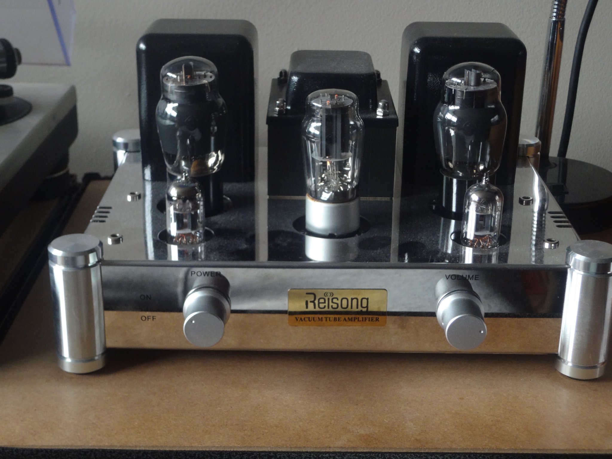

Got the tubes today, the seller John was a great guy to chat audio gear with. I've been playing the amp all day,looks and sounds great and nothing has blown up yet, lol.
Highly doubt they are great, and of course there is no way of knowing what any of the parts are rated at, but is sounds massively better.

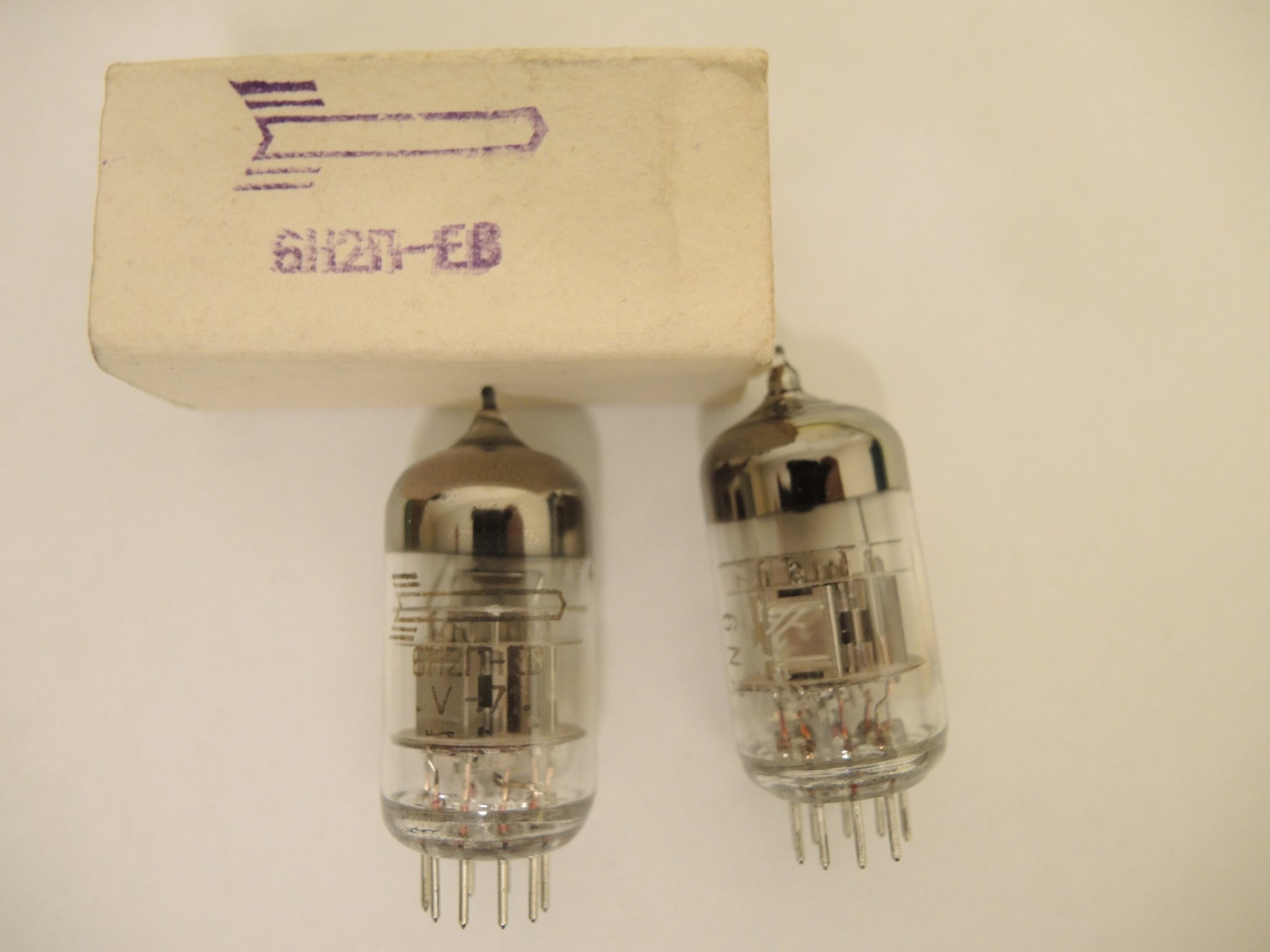

Hi Stephe, I have a A10 with the stock 6N2 pre drivers and the stock JJ-EL34 outputs. I got the amp about about 2 years ago and it sounded totaly flat. I tried it out a few months ago and found it was not too bad for the first 10 minuets but got more flat the longer it was on. I was going to use if for "decoration" it was that bad, until I saw your youtube video on the mods. I did not have all the parts in hand but I found a 1K resister and a 100uf cap and added them to the EL34. Bang! The amp was like a totally new amp. For anyone who has the A10 you can in 5 minuets make it into a great sounding amp. I now have all the parts here to do the full mod.
My real question is regarding the input tube and PS. For now I am planning to stay with the 6N2 pre drivers. I got in the Rocket 6N2P-EV and was hopeful they would work well. After install them they worked but my 60Hz hum which was quite low is now around 3 times louder.
The bass from the Rockets is way better which is needed ,because my bass is crap right now, but the hum makes them unusable. I don't know if its a mismatch or just the PS.
I have the new 5AR4 rectifier tube on the way and plan on going through the whole PS circuit. I was going to be cheep and leave the stock tube in and that's why I did not increase the EL-34 current much. I see the other guy posted the schematic of the A10 and it uses a 330uf+22uf+150uf. Ours came with the 22-150-22uf. I'm going to guess that the 330uf will be OK with the 5AR4.

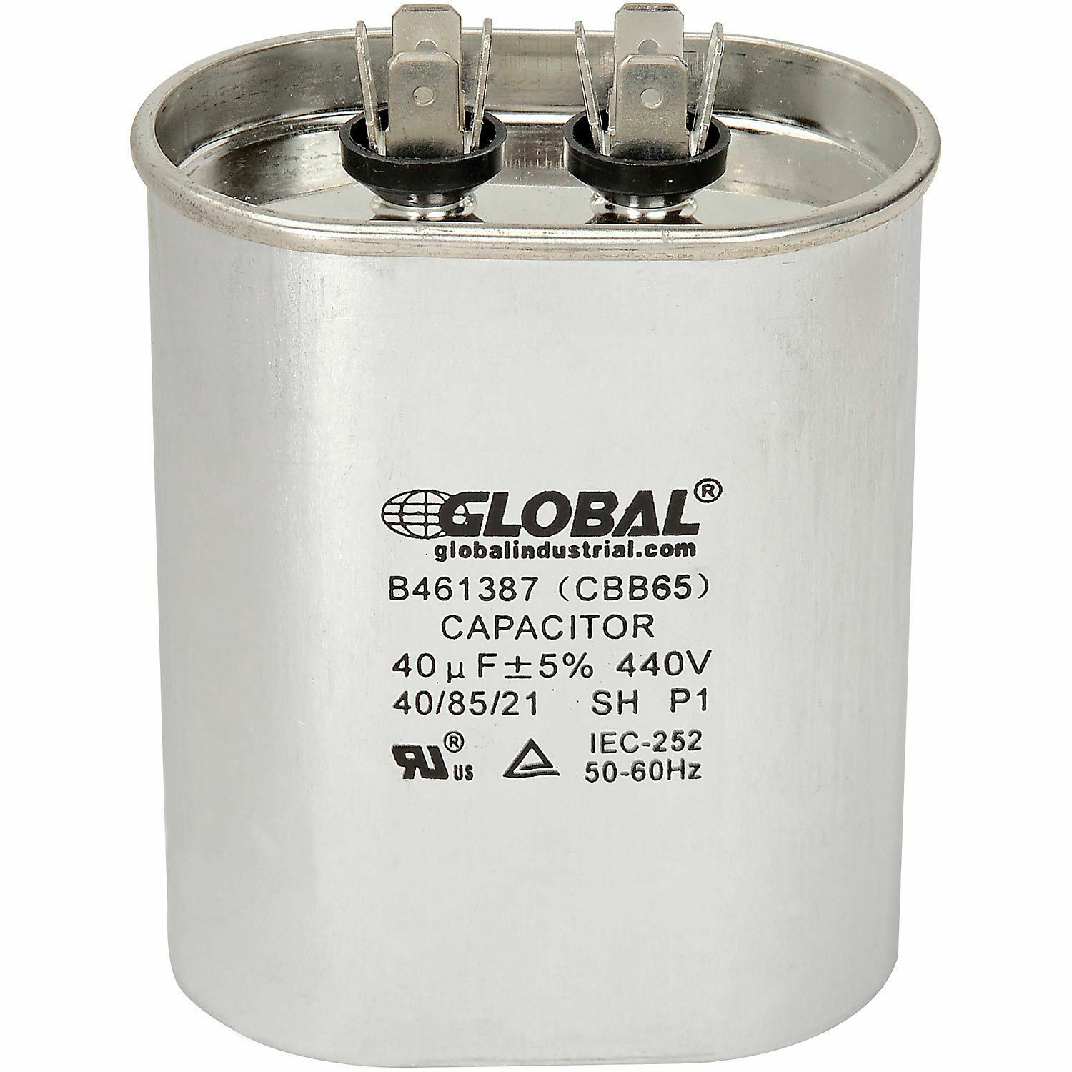

The real question is my choice of filter caps I plan on adding. Its a 440v run cap 40uf. I think I can fit it in the box. Has anyone used a run cap for a PS filter cap? I'm thinking the impedance is lower than a electrolytic but I can't fine a specification.

The first cap after the rectifier needs to be under a max of 60uf, I like to keep it 40uf max. And a run cap works fine for PS filtering, just make sure it is a run cap and not a start cap!
