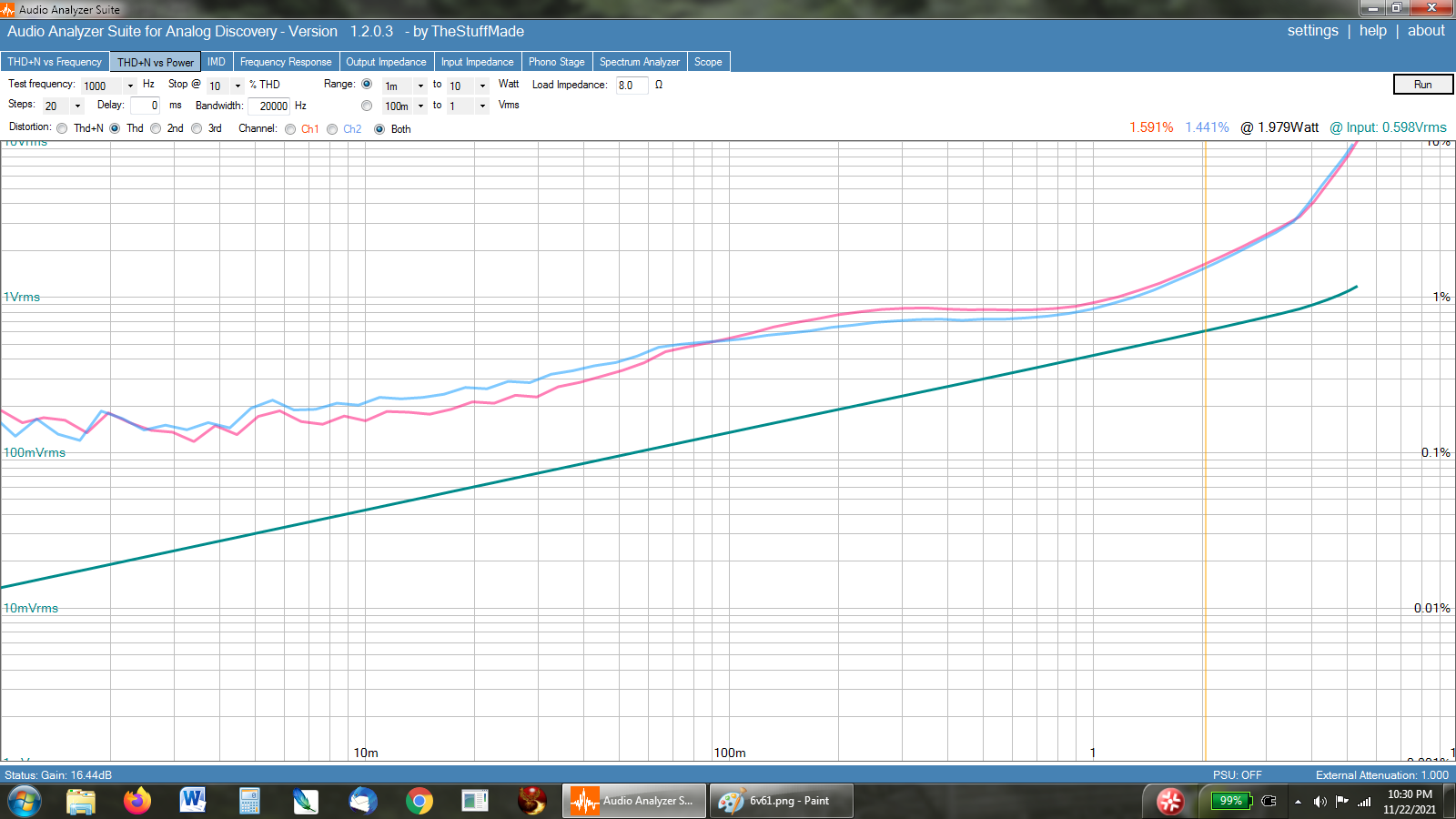

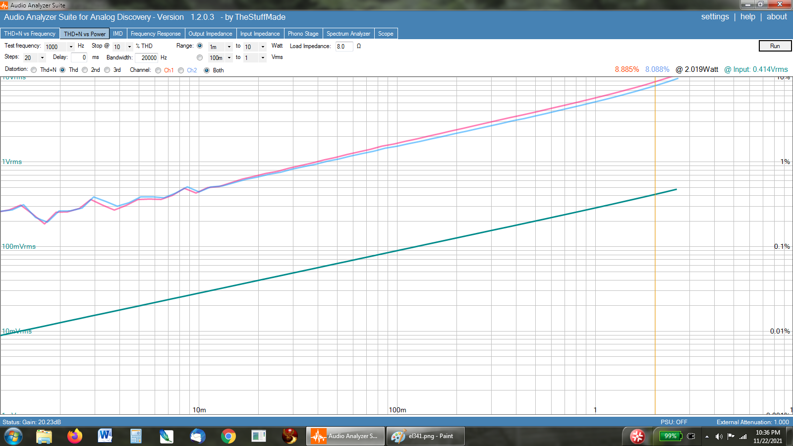

OK this is a total win for zero effort. I ordered a pair of cheap JJ 6V6S tubes, replaced the EL34 tubes running at 52% dissipation with these 6V6s tubes that are running at 90-92% dissipation, and then moved the 8 ohm load to the 4 ohm tap to get the reflected impedance close to what a 6V6 wants (I know this is less than ideal...), the usable power doubled and the distortion is less than 20% of what it was. I did try running the EL34 off the 4 ohm tap and saw a very minor, about 1/2% reduction in THD.
We now have 1W at 1% (instead of 6%), 2W at 1.5% (instead of almost 9%) and 4W at 4% (God only knows what % with the other tubes at 4W). Again, not changing anything else other than these 2 output tubes. It still has weak bass (OT issues?) and I believe can be further improved but this confirms the tube bias for the delivered EL34 is so far off, anything else done without addressing that, such as changing to a KT66-77 or different rectifier tubes/other tube rolling, isn't fixing the problem to any measurable degree. Changing these 2 tubes turned this from a really bad sounding amp IMHO to something decent and maybe with a coupling cap change and a few other minor tweaks will be even better. This does confirm my belief that an SE amp wants to have the output tubes run hard to sound good!
I still want to try some internal mods to use 7591a tubes biased correctly, which should work fine with the 3.2K OT using the correct taps, possibly try setting up the EL34 tubes correctly and then tinker around with the driver tube setup/coupling caps etc., but for anyone not interested in going inside the amp, some 6V6 tubes are the ticket! Below are the two THD vs power curves.

Good to know !! ThanksOK this is a total win for zero effort. I ordered a pair of cheap JJ 6V6S tubes, replaced the EL34 tubes running at 52% dissipation with these 6V6s tubes that are running at 90-92% dissipation, and then moved the 8 ohm load to the 4 ohm tap to get the reflected impedance close to what a 6V6 wants (I know this is less than ideal...), the usable power doubled and the distortion is less than 20% of what it was. I did try running the EL34 off the 4 ohm tap and saw a very minor, about 1/2% reduction in THD.
be careful with the heating voltage on the JJs, too high a voltage is one of the very good ways to make them fail quickly
OK this is a total win for zero effort. I ordered a pair of cheap JJ 6V6S tubes, replaced the EL34 tubes running at 52% dissipation with these 6V6s tubes that are running at 90-92% dissipation, and then moved the 8 ohm load to the 4 ohm tap.
So just to be clear, there was no modification of any internal parts or values to do this? And the 4 ohm tap is accessible at the rear?
So in other words, a user with zero technical knowledge can just substitute a pair of 6V6 and change the speaker lead to the 4 ohm plus 0v?
This would be worth mentioning on other forums for non-technical users who happen to have this model.

Yes on the UL tap. It's a 3.2K OT with both 4 and 8 ohm speaker taps and a 50% screen tap.
There is no negative feedback anywhere.
Yep, no internal mods. The bottom doesn't need to come off the amp and the 4 ohm taps are there on the back out of the box.
