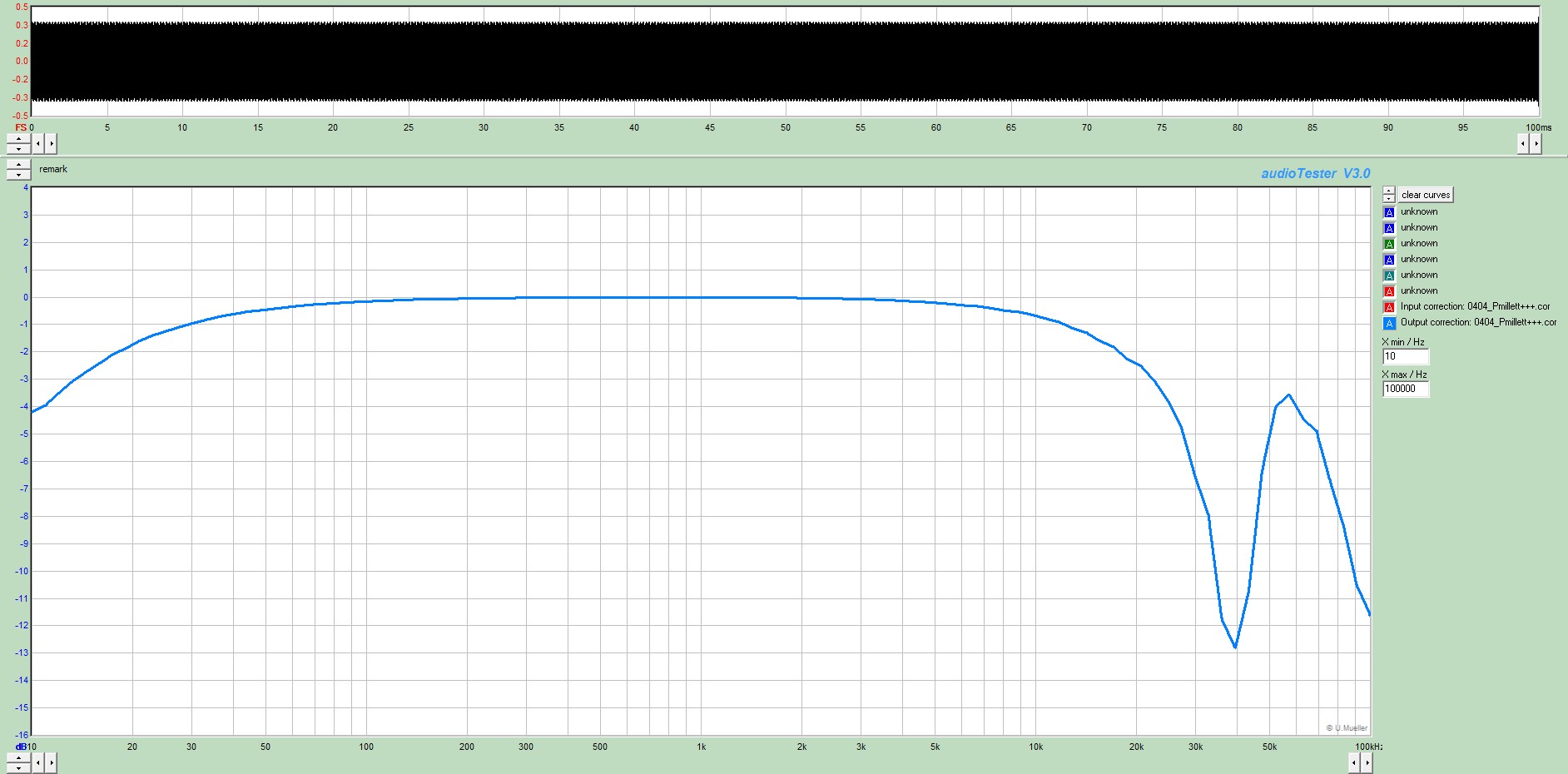

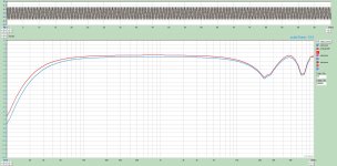

euro21,
Is the A10 Output transformer bad, or is it good?
Is your frequency response graph with, or without, negative feedback?
-1dB at 30Hz, and -3dB @ 15Hz.
That is better than many of the loudspeakers that many readers of this thread have.
-1dB at 12kHz, and -3dB @ 22kHz.
That is better than many of the ears that many of the readers of this thread have.
Peel the outer layers off of the Onion first, before worrying about the inner layers of the Onion.
Just my opinion.
"Is the A10 Output transformer bad, or is it good?"
Are you kidding? 😛
False impedance (thus enormous distortion in this design, with this tube even at minimal power), resonants in main bands driving 700R impedance!!!
With 13dB dip at 40kHz any OPT usable .... maybe in car radio at 1960, not elsewhere.
"That is better than many of the ears.."
This is an advantage for a hearing aid, but it cannot be a consideration in a design of "HiFi" equipment.

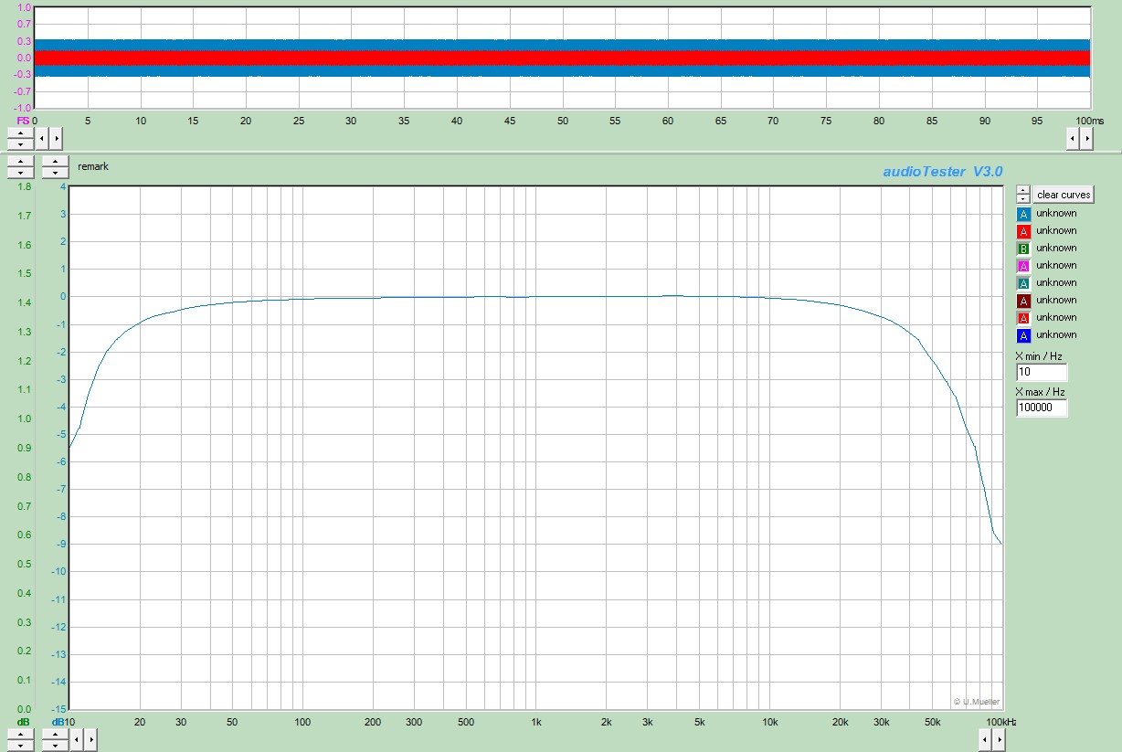

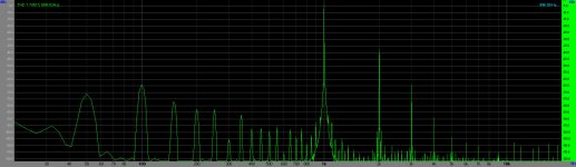

for comparison this is my 801a PSE transmission curve (at 1W, 0.86% THD) with cheap custom wound 5k transformer.

Maybe I'm missing something but why would the behavior of an OT at 40kHz matter to someone whose hearing is limited to less than that? Which is everyone, since nobody's hearing goes that high even when they're young.
How and why does this have an effect on the audible frequency range?
I'm also wondering if you're measuring the same OT as the one in Stephe's amp. Earlier you seemed to be saying that the primary actually measured 5k but she measured the ones in her A12 and they're 3.2k with a tap at 50%. Perhaps the A10 and A12 use different OTs.
Oh, and I'm curious . . . who made your custom wound 5k OT and how much did it cost? Just trying to put the term "cheap" into perspective.
@Flacharlie
"primary actually measured 5k "
#2 post: "rather 3k5 than 5k"
If it would be 5k, such distortions would not arise.
"they're 3.2k"
I found the removed A10 OPTs data, and based on the measured RLC parameters rather 2k8 than 3k2.
That explains the early growing distortions.
"How and why does this have an effect on the audible frequency range?"
Install this part, which have such anomalies (even measured lower source impedance than EL34) in -relatively- close to transmission band higher edge (BTW how wide this? 😛 ), and you get such phase which flying away within the "audible frequency range".
Experienced, that such OPT which have dips or peaks under 100kHz, in the amplifier sounds worse, than which have "smooth run".
See any OPT manufacturer datasheet.

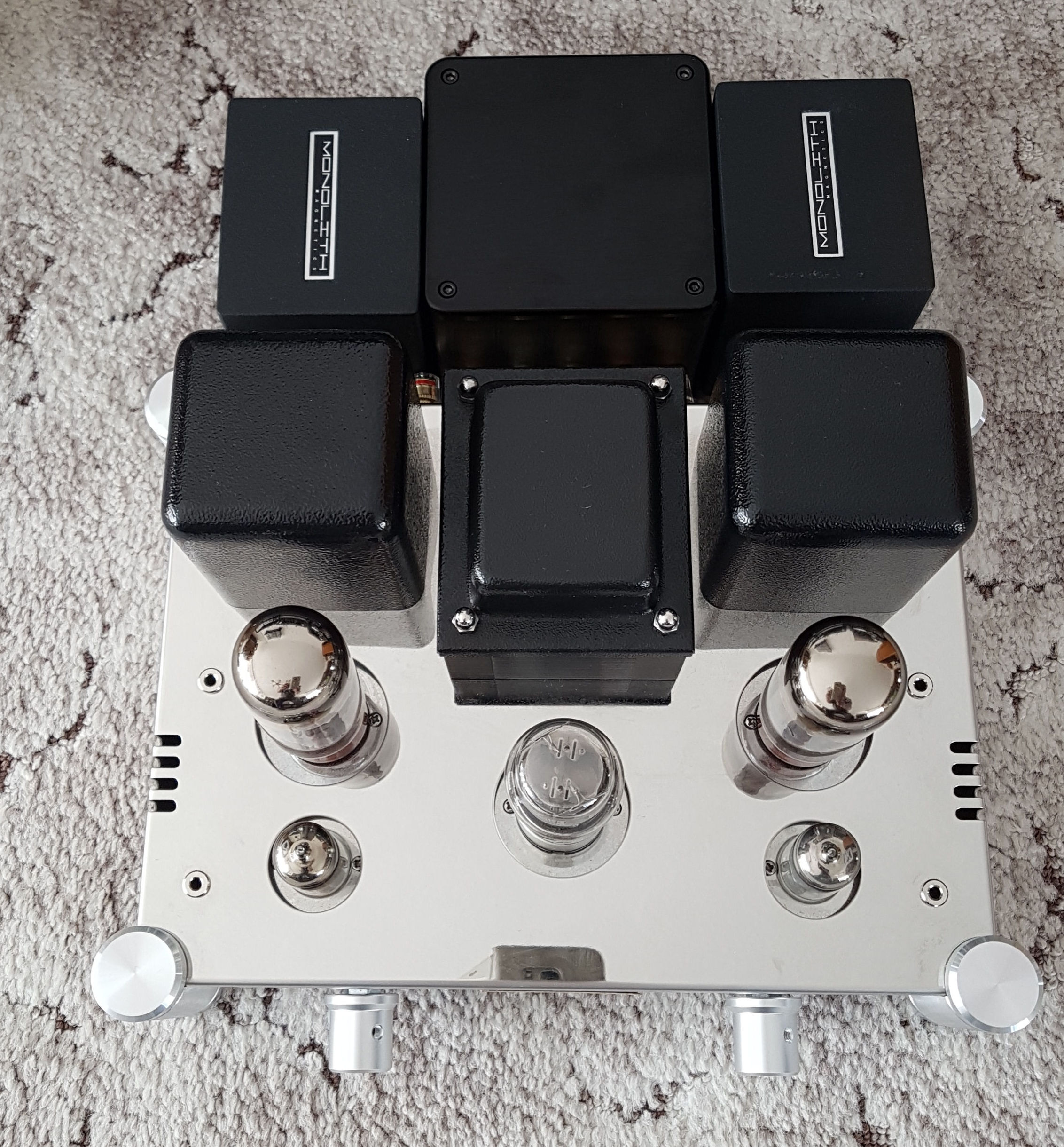

As I wrote, I bought second hand cheap A10, only for the case.
Before I took apart it, I listened it: mediocre, flat sounding.
I measured it, and measured the OPT too, because I didn't want to believe that it is possible to sell with such parameters as I measured in amplifier.
Typical "cheap chinese" product, nice look, only such value, than the price allow it.

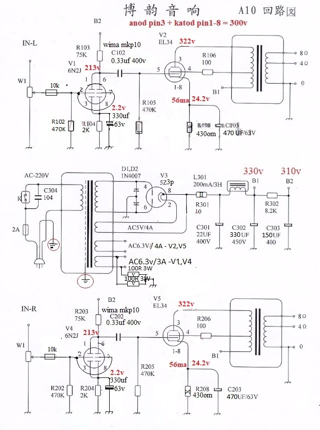

As the schematic (some variation in the internet) shows, with this tube and this operating point the better loading is 5k -rather than 3k5-, maybe not a coincidence that some user use it with 16 Ohm speaker on 8R tap.

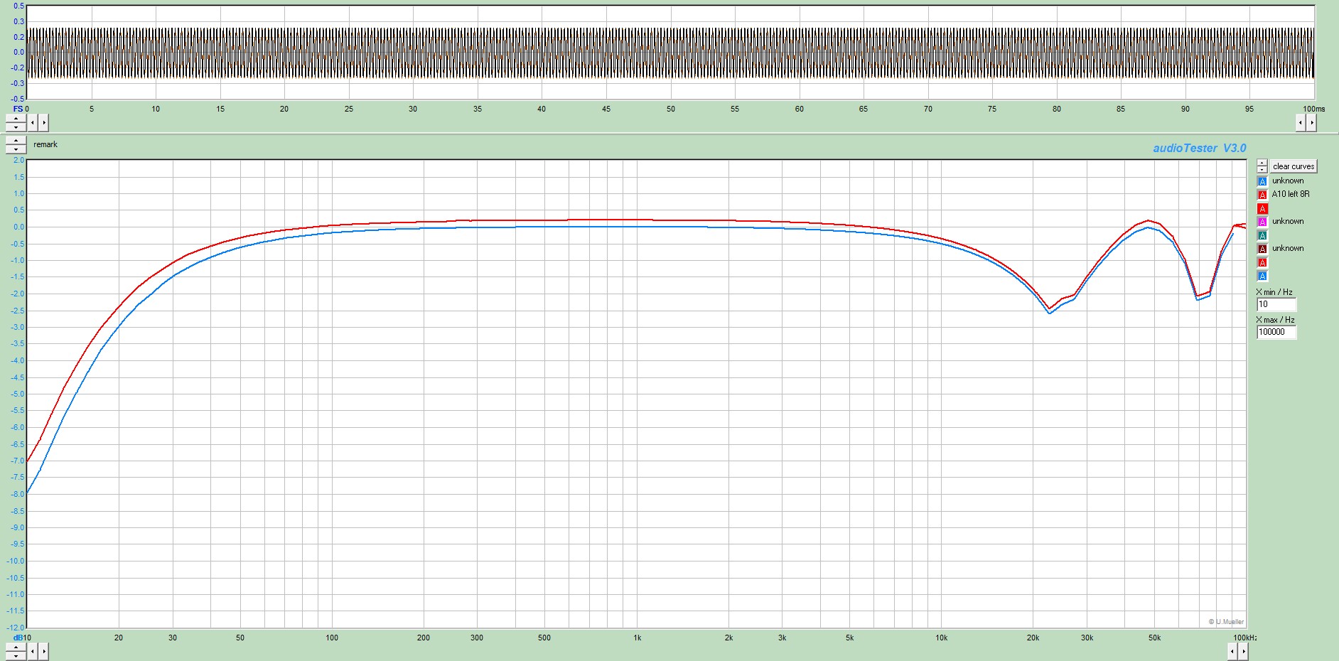

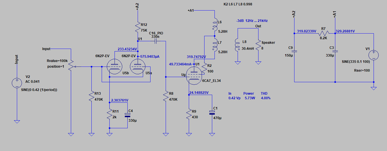

If the manufactured OPT would fulfil these parameters, the amplifier just issued (nearly) 6W with 4% distortion .... but the OPT behaviour will remain so I measured: the first resonance at about 42 kHz, so phase shift at 20kHz remains about 60 grad.
One question:
What is the leakage reactance from the 60% primary windings (the plate to the UL tap),
to the 40% primary windings (the UL tap to the B+ end of the primary)?
For UL, and without any global negative feedback from the secondary, then . . .
the leakage reactance from 60% to 40% is paramount. That will effect the UL negative feedback . . .
no matter what the leakage reactance is from the primary to the secondary.
And, Global negative feedback from the secondary has its problems on many inexpensive output transformers.
But some of these Chinese EL34 amplifiers output transformers do not even have the UL tap.
Without a UL tap . . .
Using Pentode mode, it needs either Global negative feedback from the secondary, or Schade negative feedback.
Saturation of low frequencies that is agrivated by negative feedback is worse with Global than with Schade.
Using Triode Wired mode, it may work ok with no negative feedback, but the power output will be very low.

These are the operating points I am shooting for, but some people say keep the plate at 300V. I wanna see 380V like this is showing lol I'm gonna go with what I know works.
