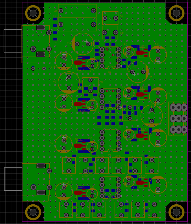

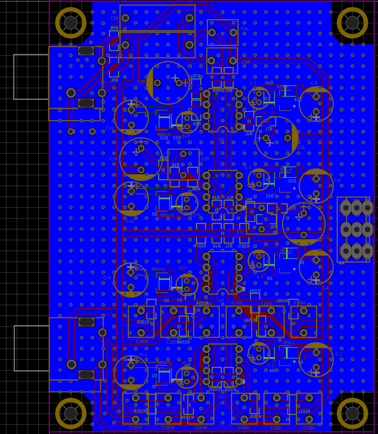

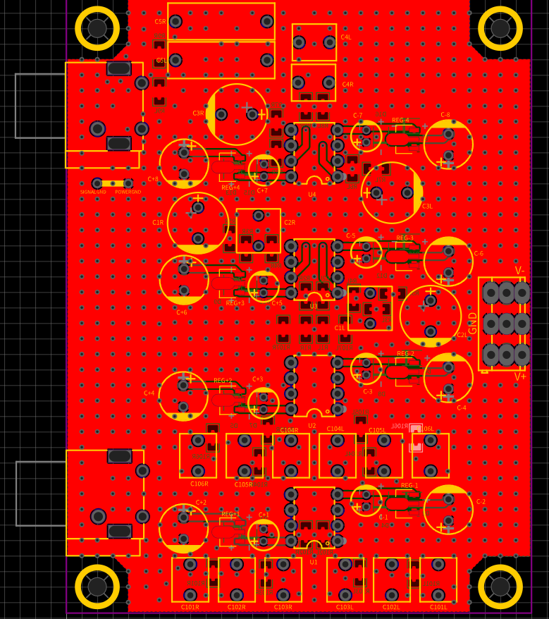

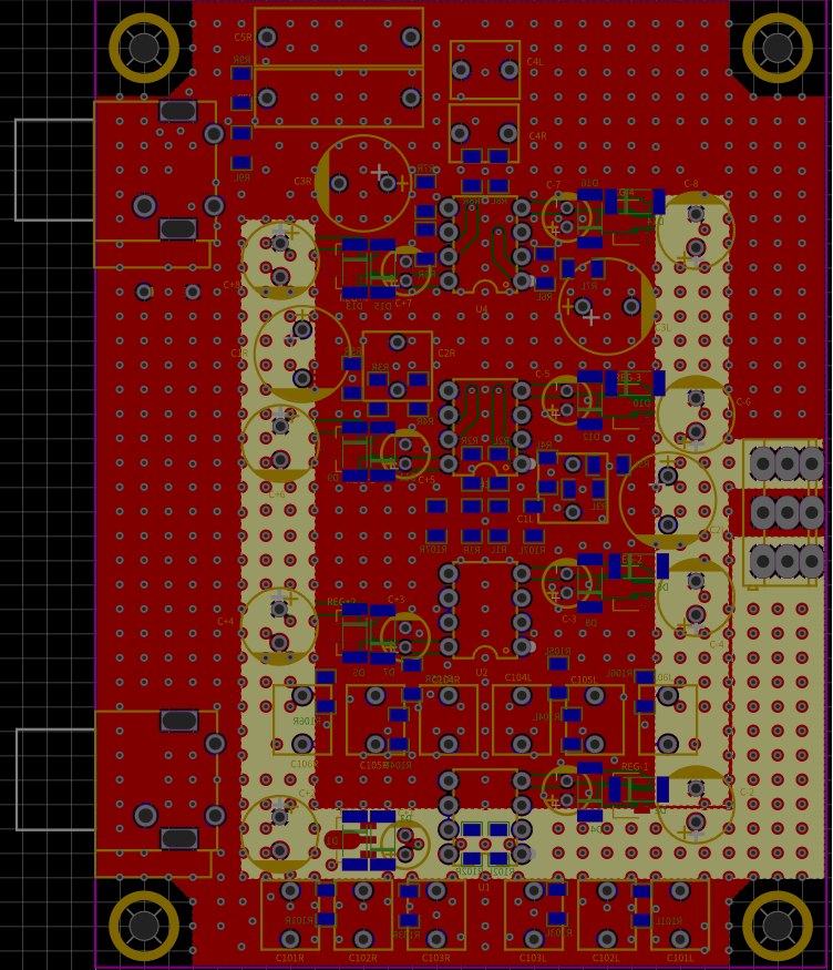

Well it took me a few evenings but here is a draft of a stereo version. 4 layers.
GND plane on top, inner 2 and bottom layers.
Power planes on inner 1.
Vias every 2.54mm as is practical. Surprisingly, JLC doesn't seem to mind how many vias there is. As long as their not too small a diameter.
Jumper at the top left to connect the signal and power grounds.
I'm not entirely happy with the layout. I suspect I can do better by using separate OPamps per channel instead of splitting them.
Give me probably another week and we'll see what I come up with.
Am I heading in the right direction?

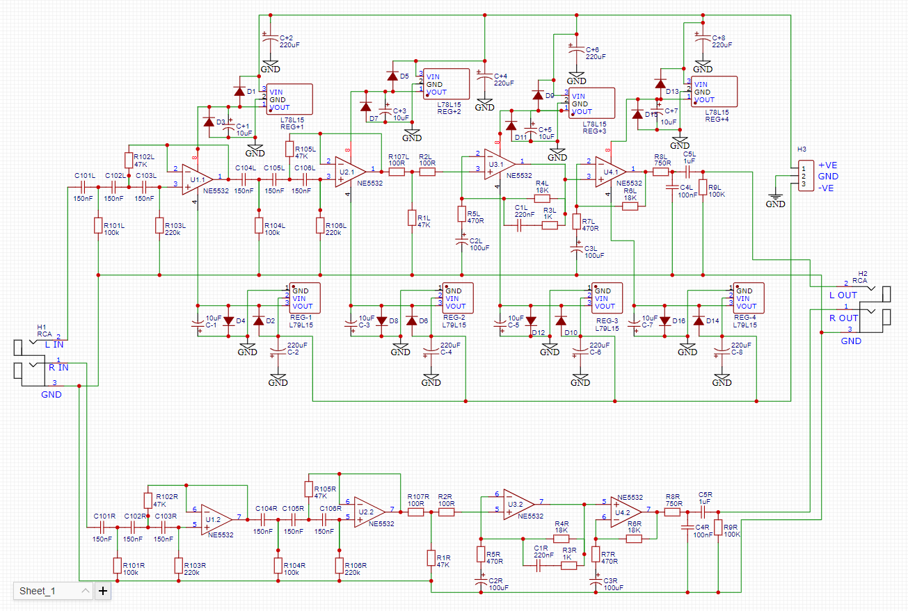

Did you post the schematic in this thread? If not, that could be helpful wrt any further tips about the layout.Am I heading in the right direction?
I haven't posted a schematic yet as the thread was simply about the regulators.

2-layer is considerably cheaper than 4-layer from the Chinese outfits. That said, the cost of either one of those will be swamped by the shipping cost, so overall I agree with you. If 4-layer will provide an advantage, just use it.4-layer is about as low cost as 2-layer.
You can do that with two layers as well. As @KSTR mentioned, start with ground pours on top and bottom and try to carve out as little of it as possible.With 4-layers you can start to make some power and ground planes/fills. Those can help a lot if used carefully.
The biggest advantage of four layers, in my view, is that you can go: SIG-VCC-GND-VEE or SIG-GND-VCC-VEE for the four layers depending on your current flows. That drastically simplifies the supply routing, which in turn simplifies the signal routing as the entire top layer is available for signal traces.

I think you may be worrying too much about grounding. Keep in mind that current flows in loops so you need to worry just as much about VCC/VEE as you do about GND.GND plane on top, inner 2 and bottom layers.
I tried multiple ground layers with VCC/VEE as pours on one layer in a power amp recently. That did not work as well as SIG-VCC-GND-VEE (top to bottom on the layer stack).
That's over-doing it in my view. You're not dealing with 40 GHz RF here. Also keep in mind that the hole removes quite a bit of copper, so you actually get a higher ground impedance with a perforated plane than you do with solid planes stitched at the ends. Now, for EMC stitching only at the ends may not be the greatest as it creates an antenna, but you can drop a few vias within the board and have the planes stitched pretty tightly together.Vias every 2.54mm as is practical. Surprisingly, JLC doesn't seem to mind how many vias there is. As long as their not too small a diameter.
Also be careful that the vias don't end up cutting through planes and pours not connected to GND.

Since a schematic has been requested. Here we go:
This is a Rod Eliot P06 phono + a P99 Rumble filter. Not state of the art.
However Rod's stuff normally works and performs well.
I would use Rod's boards but he makes annoying choices for caps and terminals which force me to make me own.

One more question, @Sadface , what is your power source? The usual transformer + bridge rectifier + reservoir caps? And where is it located, mechanically?
Point is, the moment you have ripple on the incoming supply, this ripple is injected into the GND by the regulators' input bypass caps and this can ruin everything, given the very high gain at mains frequencies.
And IMHO there is no benefit from using separate regulators at each opamp for circuit like this. One global set would do.
As for topology, are you sure the rumble filters are at the right location, before the actual input? That isn't a good idea IMHO, for a number of reasons. I'd place them in between the two main stages.

Looks OK but the square angles on tracks make the trace unnecessary long & susceptible to pickup.Well it took me a few evenings but here is a draft of a stereo version. 4 layers.
