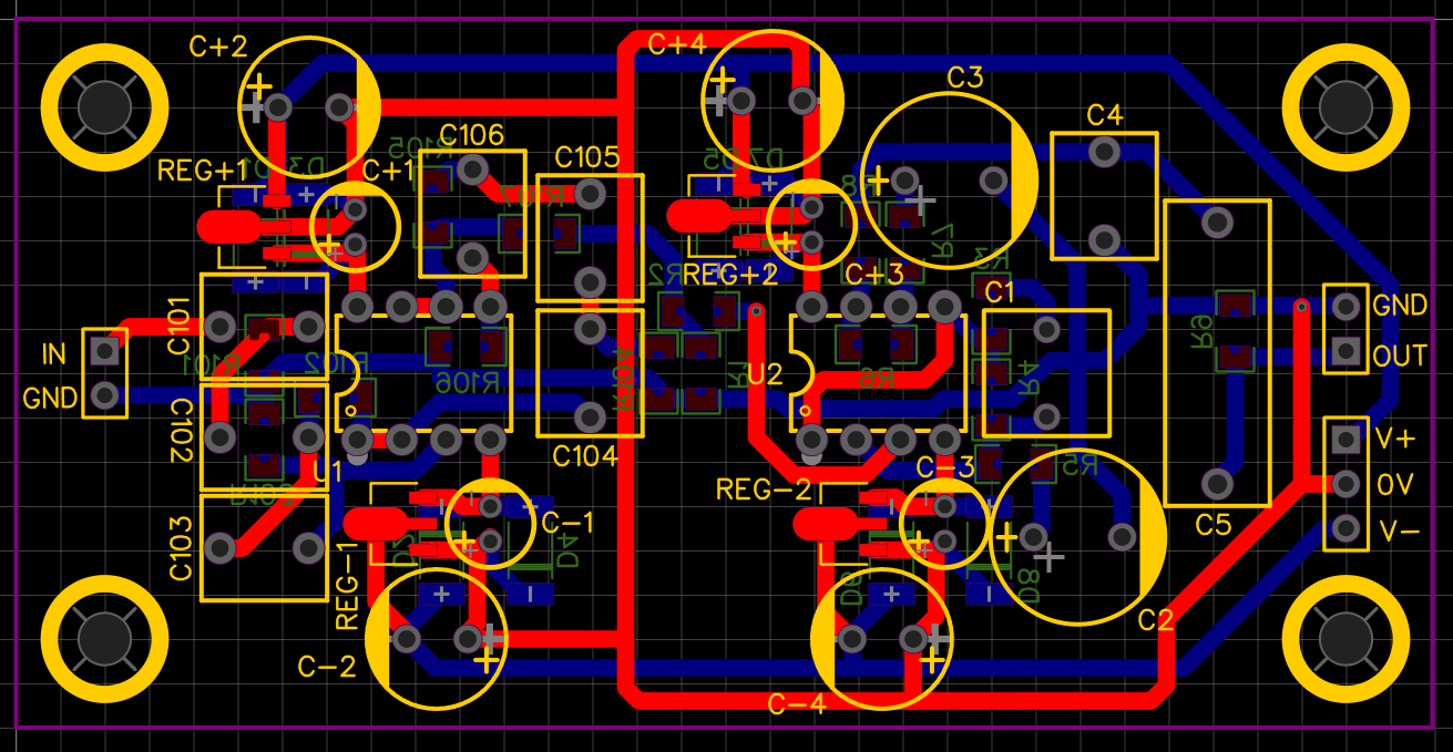

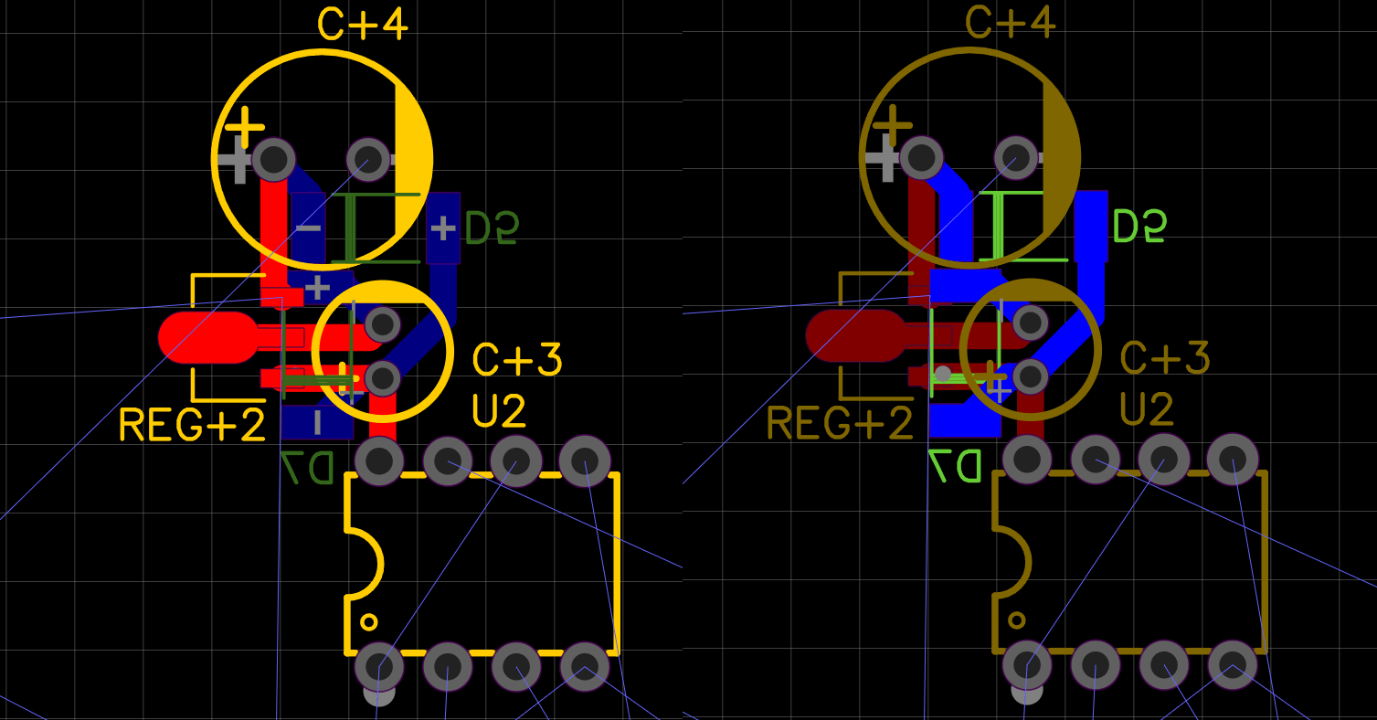

This does raise another question.
Which should be closer to the opamp pin:
1) the regulator output pin
2) the output capacitor pin
The cap.
Most of my boards now are SMD, but I still use THT electros, pots, switches, connectors and other large devices. I like to place components on both sides too.
As done in the pictures of the layout as the caps serve 2 masters here.This does raise another question.

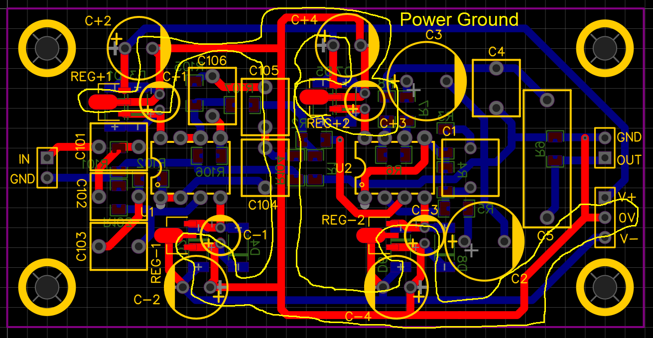

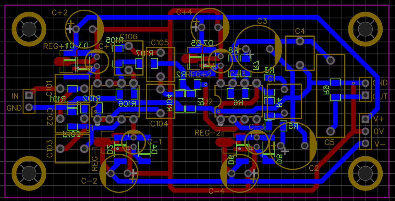

So, I have a first draft of the layout.
Ignoring the rest of the layout and schematic for a moment. Is this a sensible way to do the ground when running 4 separate regulators?

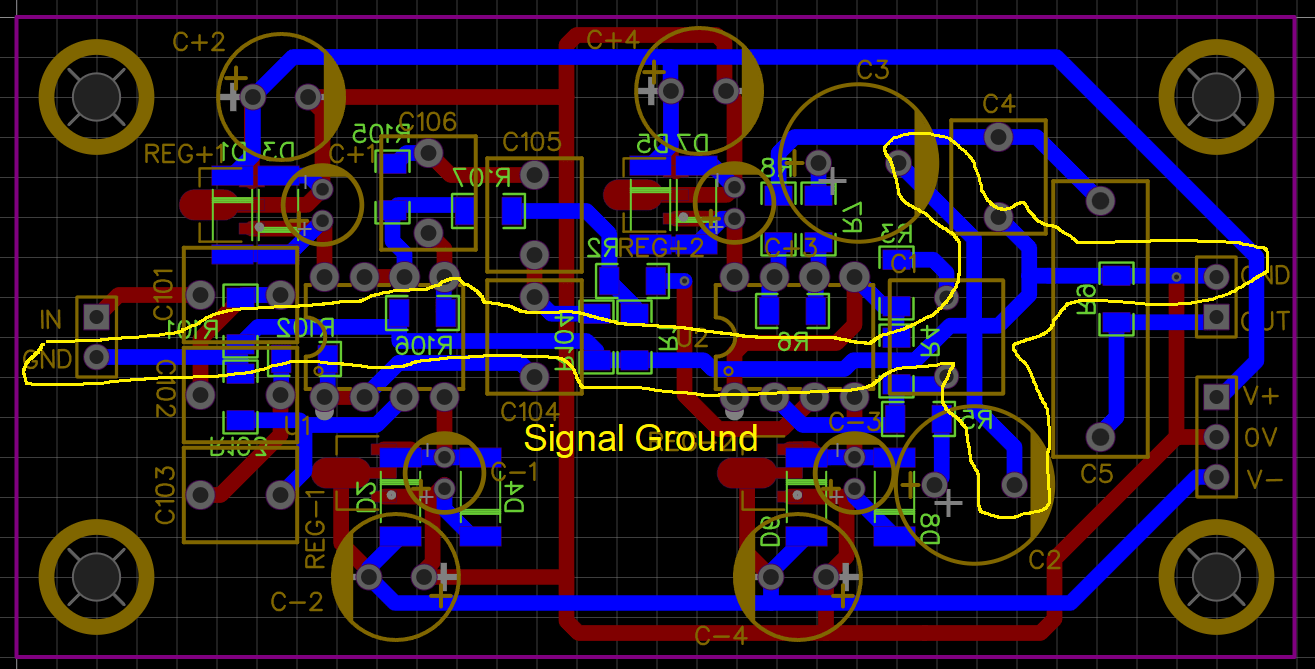

For clarity:
Signal ground
Power Ground
Would I be better running the ground from the top 2 regulators straight back to the 0V labeled PSU input header?
I also considered just using a ground plain for the power ground with a separate signal ground rail and a single jumper to connect the 2 at the PSU input header.
For clarity:
Signal ground
Power Ground

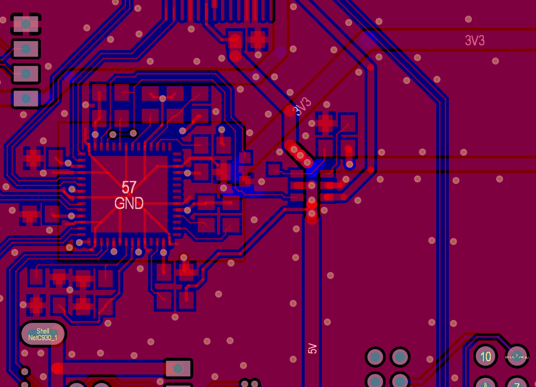

Successful routing of a two-layer board goes like this for me, for decades, with dominantly THT but also some SMT parts:
- Start with solid GND plane on top and bottom.
- Add stiching GND vias every 5..10mm or so, that is, hundreds of them literally, arranged in a grid.
- Generally, route traces on top layer in one preferred direction, and perpendicular to that on the bottom layer so that the GND never sees and interruption and doesn't form peninsulas, let alone full islands. Use the legs of the THT components to switch layers when feasible. Start with the supplies, using wide traces.
- Move the stiching vias if required, sometimes you have to remove a few to make room for the routing.
- OTOH, if you have longer traces on top and bottom that cross each other, place 4 vias in the 4 corners of the crossing to maintain GND continuity. Further, place vias along long traces on both sides.
- Try to avoid dense packing of parts to have enough room for routing. Spend most of the time on strategic parts placement, and don't be tempted to make visually nice arrangements. The electrons don't care.

Since nobody seems to think the design is terrible. I think I will proceed with something along the lines of what I have.

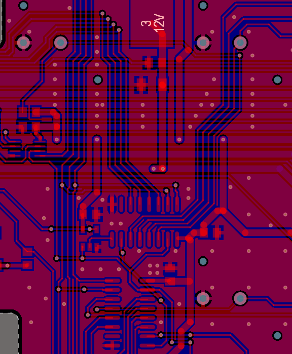

@jean-paul ,Will do... it'll probably be a mostly digital board with SMT parts, but using the exact same ideas... and it was really required to pass EMC test
