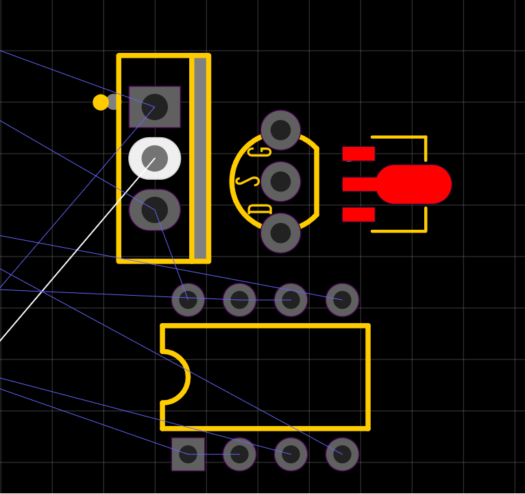

I have made a bit of a pivot towards the pearl 3. A far more sophisticated design imo.
Since no stand alone pcbs ate available I'm back to pcb design with everything discussed above still relevant.
