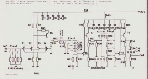

Here a schematic of the first phono preamp I built for a friend in 1983. There are no opamps to upgrade. The friend passed away but the preamp is still in use AFAIK.

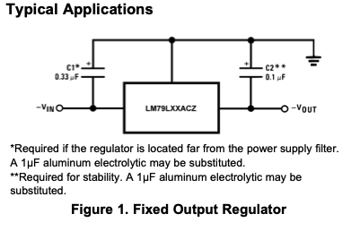

Reading the data sheets of the 78/79xx regulators they all same the same thing word for word:
"An input bypass capacitor should be selected to provide good high−frequency characteristics to insure stable operation under all load conditions. A 0.33 F or larger tantalum, mylar, or other capacitor having low internal impedance at high frequencies should be chosen."
Given the low current consumption, I don't think the typicall 2200uF input cap I see on most designs is necessary.
I am thinking of using a 1uF polyester cap on the input and output which should save a lot of pcb space and allow me to keep things very close to both the opamp and regulator pins.
Does this sound like a good idea?
The L78xx datasheet in my old SGS-Thomson databook shows that same recommendation, but the L79xx datasheet demands a 2.2 uF solid tantalum or 22 uF aluminium electrolytic input decoupling capacitor if the regulator is placed far from the smoothing capacitor. In my experience, both the 78xx and the 79xx work fine with a 22 uF run-of-the-mill aluminium electrolytic decoupling capacitor at the input.
I once had to repair a studio mixing console that had started to make soft beeping sounds. It turned out to be due to the manufacturer using 10 uF electrolytic input decoupling capacitors for the 7815 and 7915 regulators that were on each of the few dozen modules. When new, that just worked, but with a bit of capacitance loss, it didn't. The resulting ultrasonic oscillations gave audible mixing products. I changed all the capacitors to 22 uF and it never beeped again.
That has changed with recent (= post 2000) 78xx/79xx and 78Lxx/79Lxx. Just as their lower noise numbers and also lower dropout voltage. Sometimes at some types at some manufacturers dropout voltage is typical 1.3V which could today be called LDO... Please check current datasheets of TI, On Semi etc.
About 78Lxx/79Lxx 100 mA regulators: old 79Lxx also were notorious for being unstable without load. They were also less reliable compared to 78Lxx and sometimes latched up. A reason to keep using the cheap TO220 1A versions. Then, not today.
The ones from ST are still the same, see page 11 of the pdf on https://www.st.com/en/power-management/l79.html
Input cap 2.2 µF, output cap 1 µF, dropout voltage 1.4V typical..... Even 1.1V (!) for the 12V version. They seem to be a lot more noisy with 100 µV typical than those by competitors. Not recommended. I have seen 7905 with less than 40 µV of noise.
So they are not at all the same as the ancient ones except their unchanged datasheet higher input/output capacitor requirements which are unusual today. Besides that exceptions confirm the rule 🙂
78xx/79xx have evolved to a better version of themselves in time. From noisy LEGO like common parts to pretty good regulators. Point today is which one to pick from what brand as they differ.
