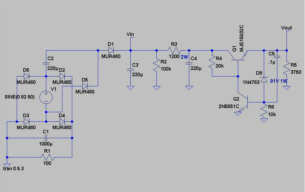

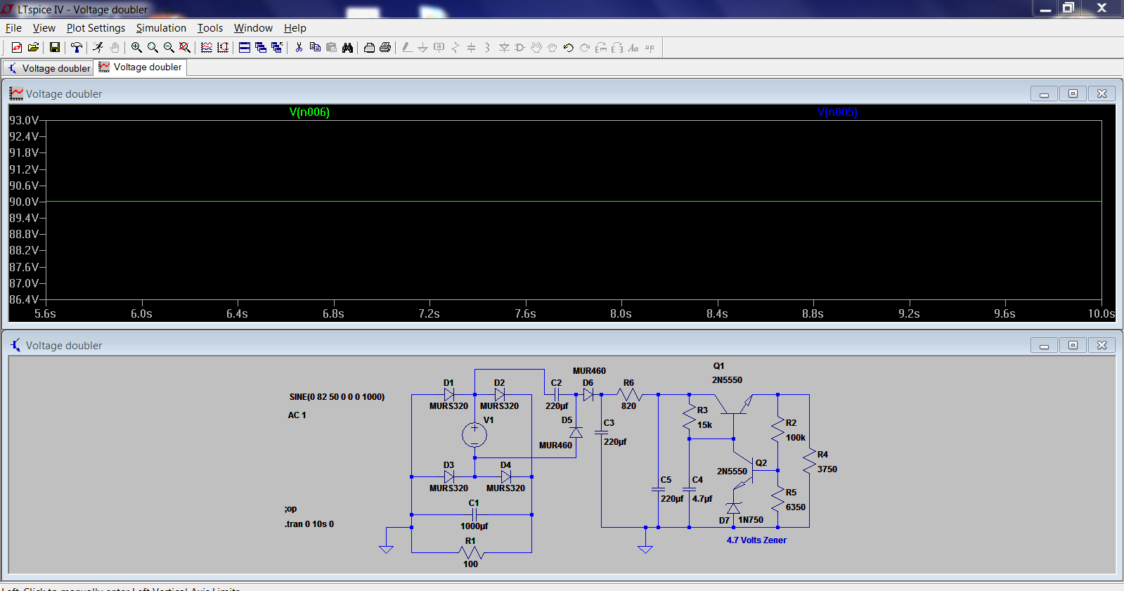

Regulated +80V Supply ....

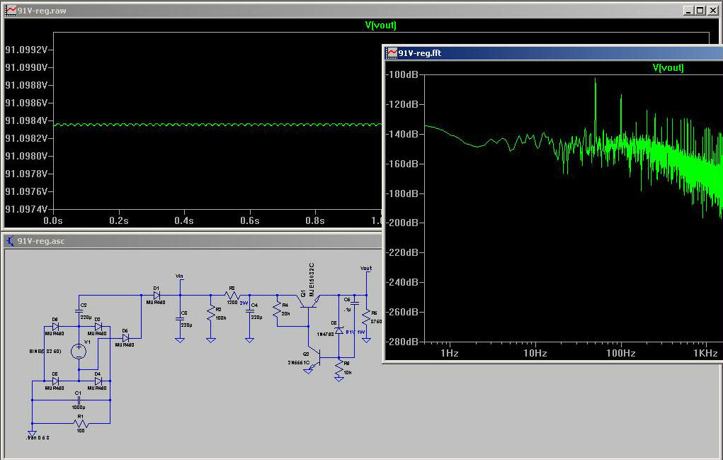

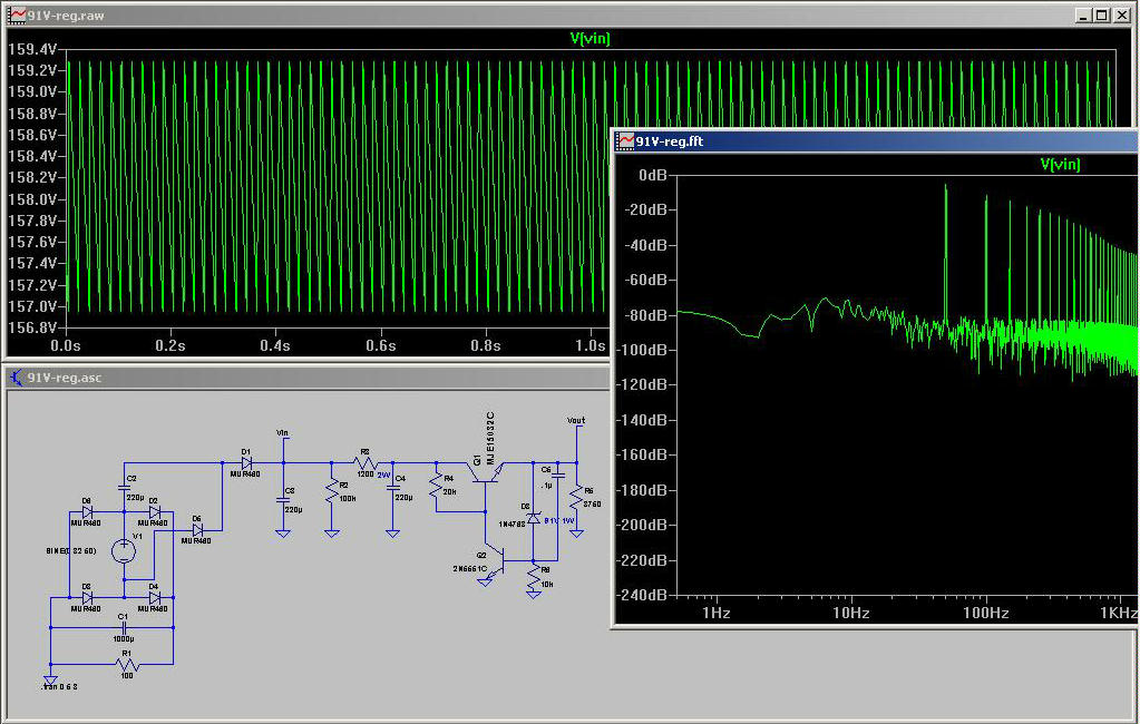

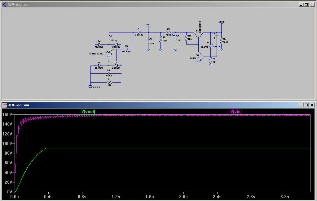

Mooly, I changed a few things that you started with.
R3 in addition to reducing ripple lowers the dissipation in Q1 to about 870mW.
Transistor models are Bob Cordel's.
Better yet leave R2 out, you get an extra 2db ripple rejection.

Hi RJM1,
That looks good in implementing and spreading the dissipation and using a better regulator. I'll have a closer look later 🙂
These simple circuits and ideas can be refined and elaborated on greatly.
A doublifier 🙂
Pro's... there is no other transformer involved which to me is a big bonus. Less chance of mechanical and radiated hum/noise. Its simple, or at least as simple as you want it to be. The regulator is as complex whatever happens to feed it and not really part of the doubler as such.
Cons... it doubles so there is unwanted voltage to "lose" in the regulator. That means heat generation. For the low currents involved its not a big issue though. The caps need to be good quality, again not an issue.
Heres a quick lash up of a different regulator. This can adjustable by varying R5. As before ignore transistor types.

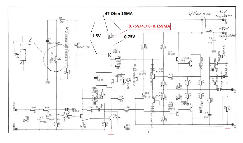

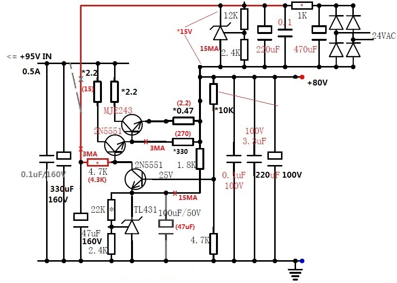

So, we assembled the PSU ....
Beside it looks good, it seems, that there is also a good stable supply of ~75V. As already expected, also the 75V regulated shows only something about 73V. I used two 30V and one 15V Zener Diodes.
Here are some pics:
Sorry for the poor quality, it's an iPhone ....
And the new PSU fits also in the original NYTECH CPA 602 box ...
As you can see here:
Now I need a beer ... Or maybe two .....:drink::drink::drink:
