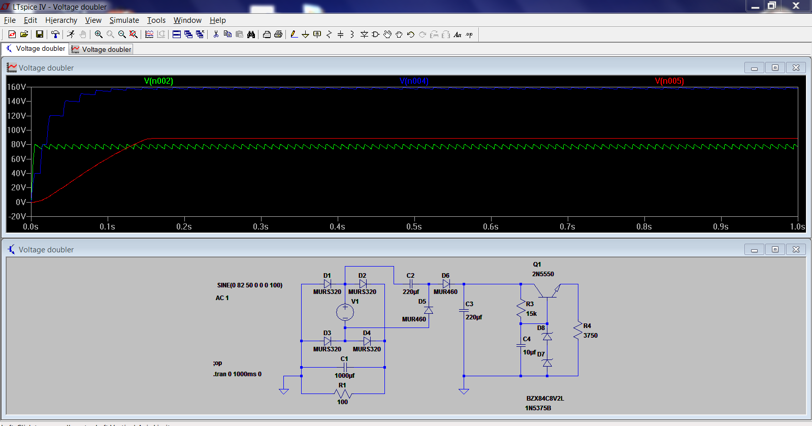

Messy... you would need multiple voltage doublers cascaded to increase the voltage.

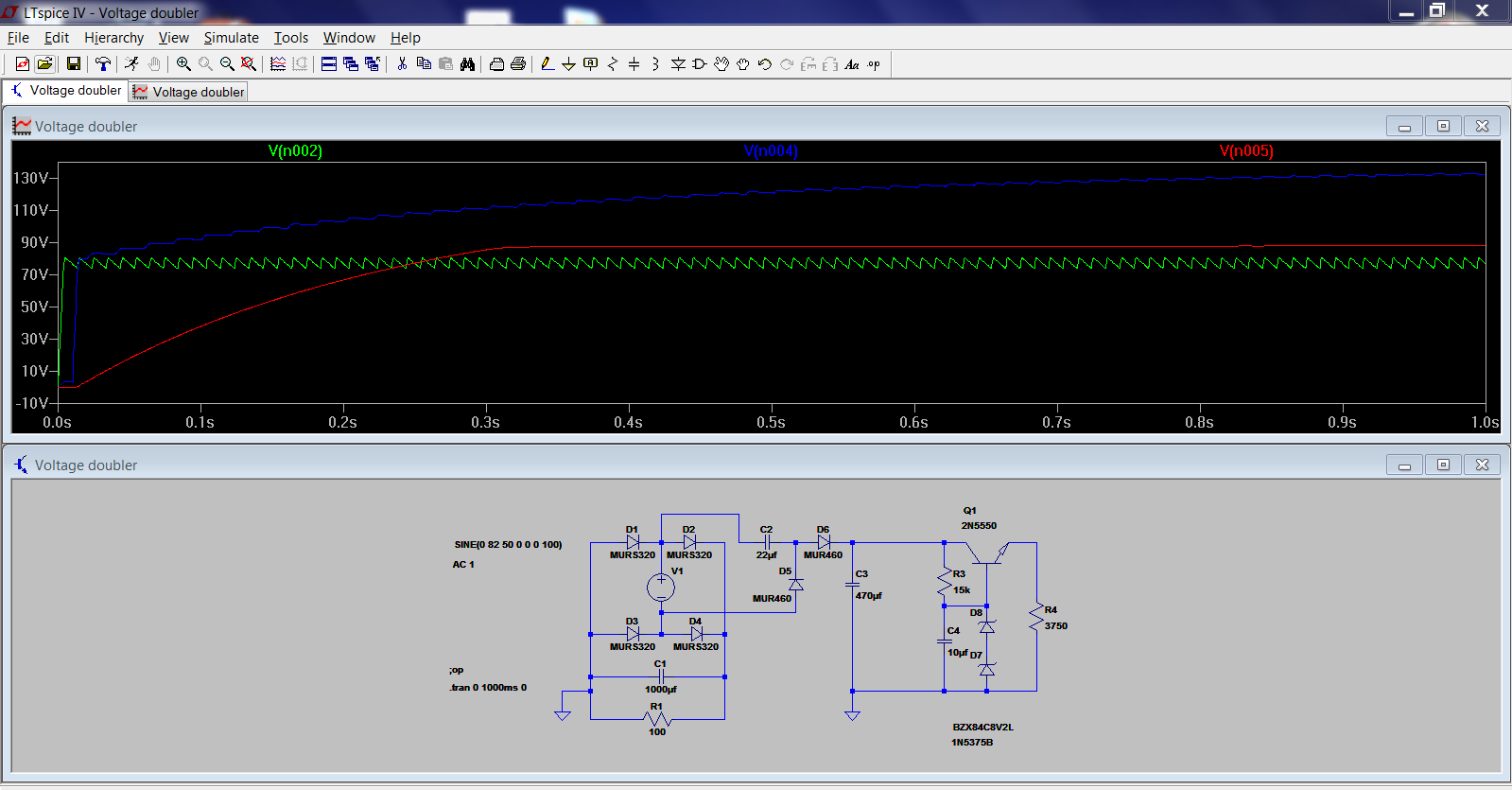

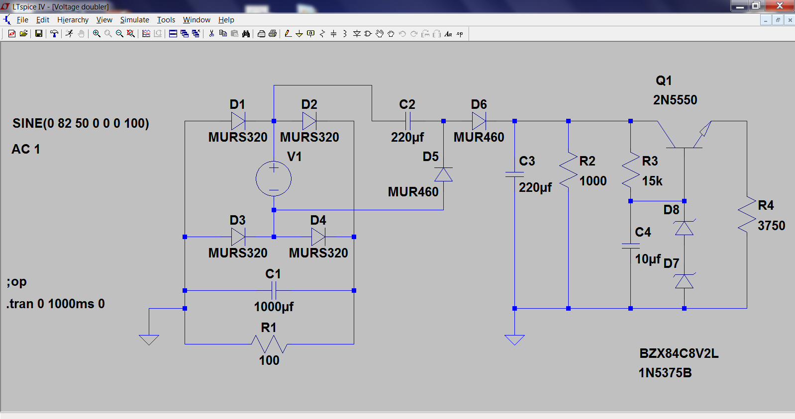

Look at this.
Green is main 82 volt rail
Blue is doubler output
Red is regulated.
Ignore the actual semiconductor types... they were standard models.
R4 is your 24ma load.
V1 is the main transformer.
This looks really good ..... I'll do this for my Mono-Blocks .....
For the existing 602's I'll go with the regulated 70V-75V Solution ....
I'll setup the schematic for the PSU and will prepare an experimental PCB.
What will happen under high load? Will the Voltage brake down or is there allway enough room/flexibility?

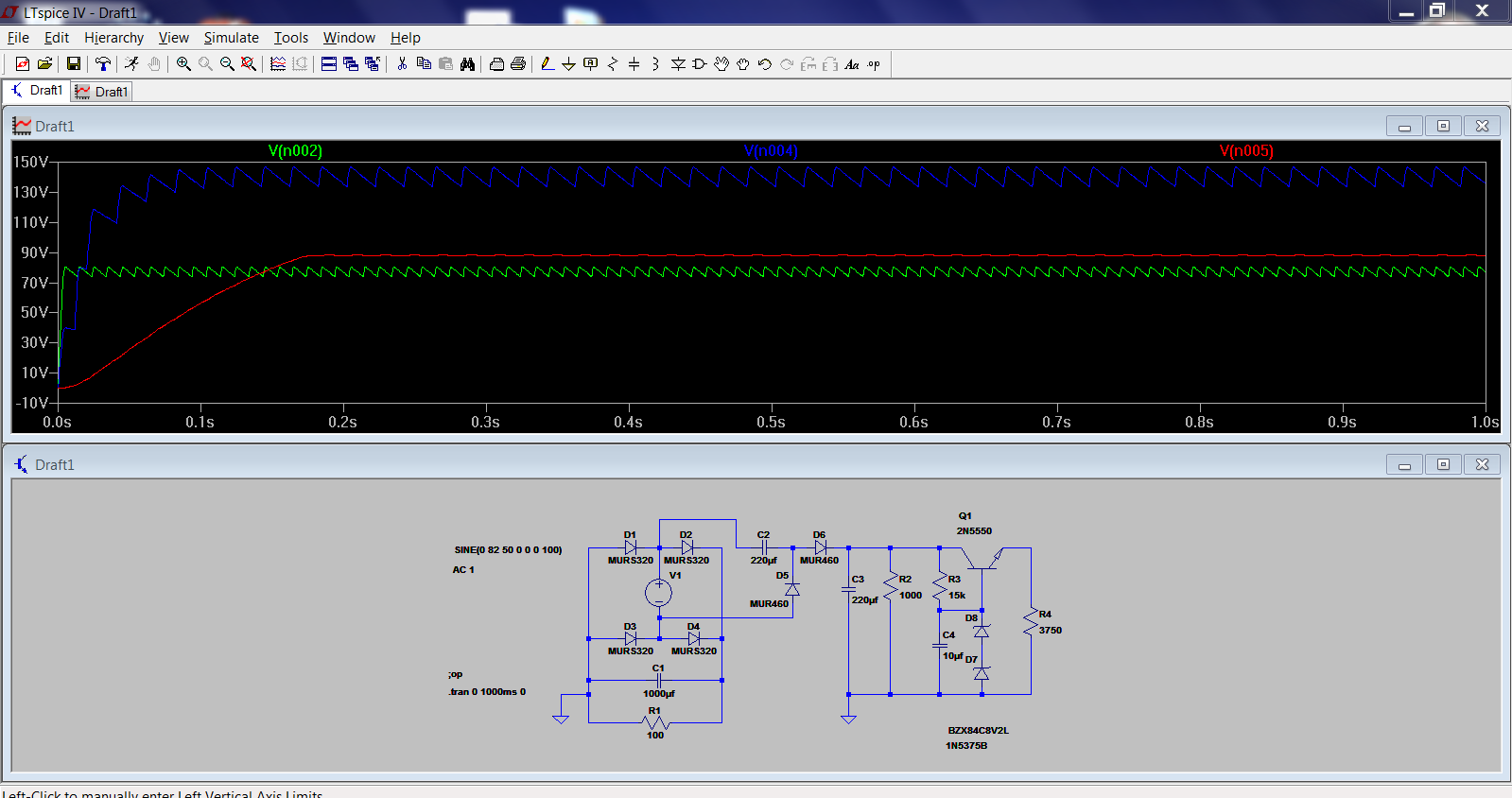

I'm very confused with your circuit...D1 to D4 (the bridge), what are they contributing to your voltage doubler ?
Also with two 8V2 zeners at the base of TR1, surely Vb = 16v4 and thus Ve will be about 0.7V below that = 15.7V ish.
I know that you said to ignore the actual semiconductor types, I assume D8 and D7 zener voltages would add up to 90V, but Q1 will have to be bigger than a 2n5500 as it will dissipate 60V*.024A= 1.44W. You might want to increase the value of R2 to 100K because at 1000 ohms it will dissipate 22W.
Thats right, D1 to D4 contribute nothing to the doubler or reg.
I put them in to make sure the circuit worked as a whole when the two grounds were joined. Just wanted to prove to myself it was OK
The zeners are an 82v and 8.2 ? was it. I just used the available models and these added up to around 90 volts.
Zeners as you say and the transistor.... well in LTspice they don't smoke or burn a hole in the screen. A scan of the catalogues will show suitable devices.
R2... I honestly hadn't noticed I left it at 1 K. It was there from when I was building up the doubler from scratch and before I added the reg so I'll re-run the sim. Well spotted... thanks

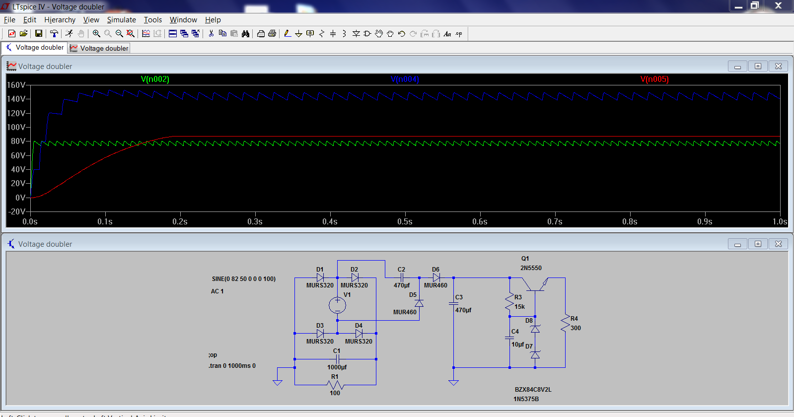

Here's a re-run with no R2 and also a test of how much current it can deliver. Note the increase in the value of the caps to get more current.
As to the regulator, well this is as simple (but still good) as it gets. You could design a more elaborate regulator with error correction which would be a two or three transistor circuit. You could also add series R/C/R/C filtering before the reg. That could also usefully be used to spread the total power dissipation. It all depends on how complex you want it all to be.
Remember the series pass transistor will get hot at high currents and needs to be rated accordingly. 160 volts in and 90 volts out at 24ma means around 1.7 watts transistor dissipation. If the load is known and reasonably constant then the caps can be sized to reduce the 160 volts down a little by using the reactance of the cap to "drop" the voltage with no power loss.
Look at the component values and voltage scale to see the differences in these examples...
