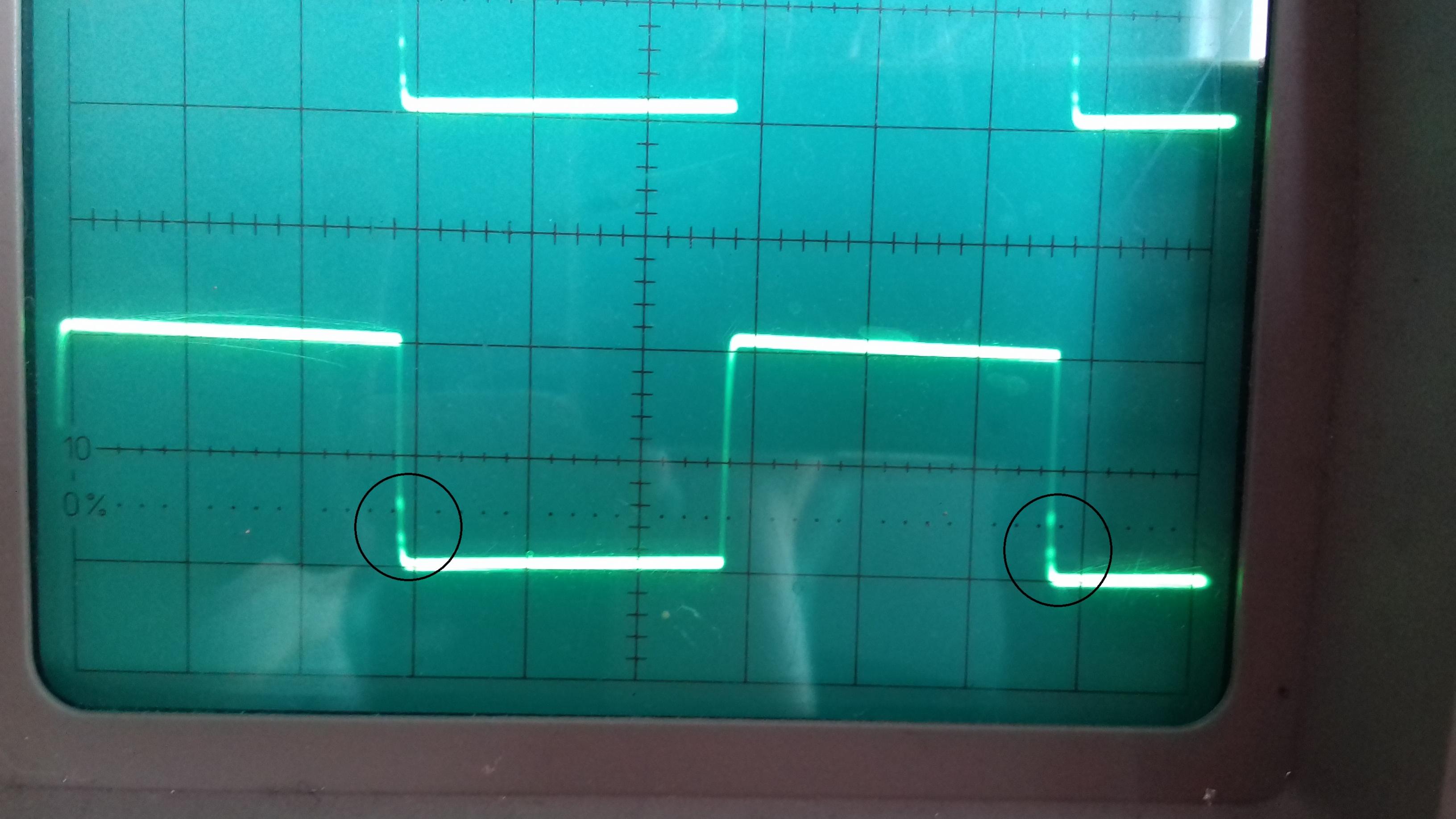

Good news, it's up and running again. I replaced all the transistors in the output section (14) and went with the BD139/140 as drivers. Also replaced a bunch of resistors, some of them had been replaced already (a few with wrong values) and the speaker terminals. I had to repair a certain number of track as well, I think the previous tech went in there with a solder iron for plumbing, it was quite the disaster. Anyway adjusted bias while watching power consumption and monitoring the output for oscillation but everything seems great. Only thing I can see is a little dot (looks like some crossover distortion but I don't have it on the regular sine wave) on the vertical parts of the square wave (that looks perfect except from that).
Try a tiny bit more bias perhaps? That dot is bad news. If not there at 1Khz it is less serious. A square wave often hides it.
15 mA is fine. I see that glitch. The wave shape looks good. Is it 1kHz? Try 10 kHz as it's a tough test.
Square and saw waveforms are the ones to use to reveal the problems....
I don't see anything on a regular sine wave, no matter the frequency or amplitude, it's only there on a square wave (again at any frequency).
As I said, it's there at any frequency, 10kHz included 😱.
I'll try to check tomorrow at what point in the circuit the problem shows up.

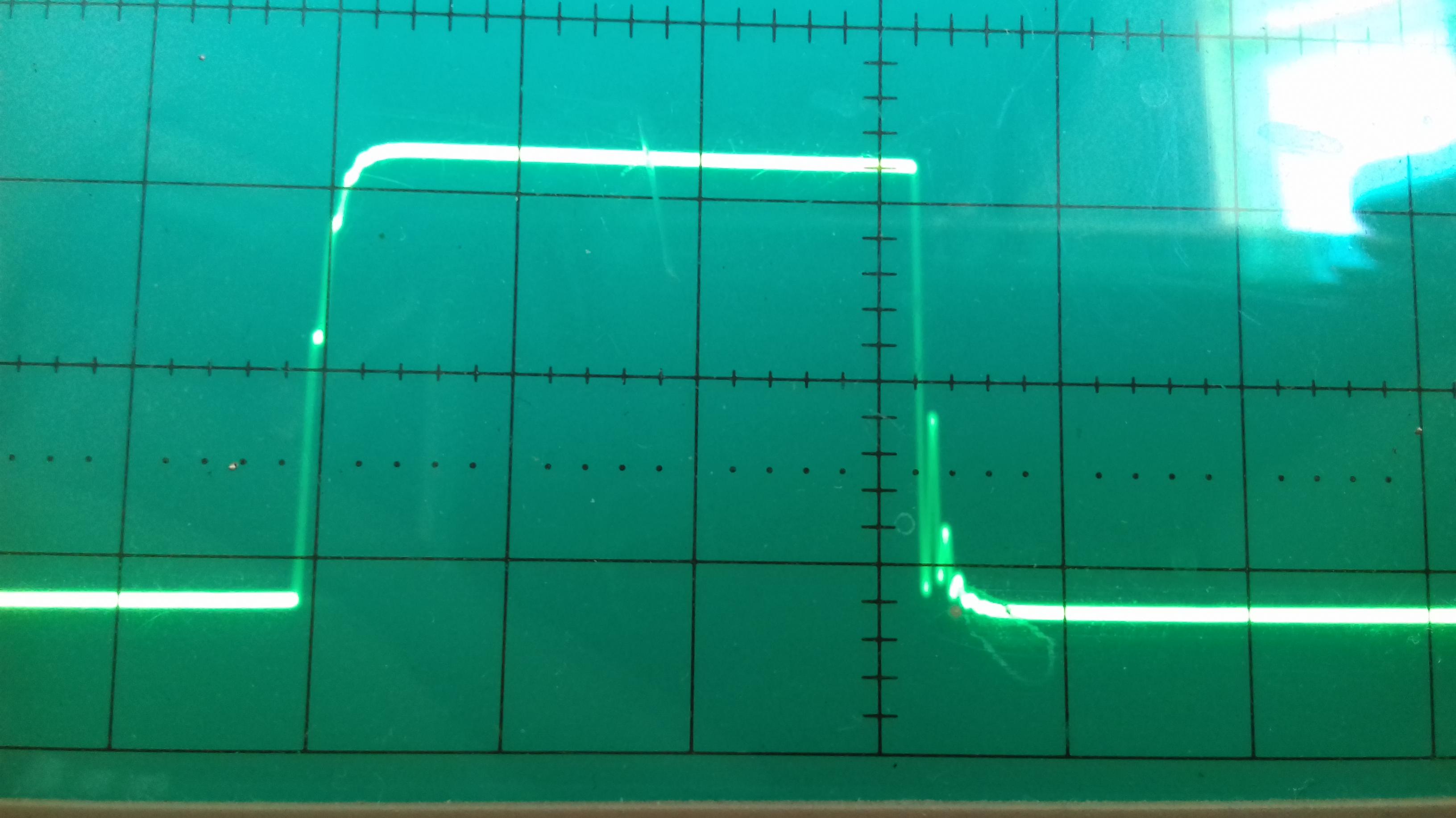

Well it looks like there is some overshoot on the square waves that causes ringing and that is what we see. It appears on the output of IC3 (but I guess it can also be caused by the negative feedback). When first probing I looked on the wrong IC which led me to see that there is also a little bit of ringing on the output of the tape amp but non on it's input that is taken directly from the output of IC1. could this be a default from those TL072 ?
10 kHz needs at least 190 kHz bandwidth to work. That is about right. That glitch you get I guess is the op amp not closing the loop. Try 5 kHz. 5 kHz is a good test. 1 kHz is about the last sharp square wave a CD can give. 2 kHz should show ripple on a CD player. Triangle waves should work better.

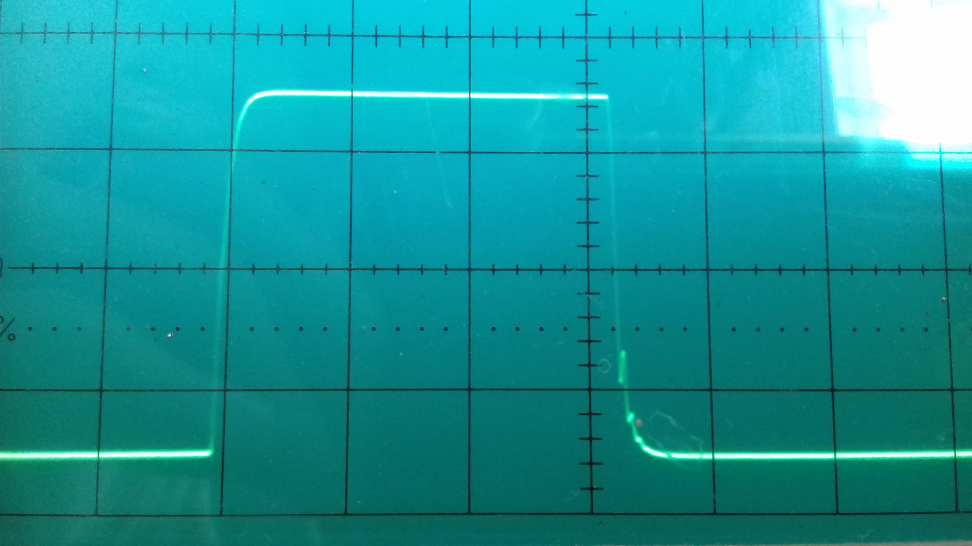

The ringing is there with any frequency on the input as I said before, here are some pictures with a square wave at 5kHz as reference. the first is at the output of IC3, the second as at the speaker terminals, the ringing on the up side isn't there at the output of the amp but it is visible at the ouput of IC3.

I have seen worse. I think I would be happy with this. Perhaps what you see at IC3 is feedback actually working? If so highly impressive.
Despite my young age and the fact that I still regularly need some help with stuff, I've seen and repaired quite a lot of amps and this is the first time I see ringing, that's what got me worried.
Sometimes output chokes cause that look. A 10R 3 watt resistor to damp the choke can help. Often the choke is a 16 x 8mm ID wire coil.

I don't believe this amp has an output choke, the only thing between the collectors of the output transistors and the speaker terminals is the fuse in parallel with a 1k resistor.
I'm not looking to modify the amp, I really just want it to work as good as it used to.
I really doubt it ever was excellent.
You can add 0R22 to the output after the feedback loop that can enhance real world stability. Remember your test is nothing like a real speaker. Adding 0R22 will not change real world damping.
