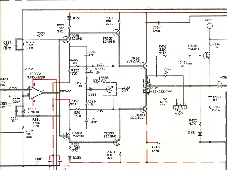

Back to the opamp driven audio amplifier, I noticed this Denon PMA350SE design posted in another thread and I'm surprised Denon went this way, given their reputation for good sound quality. I'm uncertain of the drive to the discrete power amplifier section though, given the opamp rails are +/- 16V yet it doesn't appear to me least, that drive is taken from there.
I think the simplicity and low cost might make a clone a worthwhile project though 🙂

I think I know that Denon. Had no idea it was like that!. PMA250 is nice.

I had another look at the Denon design and realised it's a refined version of the old Elektor circuit they presented a few times in different amplifiers, where the drive to the output stage was indeed taken from the opamp supply rails. However, Denon's compensation scheme is something new to me.

I feel the lack of the local feedback loop ( Q1,2,3,4 ) is a mistake. Having built Texan clones they seem to be unusually stable for an op amp driven design. My hunch is just enough loop and local feedback. The better transistors for 200V ( +/- 100 ) might be 350V types. I will need 250mA which allows for a reactive load. It will give 110Vrms in bridge mode.
Ian. You must have seen the feedback loop as here many times ? With this design the 10pF C1 seems the better place to try something. Many say Cdom (to VAS, TIS) as Douglas Self calls it is the better idea, others like JLH say no. Any thoughts? It would be interesting to think this could be the big deal factor in most designs. As JLH said I think, the power stage has more current to drive it so is the logical way.
I had a look at the full Denon PMA 350. It seems a bit like the mystery circuit I gave. I like the idea of a emitter follower output buffer. The capacitor that joins the two collectors of the previous stage seems a nice idea, I suspect it does a little bit more than the usual.

the 1k emitter resistor and 1k collector resistor of Q1, Q2 only gives unity gain. I suggest that is why the concept is fairly stable and does not need a local feedback loop. In this case.
But the op-amp + power amp idea was taken up with RCA's 120-300W designs where I note they did include a local feedback resistor - which in the diagram of post 103 would be to the centre tap of R9, R10, which obviously could no longer be grounded.
It is possible to achieve stable operation with a two stage (counting the op-amp as one, and the output-stage-with-gain as the other with appropriate feedback loops, as you say, where you can control the frequency response in each.
Global NFB encompassing both in principle would have 12dB/octave roll-off and therefore would be conditionally stable at best, but a phase lead network between the two parts can improve this.
In the end, such a concept is however more difficult to optimise which is why some often design to standard concepts and just go for high voltage transistors.

Hi John. I didn't spot the unity gain 1k/1k. That worries me. It means all the work is done by Q3Q4. This must be an op amp rather than small power amp. The biasing suggests class A I suspect.

The main reason for the use of a CFP output stage was the desire of additional voltage gain - so I think.![]()
Here is a version of the Brio. Notice it doesn't have the frequecy compensation feedback loop of the Texan. This makes it more likely to protest. The 560/56 gain setting is excessive in my opinion. However it is an exercise is negative feedback I guess. I am a bit surprised the amp can work with this simplicty. I repeat my warnings not to get too careless with choices. TL072 seems a very wise choice. The red bits are the person who posted it choice. I have built this type of amp with an output gain of three and liked it, even two worked.
Looking again I guess C6 R25 are looking to do the same.
Because of the choice of these transistors a darlington emitter follower with unity gain provides clearly the better sonic results by a listening test.
The fact that the max voltage output swing is now defined only by the output voltage of the operational amplifier IC (below +/-15V) is not a real disadvantage (only -6db loss in opposite to the presently used design).
Nevertheless it would be interesting to know, whether one can modify the output circuit in such kind, that while maintaining the genuine topology similar good sonic results could be achieved (maybe other transistors, e. g. from Sanken and/or higher idle current in the driver stage like realised in Linn's Klout - check out page 2 of first PDF attachment in post #52 under
