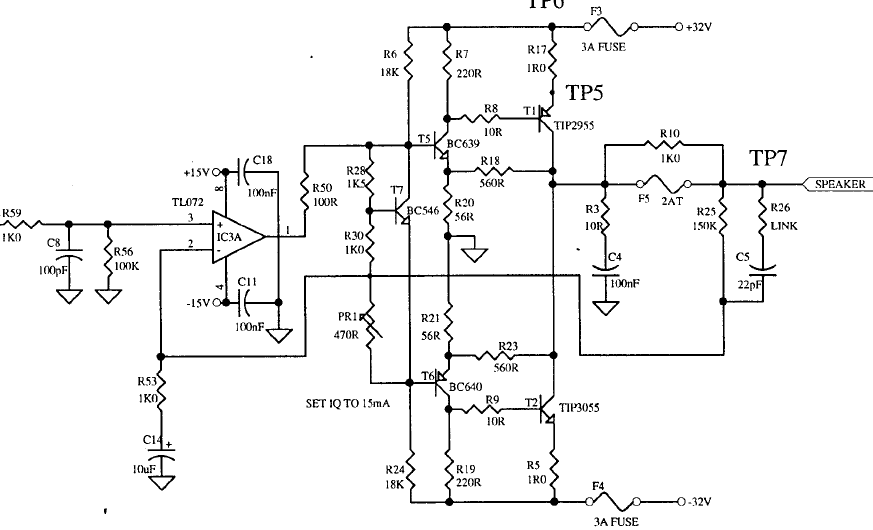

The CFP configuration is used with such transistors in Rod Elliott's simple P3a and a few other designs without many problems, provided a bit of shunt capacitance is added across the negative side driver's Collector/Base junction.
If you are bent on using fast output transistors in the amplifier, at least compare stability with an TIP3055/2955 pair in the same prototype. The 2SC5242/A1962 pair look to have similar specs to the ubiquitous 2SC5200/A1943 pair but in a TO3P package, like 2SC5200N/A1943N. I'm fairly sure that the extra Ft on offer is the likely cause of instability but let's see just how much.
Ian. I think my simple RC filter from op amp out to bias chain in is reliable. The current gain isn't a problem, nor really ft. If capaitance is added to the output devices one gets the current gain and a controlable Cob or whatever. I have also used BD139/140 TIP35/36 with good results.
To be honest this circuit is unstable even when all the original design features are fitted and slower devices. The op amp output RC filter of 100R + 33 nF is a good place to start. 10 nF with TIP35/36 seems about right. You must use a scope and a reactive load, I'm told simulations will do the same ( really ? ). I will look at Rod's P3, I think I remember it. I see no harm in adding a cog-npo capacitor to each output or driver.

This is the Brio amplifier. I am a little puzzled about the voltage dividers R18/R20 and R23/R21 which set output stage gain to 11 when ~2.5 would suffice for rail voltages of +/- 32V whilst ever the opamp is tied to +/-15V rails. Or have I missed something that should be obvious ?
