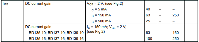

I found some BD139-10 and BD140-10 from on-semi on mouser. the higher hfe version is once again on order (shipping date january 2019, I'll pass). I always power up and do a first test with a dim bulb, I'll scope the output to look for oscillation. Some suggested to change the op amp for a ne5532, but you would stick with the original TL072 ?
TL072 would probably be best for it's lower output offset. TBH this topology of amplifier doesnt lend itself to low distortion, so i wouldnt bother upgrading the opamp...
I don't think its a good idea to use higher hFE range parts than specified in the Brio. Having watched a couple of boards burn as I was testing them, I can justify stability warnings. I would only use standard or -10 drivers, unless you like the chance of a heat and smoke finale with your music
We should also be careful how we interpret hFE measurements. The cheap Ebay parts testers seldom give results that relate to manufacturer specs, as their test current is about 2mA max. Results can therefore be anywhere, depending on the Hfe V Ic characteristic curve of the transistor. The table shows differences for BD139 at more realistic currents. BD140 is quite similar. As jaycee suggests, anything apart from heat dissipation that applies to BC639/640, will also apply to BD139/140.Philips - datasheet pdf
