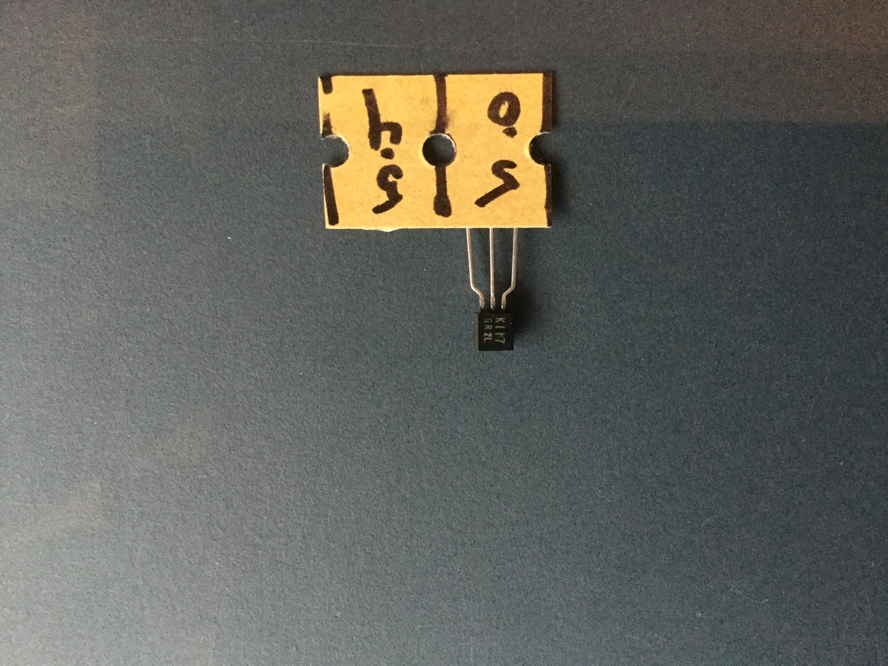

J1 is delivered in the complete package with something written on the tag. Am I right in assuming the writing is the IDSS value? So 5.0mA and 5.4mA in attached picture?

That’s my handwriting with a sharpie.
The idss values you mentioned are correct

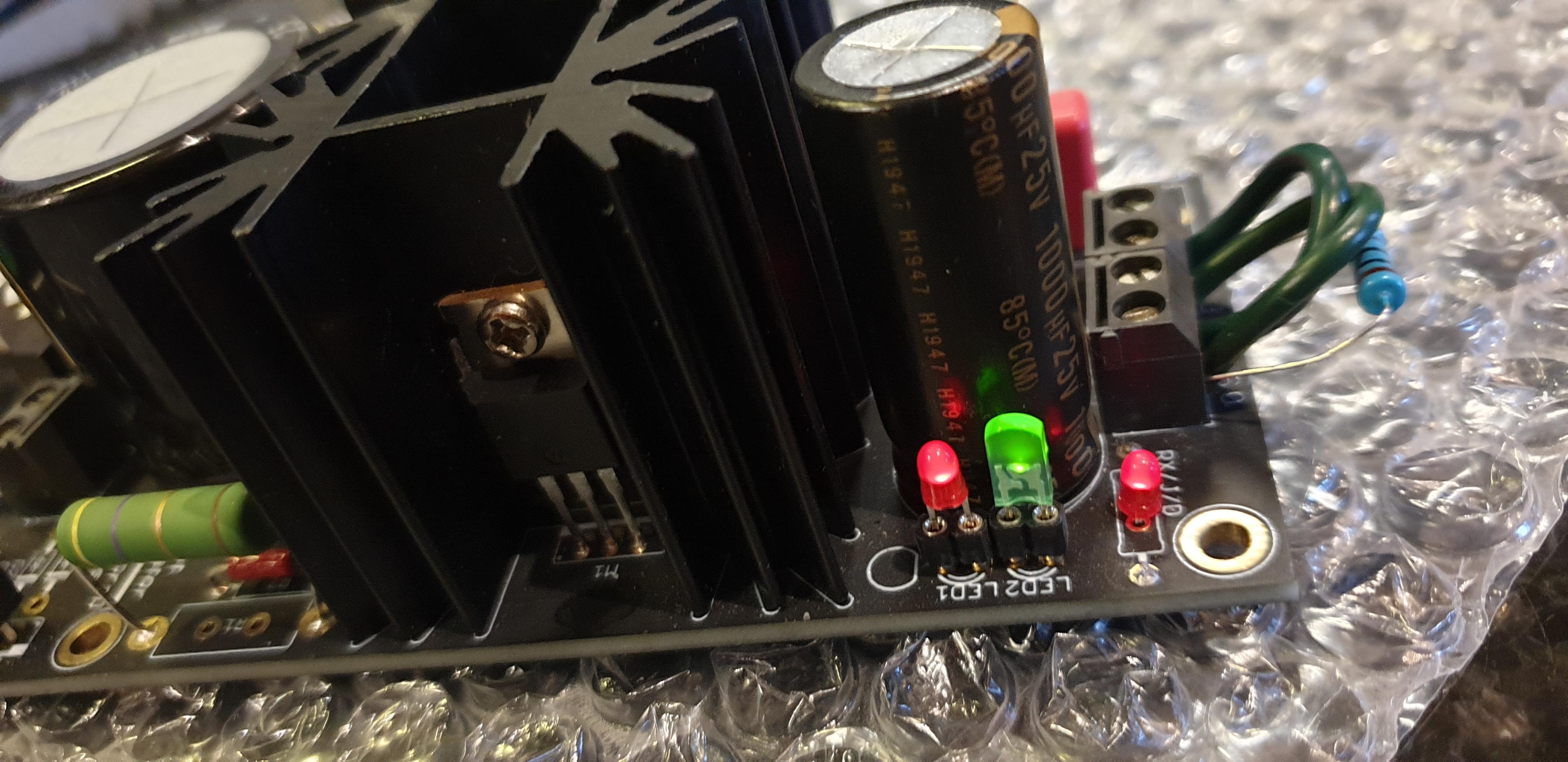

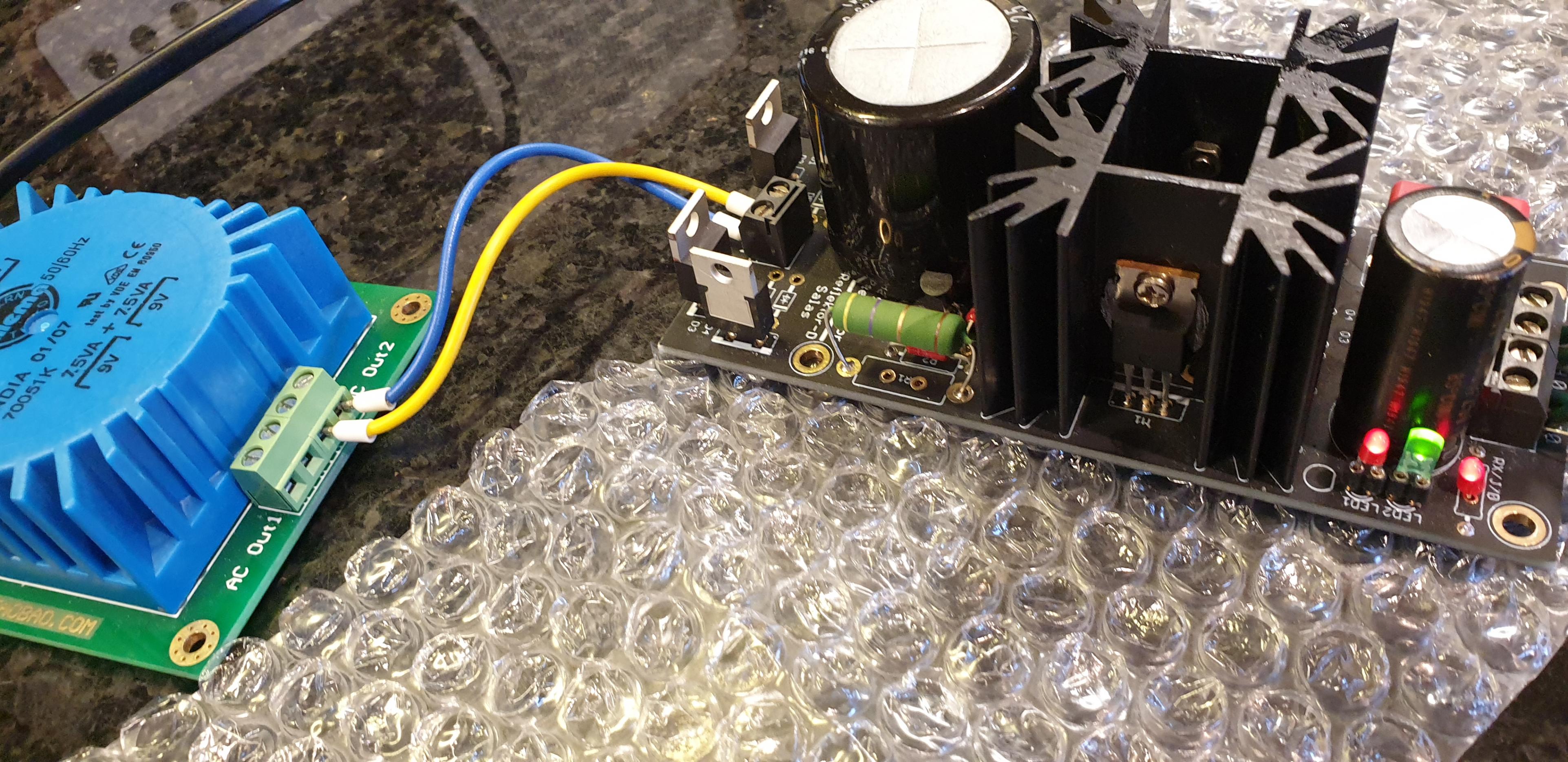

I have 4 more Ref D to build for different projects and here I build one for Andrea Mori clock TWTMC PPG. This requires 6v6 at 25ma.
So using 2 red and one green i have a perfect 6.62v after one hour.
Using R=V/I
6.6/0.025 = 264 gives me the value for the test resistor. Nearest I found was 270ohm and I thought 1 watt would be enough after having read this entire thread twice I hioes to have gained some knowledge!
I set the spare current to 100ma over the required 25ma with a 4r7 at R1.
With this set up I get steady and constant Vout and very manageable temps. Barely warm so maybe I shall up the CCS. Maybe lower R1 to 3 or 3.5r.
Input VAC from the 9v Talema is actually 11.2v so I have a nice headroom without too much dissipation. Also the trafonis only 7.5va and it seems to be running quiet and cool.
I say all this here to maybe help others learning how to set up this fabulous power supply. It is a pleasure to get it working to your chosen Vout!
