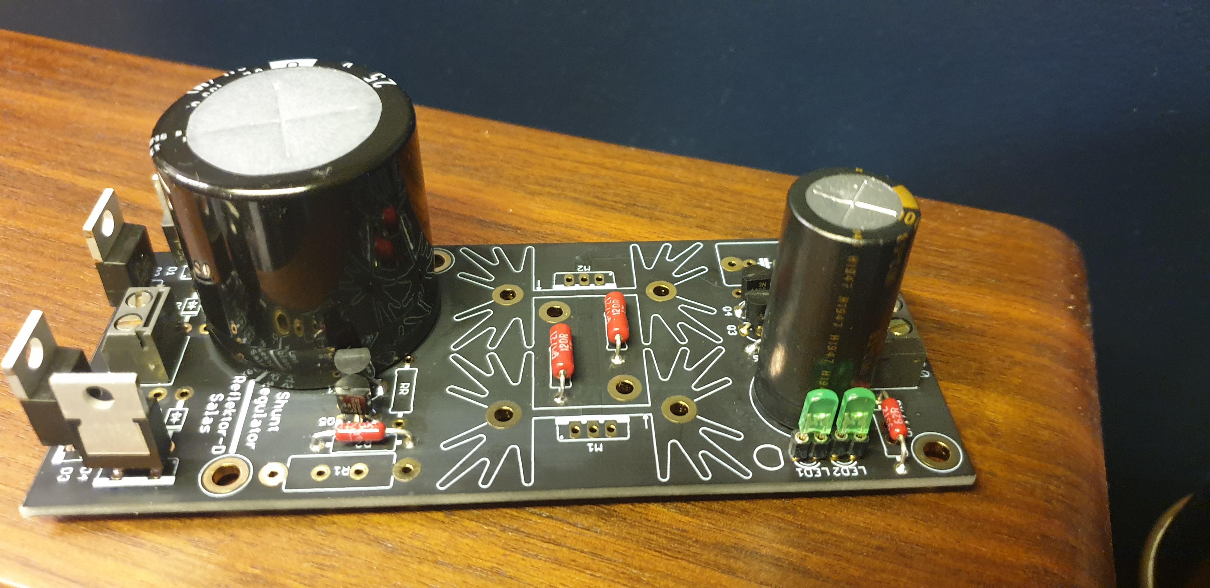

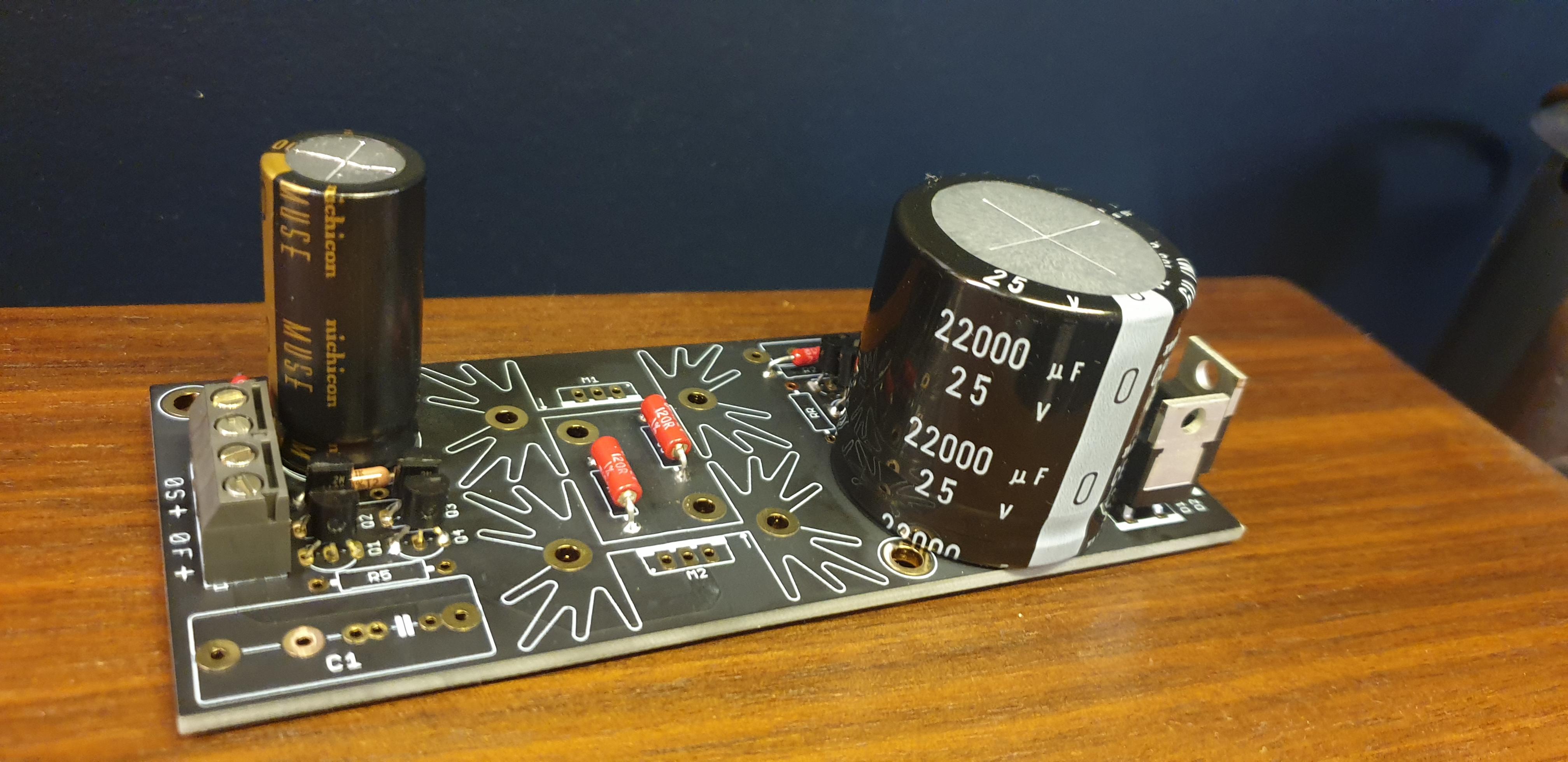

Started the build...aiming for 3v3 and 200 to 250ma for 2 stages of ES9038Q2M dac that consume maybe 150ma.. R1 yet to finalise.
So far have PRP metal films, LQA16T300 diodes, King right leds, Nicholson KZ C2, big Nichicon 20kuf in C1.
Enjoying the build. Always nice boards to solder the Salas/ Tea stuff!
Will 40mm tall sinks suffice.?
Will R62 for RR be OK with idss 5.9?
