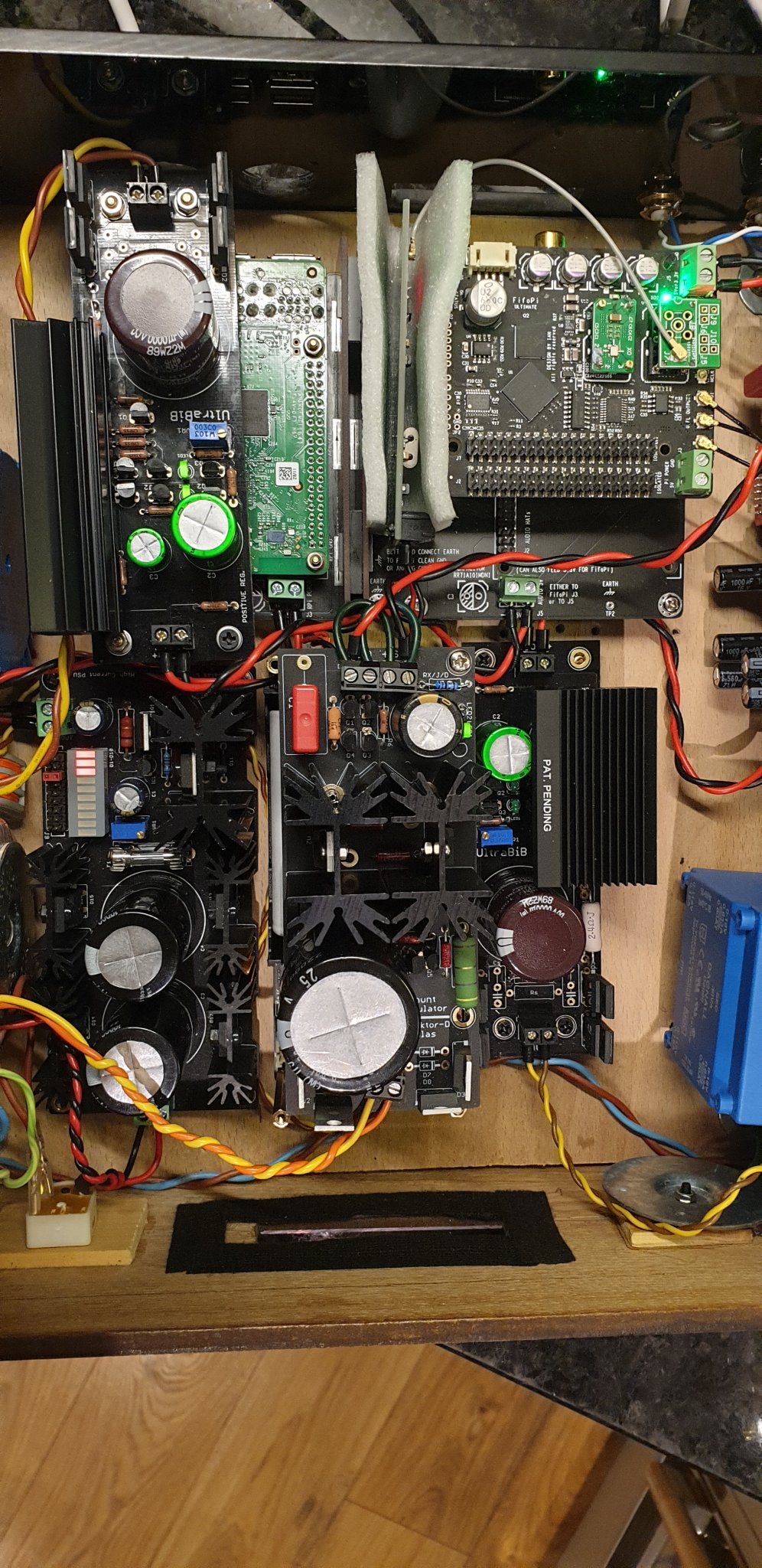

First check for continuity between the new voltage setting components. Then if the Led is alive. If all is good there, make sure the CCS works for correct R1 drop and it's set plenty for the new application. If not ok yet, test the rest of semis.
Thinking about this walking the dog this morning I think it is simply collapsing under load. I have a 10r and 8r in series for the test load and setting for 3v3 means a 183ma draw. I think there is maybe a 4r4 at R1 which can provide only about 130mA. It was previously set up for a small 50mA load. Hopefully a simple fix!
Yep, it most possibly current limited on excess load for its settings. For protecting a real rig in an over-current situation as it should.
Yes its perfectly fine....tested with 30ohm and it gave 3.28v and on the actual load of the Fifo clean side (one of the clocks has its own psu) it gives bang on 3v3.

Busy with Salas in here. L-Ad for Pi 5v, one Ubib for Fifo dirty side, one Ubib for the Abraxalito Phidac, Reflektor D for Fifo clean .

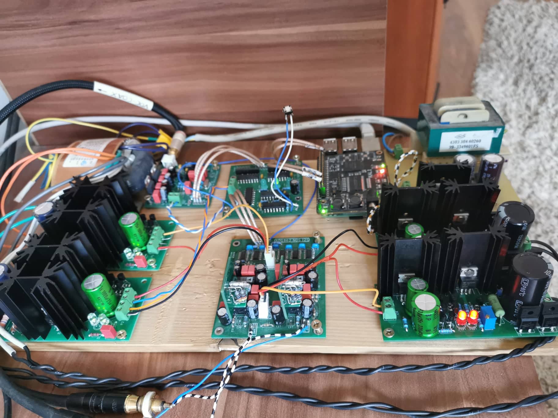

I use 2xUBIB 1.3 and 2x Reflektor-D in AD1862 DAC. It was faster that way on my pcb. After assembly, all shunts started without error. Reflektor-D drifted only 0.02 Volts after an hour of operation. Excellent design and excellent sound. They replaced LT series linear controllers.....forever. The deep range has been expanded but remains tight and precise. The high range is a bit more lively but not intrusive or offensive. In short, excellent work.
