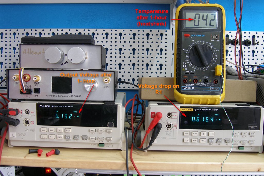

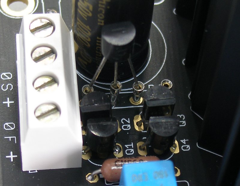

Here my effort!
The voltage was 5.018 with R6, that increased a bit with 2SK117 fet to 5.19 For this reason, I putted a series of pins at the position of R6, for easy acoustic estimated to my tests.
Two green leds are used.
The voltage drop on the R1 was 0.6164 that means almost 411mA total current (dac load). The R1 value was 1.5R (Caddock MP930).
The temperature at the opposite of M2 (sensor at the M2's heatshink, internal area of two heatshinks),was 42-43°C after 1 hour operation.

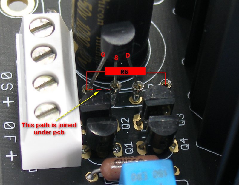

Very nice build and pics lemon, congratulations. How was the drift BTW? Stayed well put after warm up?
P.S.

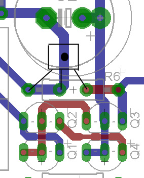

Lets refresh the readers on what you do there with the pins and the FET in the R6 position. You are trading better (lower) Zo for wee bit more noise and less than half the flat Zo bandwidth due to an active CCS part vs 1k resistor. And you will subjectively evaluate that for your DAC. Alternating between a low ppm resistor and a midrange idss 2SK117GR. Based on a suggestion for different evaluations I made in the Ref-D GB thread posts #68 & 71.
P.S.
Thanks Salas.
The drift, what is this?
I haven't any significant drift after warming period, sometimes changes the last 3rd digit by one!
If I measured at the cold start immediately, then this is 5.22 and after the "warming" it is stabilized to the 5.19
What I have doing here, is what I have read at the posts that you have note. I upload a capture for better understanding.
To my dac, seems the fet has a better acoustic sound.
At the position of R6 (1K) there are some female pins. The right position seems to my capture (G+S joined to the ground).
It is a easy way to try with R6 or fet between my listening tracks or to different dacs.

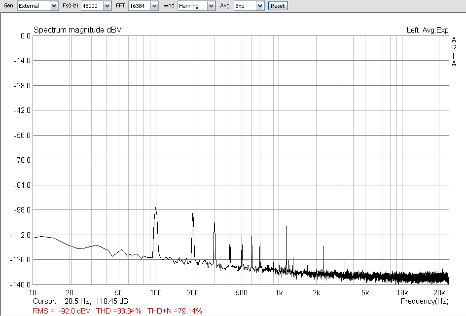

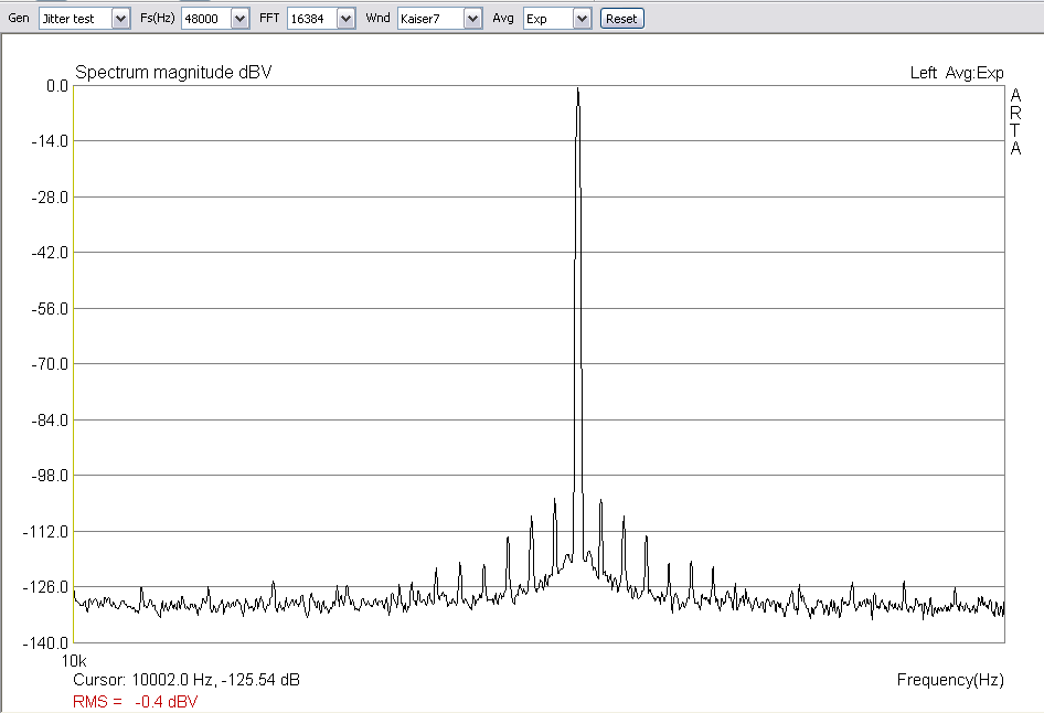

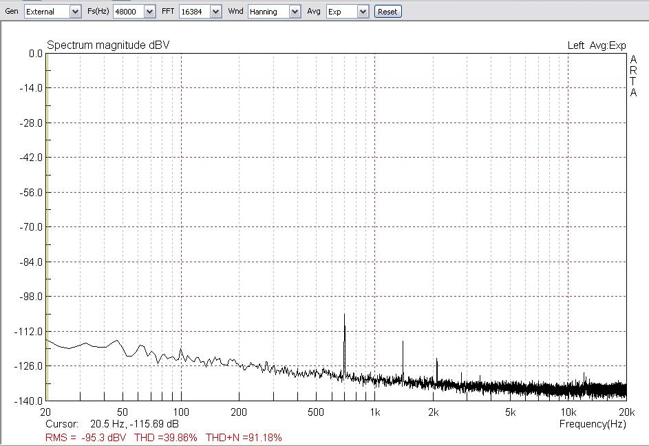

Do you believe that you will have better jitter if you change the initial psu of a dac?
Don't you?
Look at the following captures, carefully.
The role of digital generator held from the Altor JGEN-384, the role of signal capture held from the EMU-0404 (usb). The signal and the capture was 24/48KHz.
The test was done on 9023 based dac (through spdif), that including many local dc-dc converters. This dac including also an initial PSU on a SemiOn 7805 (smd) with almost total 2000uF capacitance before and after the MC7805.
Look as the noise floor as a jitter captures. There are some interferences around 100Hz and the harmonics of this frequency (Noise Floor Test).
Around the 12KHz base frequency, there are some sidebands frequencies due increased jitter (Jitter Test).
The things are changed with Reflektor-D initial PSU.
The noise floor is clean, except some peaks due dac design (probably) and the jitter sidebands have gone!
Wonderfull results from a wonderfull PSU.

Very interesting captures Lemon. Are those local dc-dc chips in the various DAC subsystems, linear regulator SMD chips?
Yes Salas.
Two Texas Instruments TPS7A4901DGNR (12.7μVrms, 20-20KHz) UltraLowNoise Linear Regulators for Wolfson receiver, clocks and Sabre 9023 and an ON-Semi NCV551SN50T1G for multiplexer.

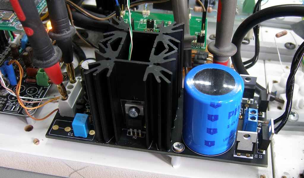

Just got my two Reflektor supplies working on the bench with the test resistor load included with the kits. Both worked first time, with no assembly problems.
Two green leds for 5.1V
Two green leds and a 56R resistor for 5.22V
Nominal 9V transformer.
Both seem to be rock steady.
Just need to finish the rest of the DAC now!
