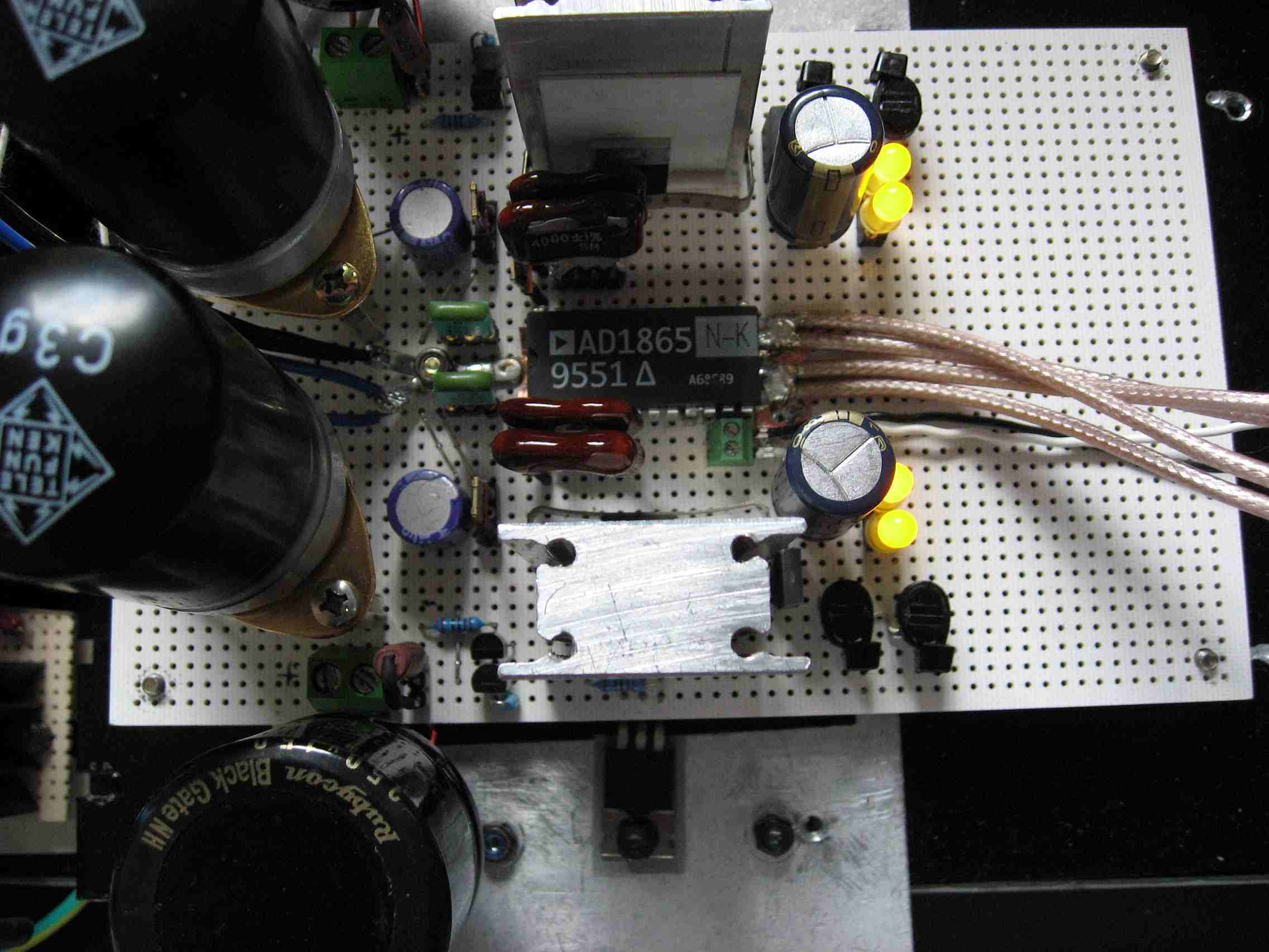

I have compared on my AD1865 DAC. Reflektor D is clearly better than BiB for +/- 5V analog supply in my option. Salas thank you for so nice regulator 🙂

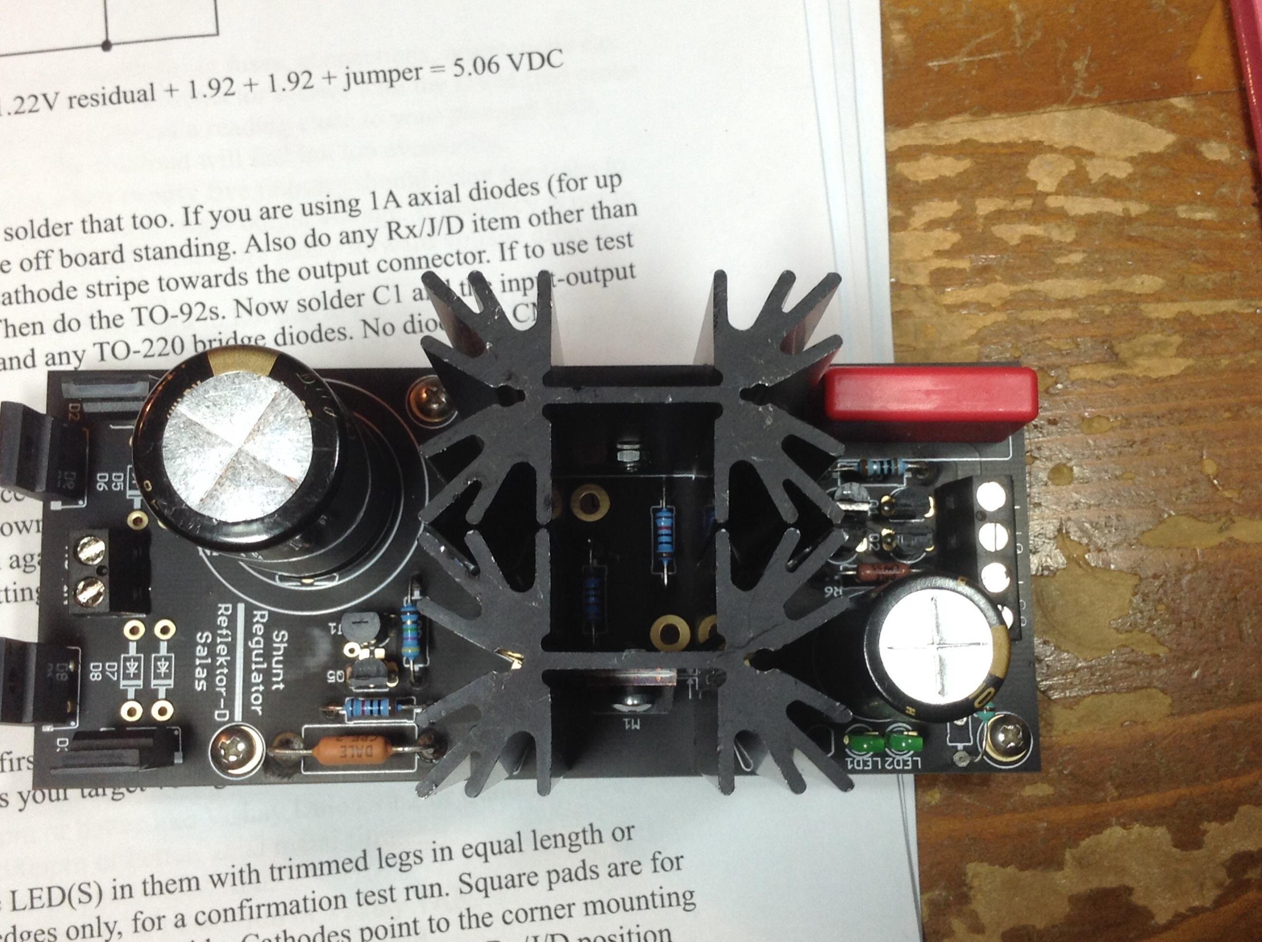

Reflector D LEDS won't fire up
Help! Checked all part values but LEDs won't fire up. As far as I know the LEDs are in the right position, according to the manual. Have taken some pics, perhaps someone has an idea? Thanks! :lifesavr
