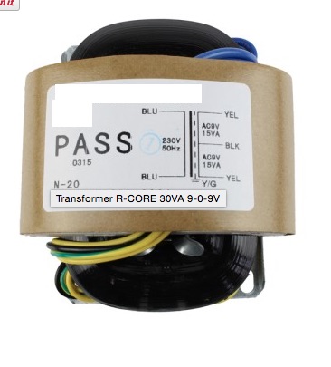

I have more more question regarding the power on the buffalo III with the reflektor
Does a power transformer like this one 30VA 9V/0V/9V would work ?
meaning having the buffalo III powered by a reflector D with 9V 15VA is enough ?
the buffalo draw about 440 ma i think....
i would power one one side the buffalo and on the other the SDTRANS...
thanks for the advice !!
