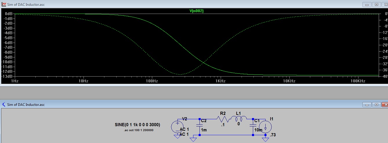

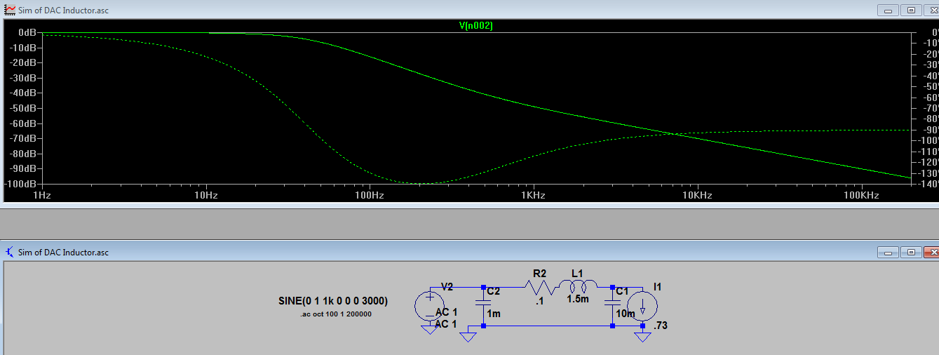

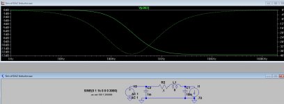

LTSpice shows that adding a small choke (1.5mH, 518mohm DCR) before the 10mF cap does improve the filtering a lot, especially at higher frequencies. Sim #1 is without choke (L=0), sim #2 is with choke. Output looks stable with no peaking as long as the choke value is kept below ~1.8mH. The choke ought to help with limiting the inrush current as well.
Digkey has these little ferrite core chokes for less than $5. 1.5mH, 2A.
1130-152K-RC Bourns Inc. | M8371-ND | DigiKey
Can't hurt to try it out.

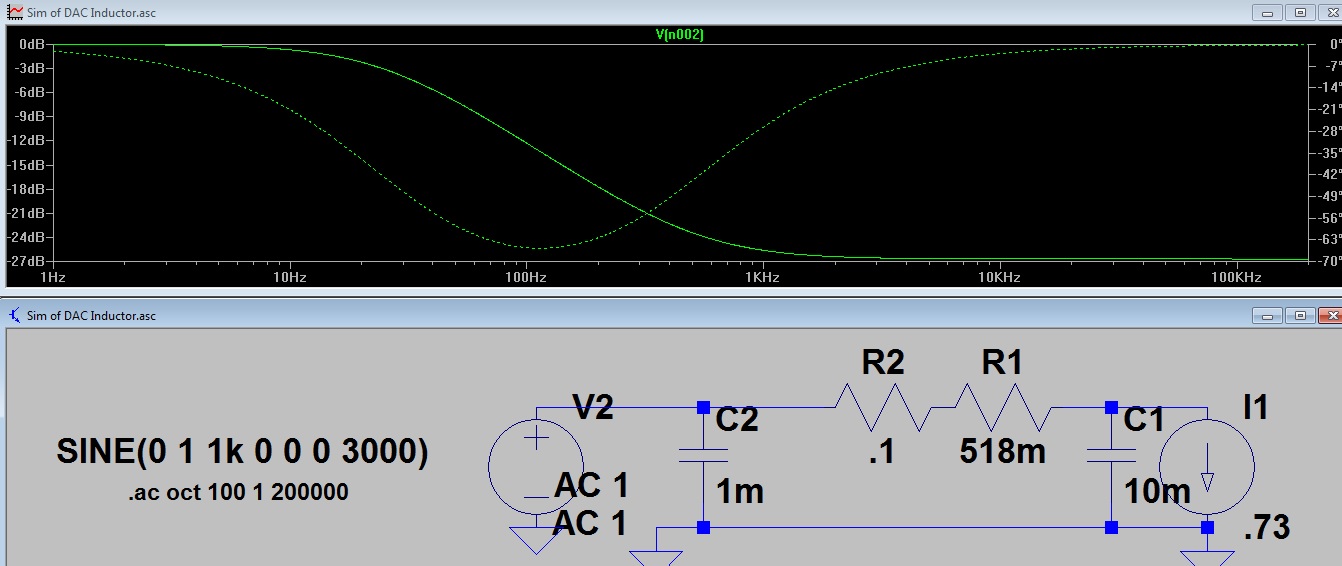

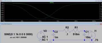

Try the same thing with a simple 0.5R resistor instead of the choke - it'll be interesting to see the difference.
Your wish is my command. An improvement with a .518R resistor but nowhere near the performance of the choke.
