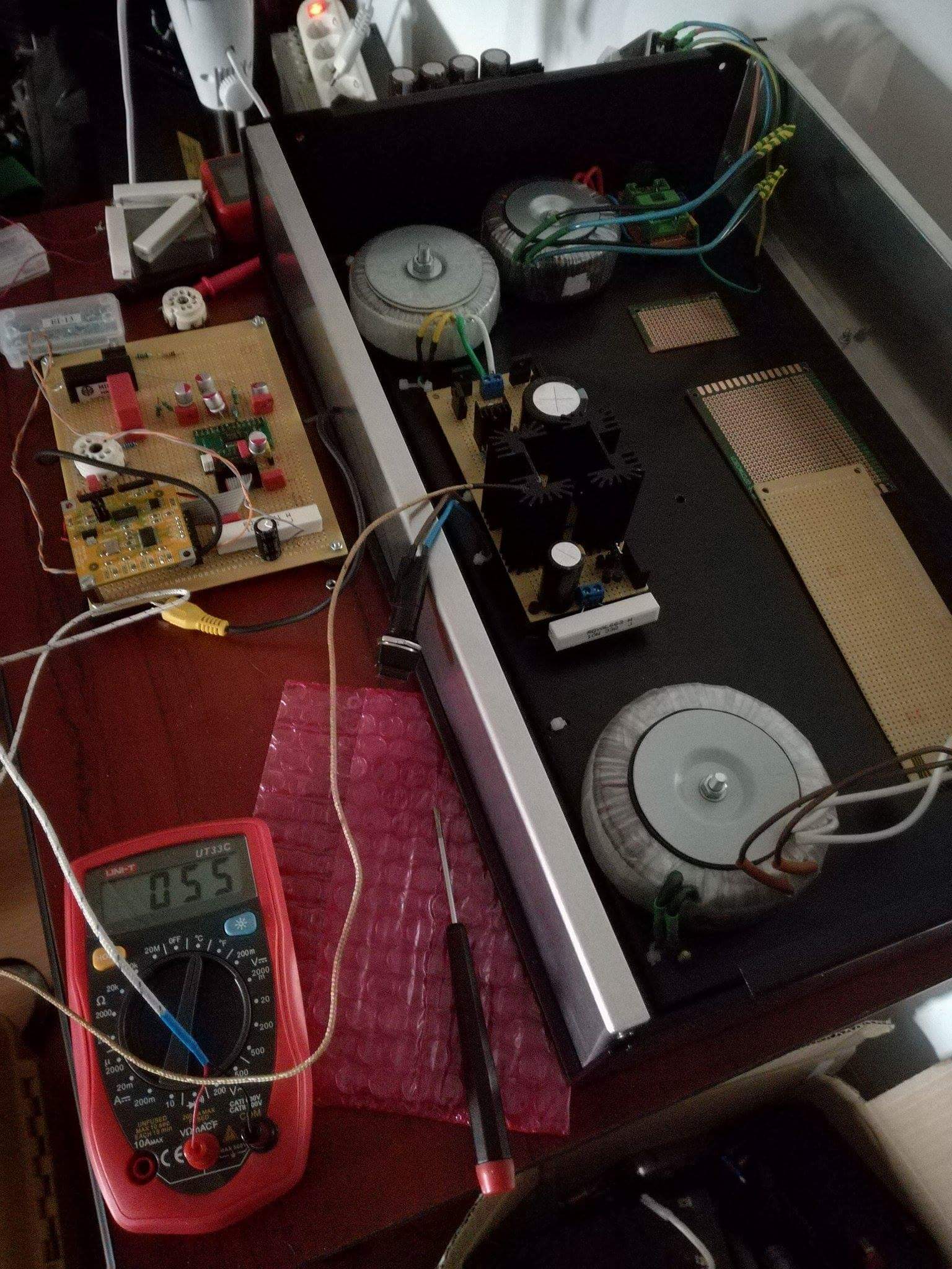

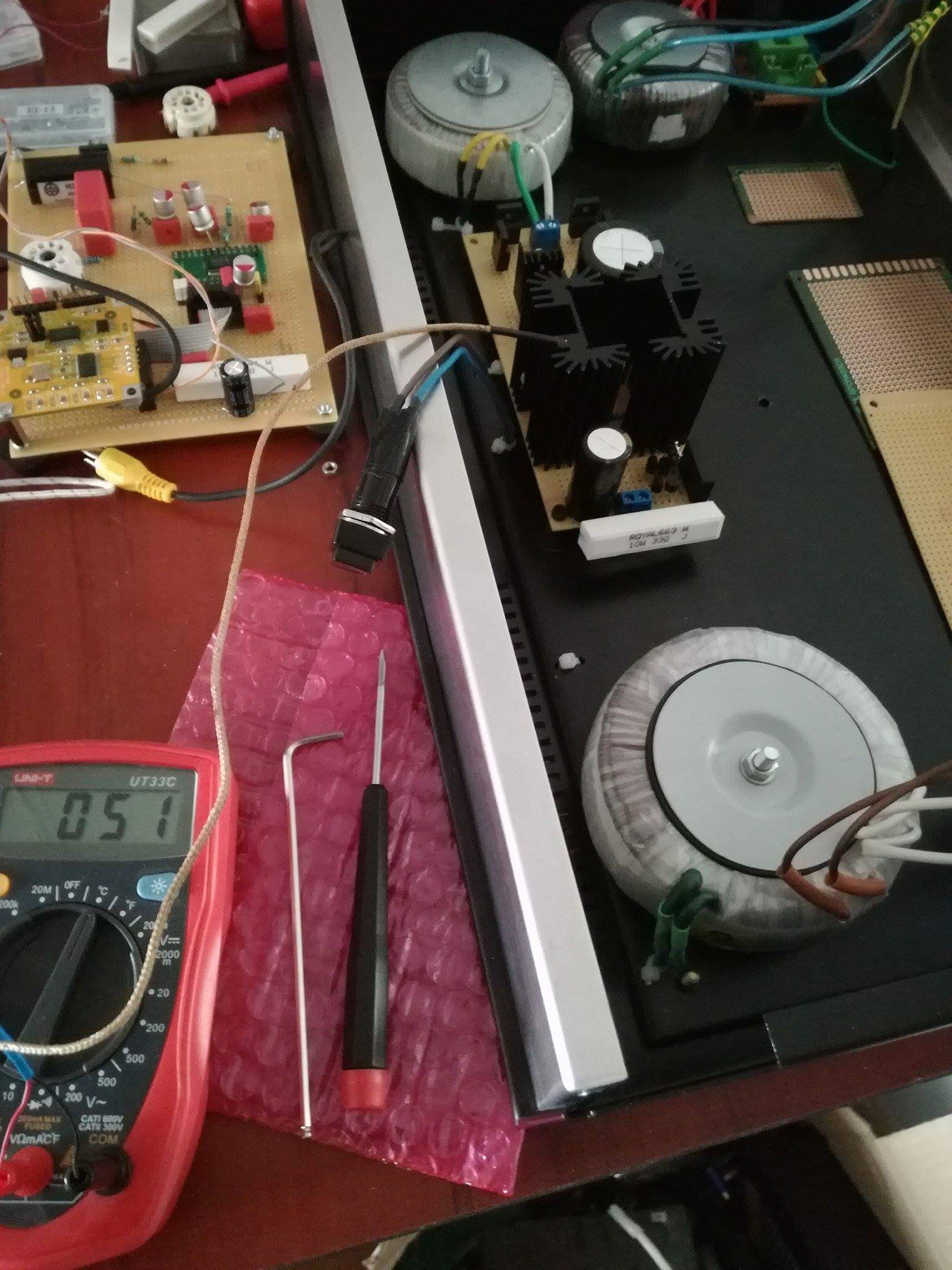

I have done measurements using both methods, and the difference is only ~3-4 degree. I am missing something or it is normal?

I fixed the issue, and proceed to test the Mundorf 4 pin. And I get rewarding to my efforts, I tested diodes position back and forth several times, to prevent mistake, and I can stand now, it's a nice upgrade placing diodes from OUT+ to OUT-, over last try, between IN+ and IN-.
I don't feel in need for bypass to such a kind of capacitor. My god!

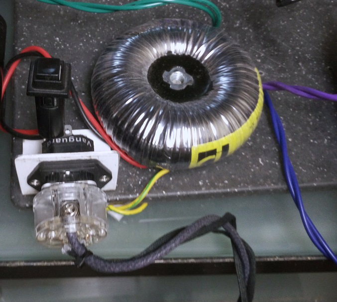

I placed a new pic now, it's my power transformer set up still on the developing board. It may have some interest here:
**** O-Core type transformer, with three secondaries for three Ref-Ds. Is step further over R-Core transformer. I found them very easy to find correct fase polarity by ear. I must mention, is a must also to check correct phase ALSO for SECONDARIES on power transformer, these are independent from PRIMARIES. So please set in phase BOTH, no matter the order. I bought mine on Taobao. Other than that it is aslo Ebay seller: http://www.ebay.com/itm/4N-OFC-O-co...356897?hash=item1ea3b1cae1:g:~vkAAOSwu4BV6T-N

**** Instead of a fuse, I use a copper circuit breaker 'ETA' brand, which is also an ON-OFF switch.
**** Sockets and plugs are copper, rhodium plated.
**** Power cable is hand made, Graphene wire isolated with cotton. I glad to share here my extensive research , best quality graphene by my test, come from this manufacturer ???|2D Materials|??????????, There are different thickness from 0,3 to 10mm., I tried all of them, and preferred by a wide margin is 0,6 mm. (around 20USD /metre).
