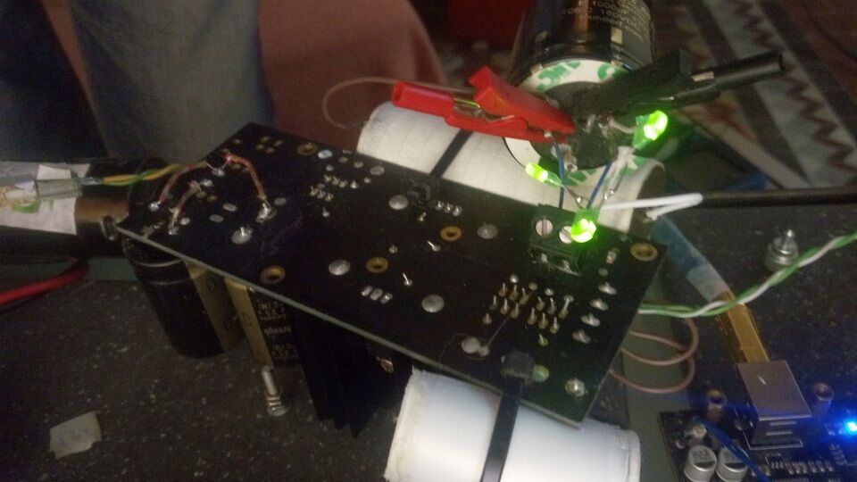

Here is the drawing for correct wiring:

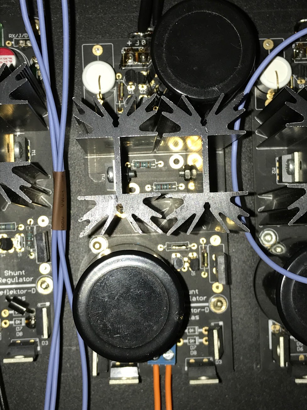

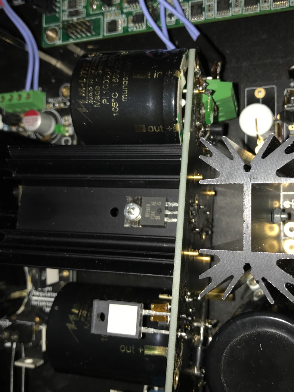

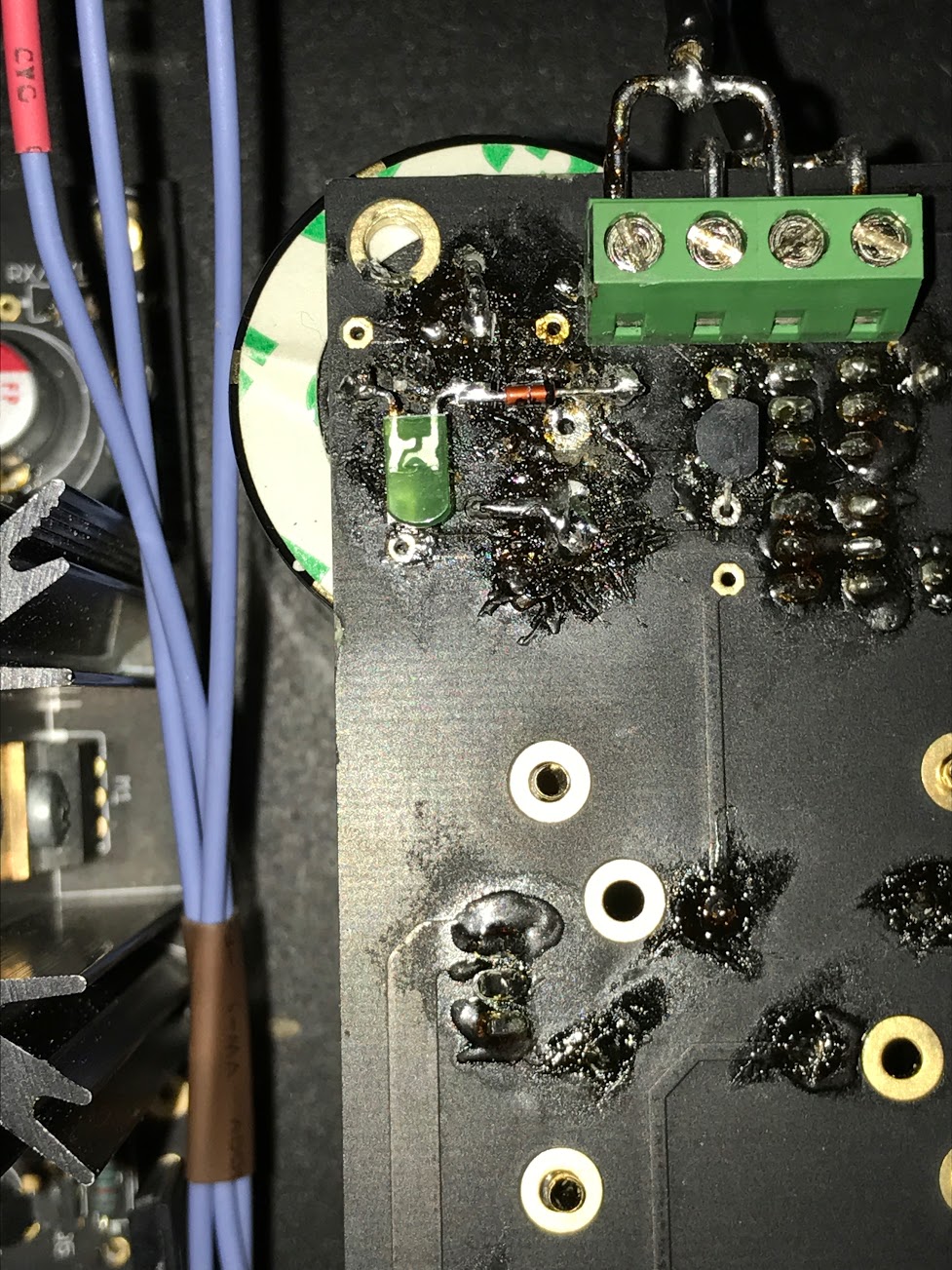

I possibly can post pics from my build if needed.
Please do post your build, mine is on test stage only, I wired it as in your drawing, leds going from IN+ to OUT-.

@TioFrancotirador what capacitor did you used for C1?
It would be any benefit to use a larger Mundorf for CM, like 15000uF or 22000uF?

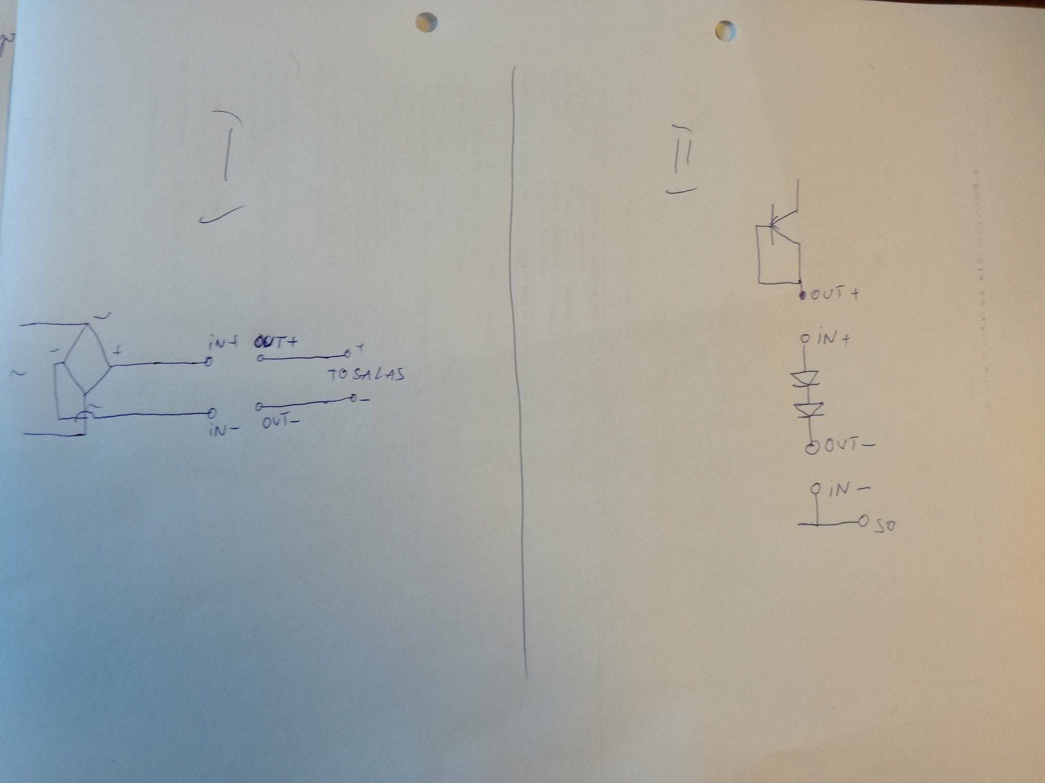

Could you guys please confirm the schematic attached is right for connecting the Mundorfs?

There you go. Salas Ref D Mundorf 4 pin of Vref.

Schemantic seems right, isn't?
The draw nr. I is 100% correct as I found the same wiring in other places as well, but in the drawing nr. II, my logic say that out - and in - should be swaped 😕
